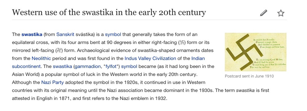

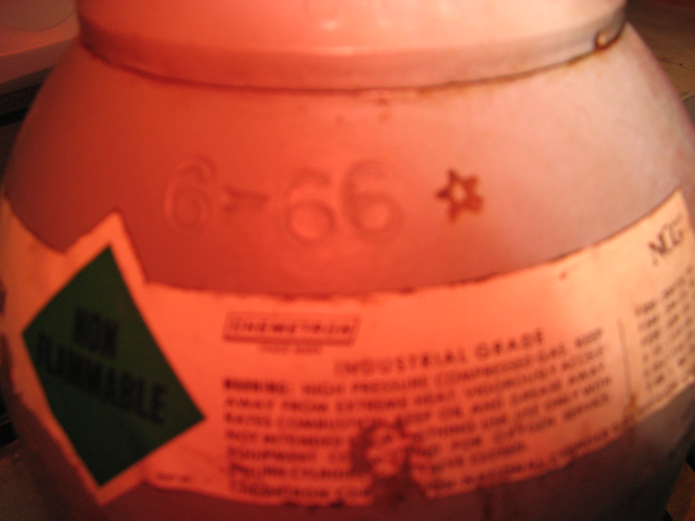

I've seen these discussions before and some cylinders have the markings before Germany adopted it.
As a result, tanks may, or may not, have the mark associated with **** Germany depending on the tank date and country of origin.
In some cultures, the mark was a symbol of good luck.
Anyone have a good knowledge background of history?
(Some info in the pic I attached)

What is not clear to me, are all the ******** stampings originating in **** Germany or were they used as the "good luck" symbol that so many thousands of examples were are are still on many buildings and things.
Take a look at this link
Western use of the ******** in the early 20th century - Wikipedia, the free encyclopedia
I have only seen a few ******** stamped tanks, and they were all during the **** era 1932-1945, but that don't mean much. There are also supposed to be some "windowpane" overstamps to get rid of the ********, but I don't know if that is just a rumor or what. Of course Linde was and is a prominent German company. I even had an old propane tank with a ******** at one time

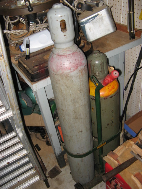

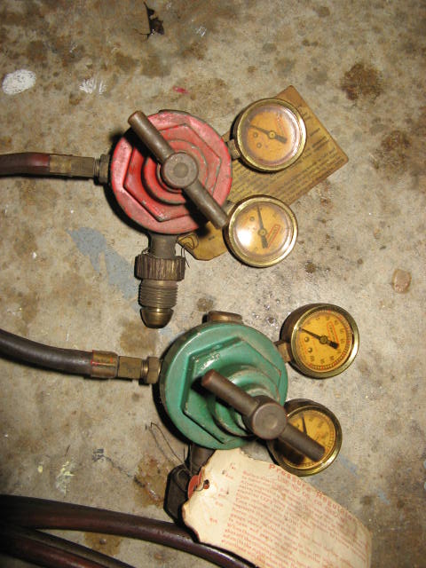

My father-in-law passed away about 4 years ago. He had in his garage an oxy/acet. torch set-up that he had not used for probably 10 years prior to his passing. He owned the tanks outright. It is all still sitting there.
How safe is it to have this stuff laying around, considering how long it has been sitting?
The hoses are probably rotten but with new hoses would it be safe to use the rig? Should the regulators be checked? I do not know the brand but the F.I.L was a machinest and only used good tools, so i am sure it was a quality set.
I am sure a refill would require a recertification- would it even be worth it? If it's not worth trying to revive this stuff, how does one dispose of it?
Well, nothing happens quickly at my in-law's house. As of an hour ago, the equipment mentioned in the above post is in my possession.
This is what I hauled home:
A pair of tanks(Oxy/acet) and a little dolly for them.

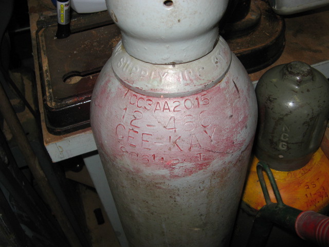

As I said in the original post, my deceased father-in-law owned these tank outright. My sister in law has talked to people at the place where the tanks were purchased (Cee Kay Supply) and was told there is a record in their computer confirming this purchase.

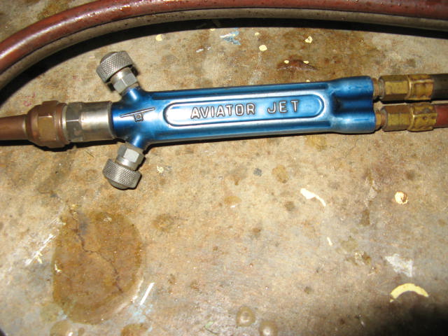

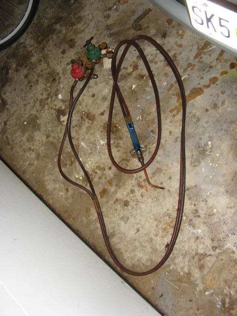

This is the torch. If it is not in the photo, I did not get it:
I am sure the cutting head and probably some more tips are somewhere in that mess of a garage at my inlaws but I am not going to go looking for them. Already had one "blow-up" today when the wife and I went to pick this stuff up. The mother-in-law was worried about these gas bottles laying in the garage for the past 30 years or so and wanted them gone, the welding supply place that the bottles were purchased from agreed to take them back (for free, and would not pick them up) and that is how I got involved. But there are two sisters in law, both in the mid 50's, there (niether able to support themselves) and one of them is a royal pain to deal with. Thinks I am trying to steal their stuff. They asked me to help get rid of the tanks- I have known about the tanks for 25 years and never said a word about them. So I am not going back to look for missing pieces.
Anyway, while the torch was a really good torch in it's day, it is long out of production, there are no tips available (other than an adapter to use tips from another torch), the regulators are old Craftsmen that probably need work (someone had been using a pipe wrench on the acet. regulator- hard to believe that my father in law would have done that) and the hoses are probably too old to safely use. Probably not worth putting money into the stuff

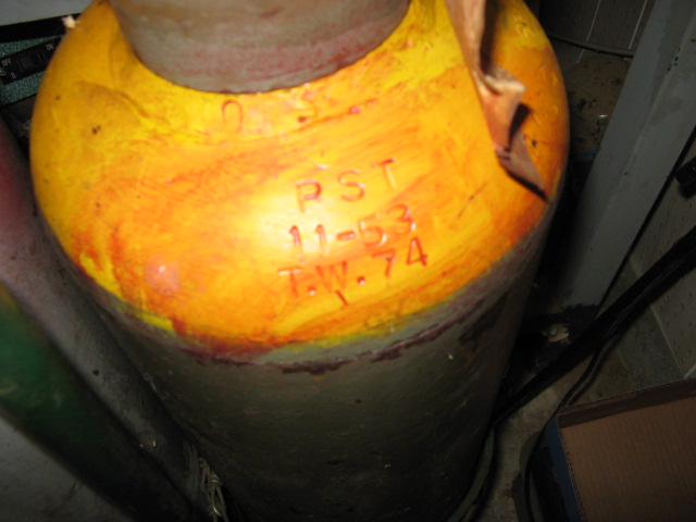

If I can get ownership of the tanks transferred into my name, so I can refill or exchange them, that is what i would like to do. Will probably have to pay a hydro test fee, which i don't mind doing.
If i can't make arangements to refill/exchange the tanks, then i will use what gas is remaining (don't know at the moment) then sell the tanks for whatever i can get for them on Craigslist, and do something else.
For a torch, I will probably pick up a new one at Chinese Freight.
Will probably see if i can sell the Aviator Jet torch body for a few bucks- I hear that some guys who work with sheet metal like them.

I bought some tanks off Craigslist that I knew the test date had expired. I took them (2 O2 and 1 Acetylene) to my local welding supply where they charged me a nominal fee (I think $25 per O2 bottle) to test them. Acetylene wasn't needed to be tested.
They recorded the serial numbers, set me up with an account and now I just swap them out when I get an empty. Never get the same bottles back.
