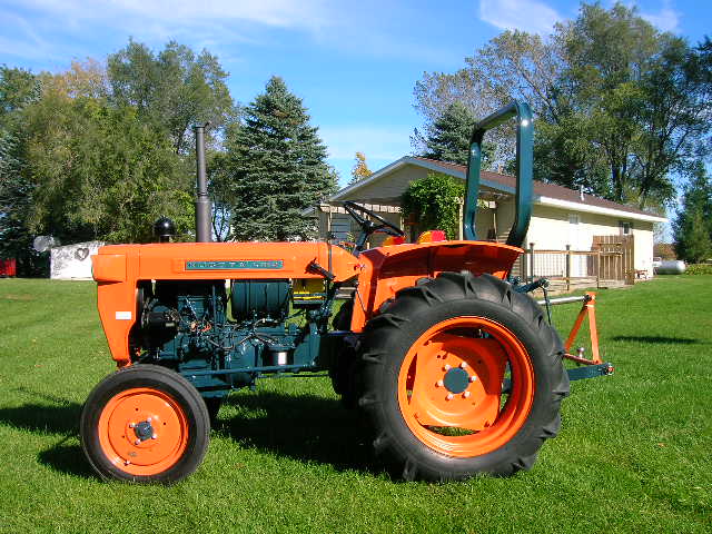

Glad to see I'm not the only one. It's hard to find others that are restoring Kubota's. I restored a 1973 L210 a few years ago now. I pulled off all the tins/seat/rims and tires/radiator/steering wheel/etc. Once you get all of that off the chassis, there isn't much left that isn't Kubota blue. What wasn't blue, such as the starter/generator/fan/etc. I painted with spray cans.
I did not want to sand blast the chassis since the sand gets into everything. So I spent weeks with degreasers, soap and water. At the end I was down to tooth brushes and dental pics. After that I wiped the entire chassis down with alcohol. Then everything I didn't want blue, I masked or covered with clothes or rags. Even the hoses and wires. A trick the painter gave me was to cover the hoses and wires with tin foil, not tape. Tape is impossible to remove. The tin foil is very easy to remove. Once it was ready we wheeled it into the spray booth and put it up on jack stands and pulled the wheels and tires. The next time I saw it, it was Kubota blue. It came out better then expected. The tins I did have sand blasted/primed and painted.
I was also surprised at how many of the part are still available from Kubota. Very few parts I needed where not available. Right down to the decal kit. If you have trouble finding the Kubota part numbers for the correct color of paint, I'm sure I can help you. I look forward to following your progress.
