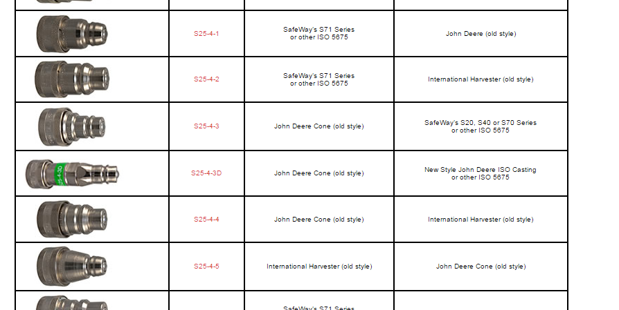

I'be got a JD 1020 that I use as my rake tractor. I just bought a 10 wheel rake and got rid of the side delivery rake. But my hyd remote is the old JD style. My rake (and my other tractors) have ISO. So I'm looking for just a conversion to plug into the JD to convert, without rebuilding it. Thoughts on this? I see that they list this one on Amazon, but it says old international style. Is that the same as ISO? Any recommendations?

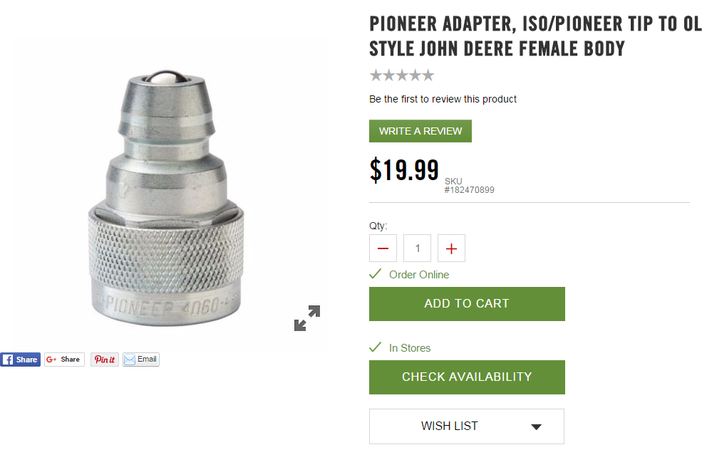

Yes that will work . Actually it is Pioneer to JD , same thing . I think there should be an o-ring on the female end also .
/ Old JD hyd coupling #3

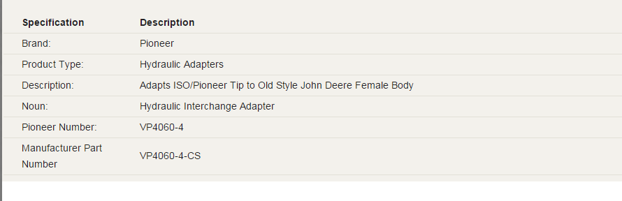

The IHC won't work. You need this one in photo from TSC Old style JD to ISO.

Well I'm gonna have to see if they have it in stock at TSC. Thats cheaper than the ones I found online

Did I miss something or did I say Pioneer to JD cone ?

No offense intended but if I'm reading the spec's correct and I fairly confident I am the Safeway S25-4-1 is the correct fitting to accept the ISO male tip BUT the S25-4-5 is made to accept the larger male IHC tip similar to the male end on S25-4-4. That's how I remember them when I sold them in JD parts dept.

No problem I just didn't want OP buying wrong adapter.

They had the international ones in stock at TSC, and I could tell that it was not the right one. But like always, they only had 1 in stock of the correct one. So I got them to order me 2 of them. But it will take 2-3 weeks to come in

Yepper and they make them forwards and backwards as I had to have male JDs with female ISOs and and Male ISOs with female JDs depending on the tractor and implement. $35 sticks in my mind, don't remember if that's a pair or each.
