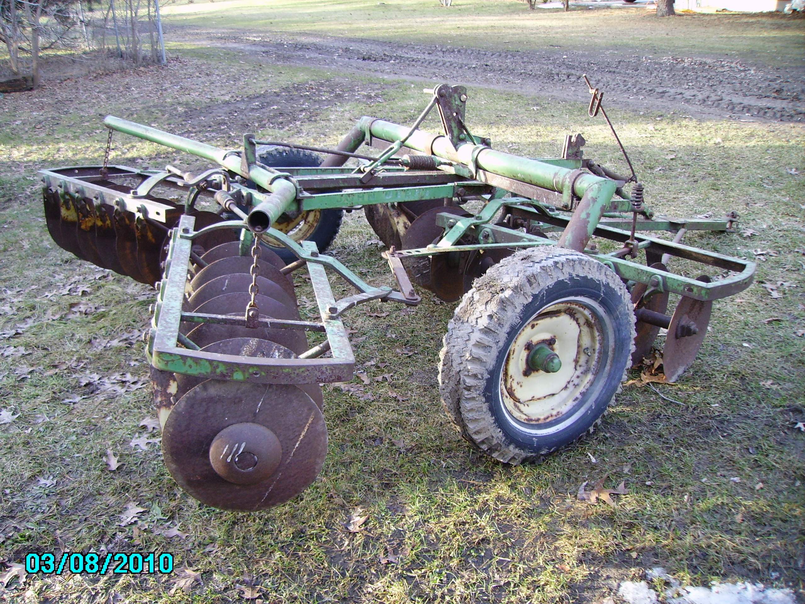

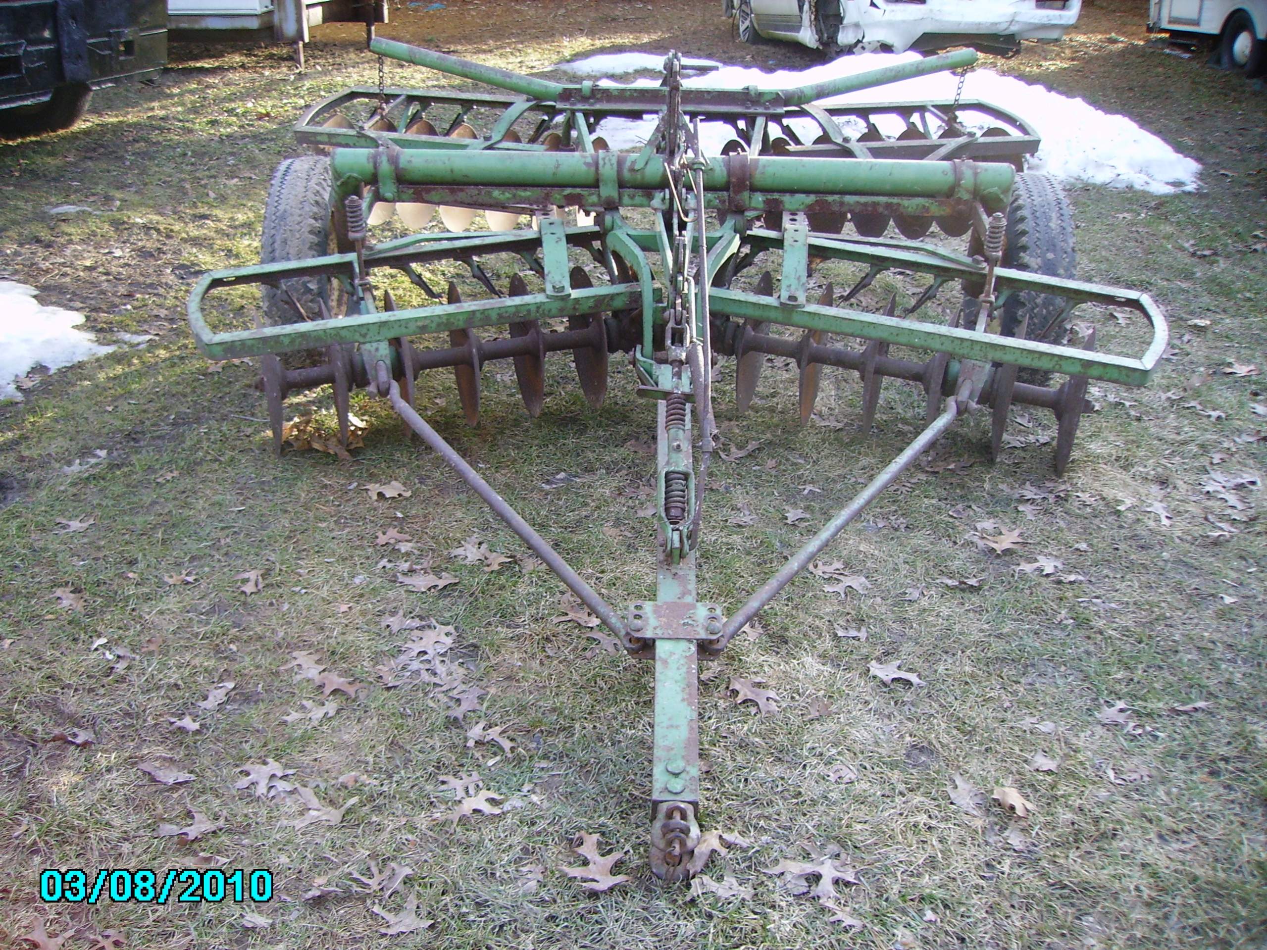

Hi Jim Thanks for the input. I was already thinking what you were saying and I already removed the Cylinder from the disc so I can drain the old fluid out. I had already found some cracking in the rubber on the hydraulic lines so I know I will be replacing those as well. Got a couple pictures loaded too. I already have the cyl removed in the photos.

C-Saw,
Thanks for pics. Looks like you have same disk. I was impressed that you also have the original pin in the toung for hooking up to the bar. they are rare to find now. :)
Yea, I hated loosing the cylinder. I believe it to be origination also, or at least of the period.
Jimgerkin makes good point about treatment for any old cylinder that has not been in use recently. I had done all as he suggests, and still lost the cylinder. I believe it just to be newer tractor higher pressure, or perhaps bad casting. I replaced the JD with one I had around and it works well, but I appreciate authentic , know what I mean?
