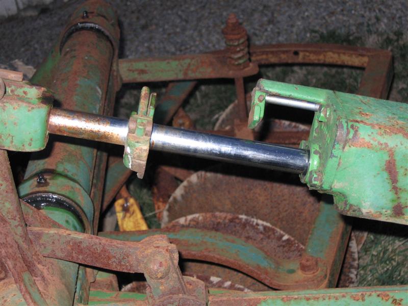

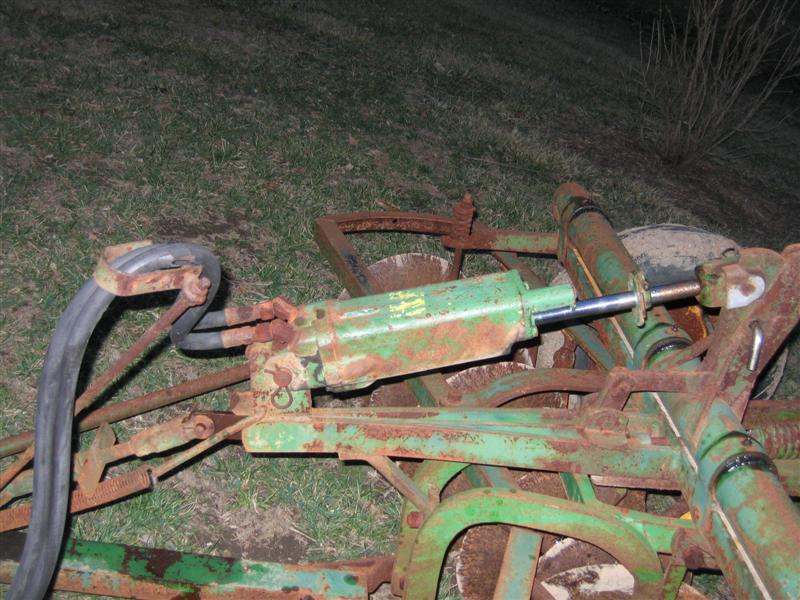

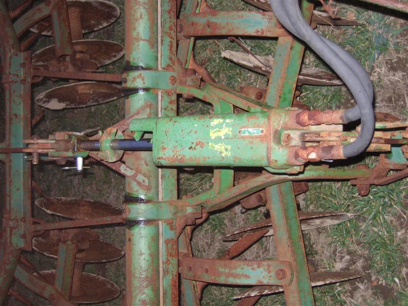

Egon, I have posted pics of both sides of the cylinder, hope there useful. Perhaps you can tell me what the small valve at the top in pict 3 is used for?

[now question is what is the little rod at the top of the cylinder that the flat disk will push against? See pict. 2 Is this some kind of bypass for limiting the travel?/QUOTE]
I think you may have it figured out.:D
