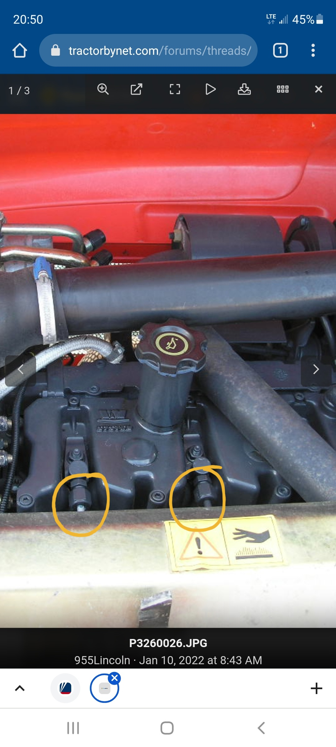

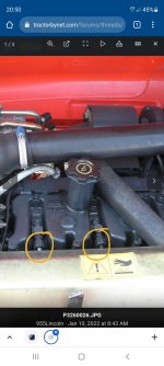

I think one of the hex screws on top of the filter is to bleed fuel to that point. Are you getting fuel there?

I went to the property for another reason and I was a bit rushed. Just wanted to run the tractor engine while I was doing other things. I agree, it does look like a bleeder and one of the first things I will do when I make it back up there. I also have a full maintenance manual that I can't get my hands on at the moment.

   / Old Fuel in Diesel Tractor #17
You don't need a special funnel.
General diesel troubleshooting steps are what should be done now. Anything else is a waste of time and money.
Get a new fuel filter if you haven't. Drain the tank at the lowest point, probably going into the filter. With the hose off, pour some fresh diesel into tank and flush any crud out until you have clean fuel. Then replace filter and try priming.
You may need to crack each injector feed line to get the air out. Google how to do that. Only back off the nut a 1/4 turn or so. The idea is to get all trapped air out of the lines and through the injection pump up to the injectors. There will be bubbly diesel and then solid stream. It might help to have a second person to bump the starter for this, depending on layout.
