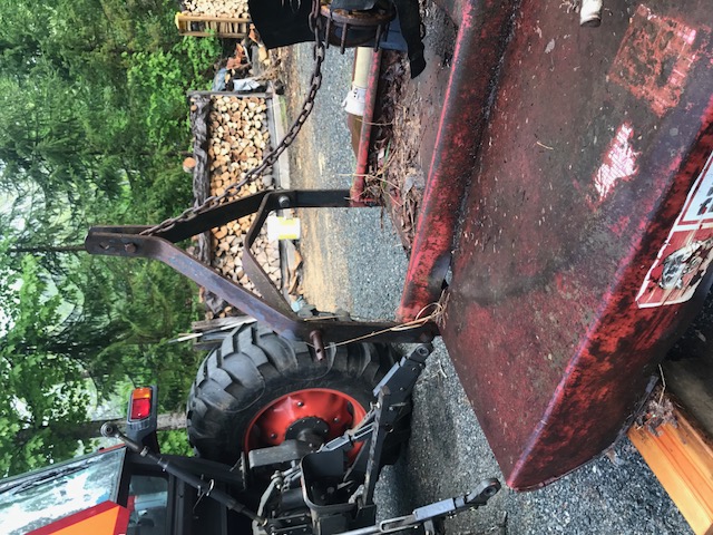

I'm restoring an old Bush Hog a neighbor farmer gave me. The 3 Pt hitch seems very high. Even with the lift arms all the way up, it barely lifts the tail wheel off the ground. My lift arms are in the lower hole, so I know I can use the upper hole, which might give me a few more inches of lift, but does this situation seem normal? The lower pins on the Hog are 20" above the ground; My Alamo Flail mower, when down has them at almost half that (12").
The farmer used this with his Case tractor which is smaller than my Kubota; I thought the height of 3 Pt Hitches was standard, although it seems that Cat II and III are higher.
Any ideas?

Is your top link adjusted right when the bush hog is down? Shortening the top link would raise the rear wheel.

Looks OEM to me. Try the other holes in your liftarms and indeed shorten the toplink

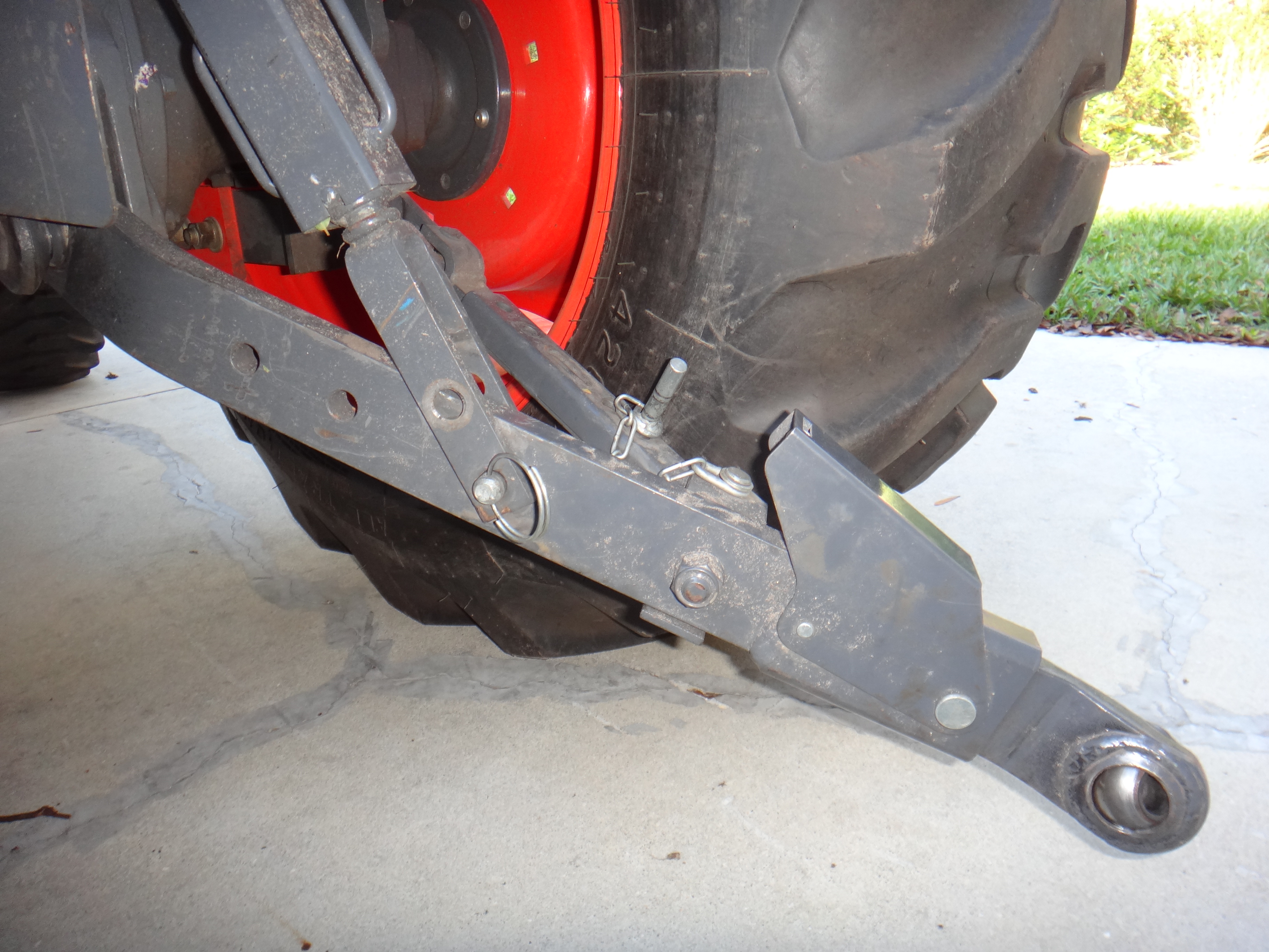

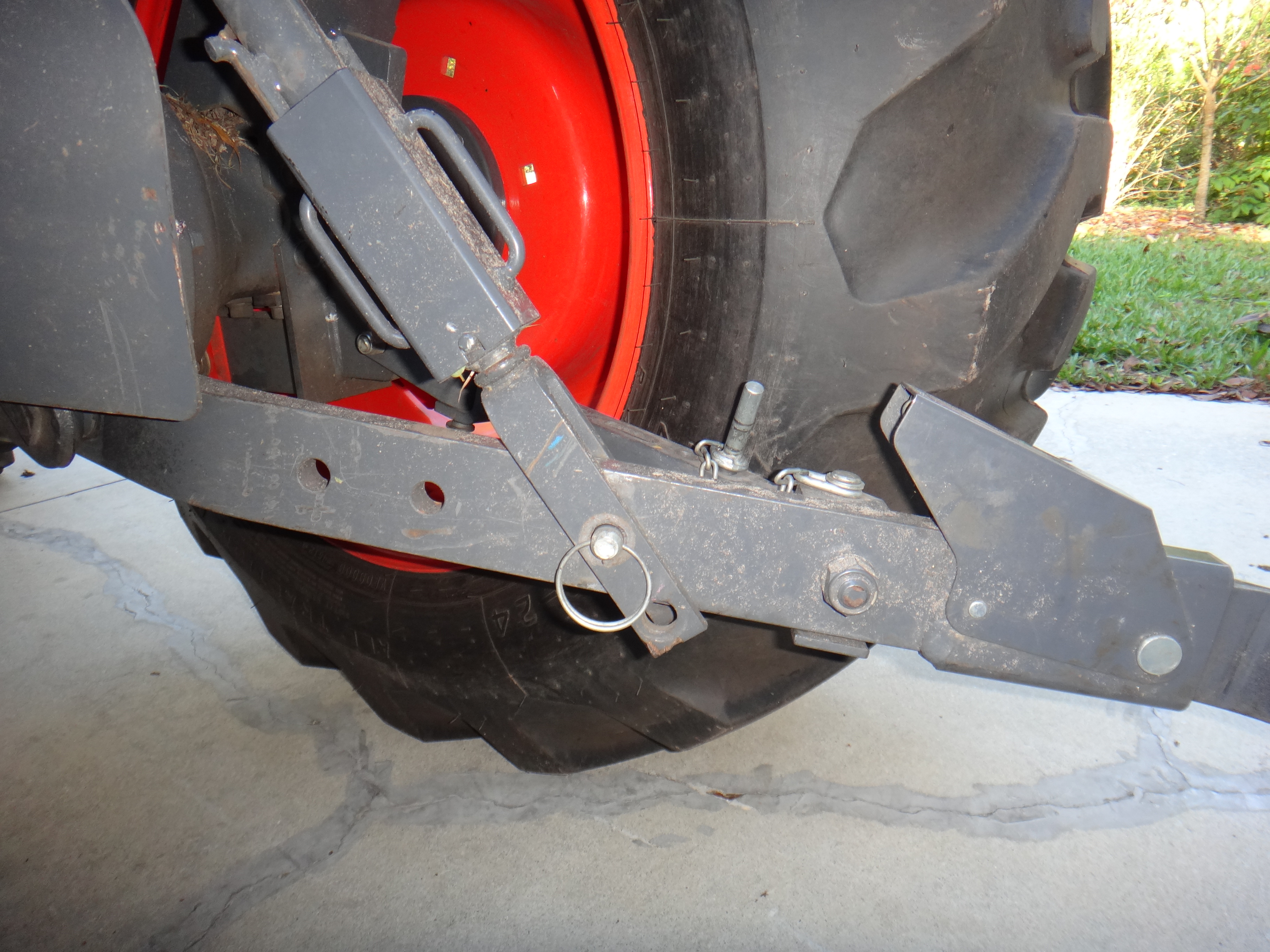

Enlarging your picture it appears you have the pin adjustment for your Lifting Rod stirrups in the lowest hole.
If you move the pin to the upper hole on both right and left hand Lifting Rod stirrups, the Bush Hog will lift at least 5" higher.
On my Kubota L3560 the upper holes are the "normal" adjustment. I use the lower holes primarily when I want my Cultivator to penetrate soil deeper.
Three Poiint Hitch adjustments can be confusing. For the Lifting Rod pin adjustment think: HIGHER HOLES = HIGHER LIFT
Shortening the Tip Link will also lift the tail wheel of the Bush Hog.

It looks like your top link is in the highest hole on the tractor side. Move it at least to the middle hole, the lowest hole would probably be best.

That's a Bush Hog Squealer from around 1997 - same one as shown in my avatar. The hitch is standard cat 1. If you can't lift the rear wheel you probably have the top link too long. I have to screw mine up quite a bit to lift the rear wheel.

Thanks for all the comments! And thanks TerryR for identifying the vintage. I moved the lift "stirrups" to the upper hole; left the top link where it was and have plenty of height. I poured some 90 weight gear lube in the box (It was half filled with grease), took it for a spin, and it seemed to work great.

Or just put the toplink in the lower hole. It will cause the tailwheel to raise much faster / higher in relation to the front of the cutter, but still be level at operating height.
