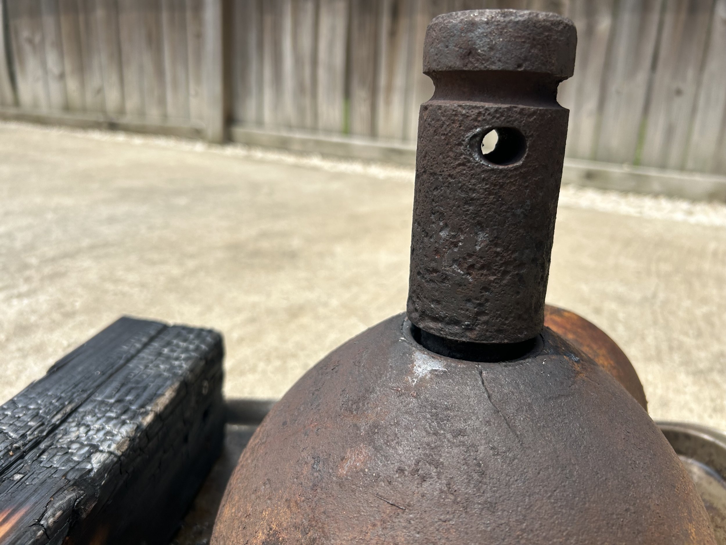

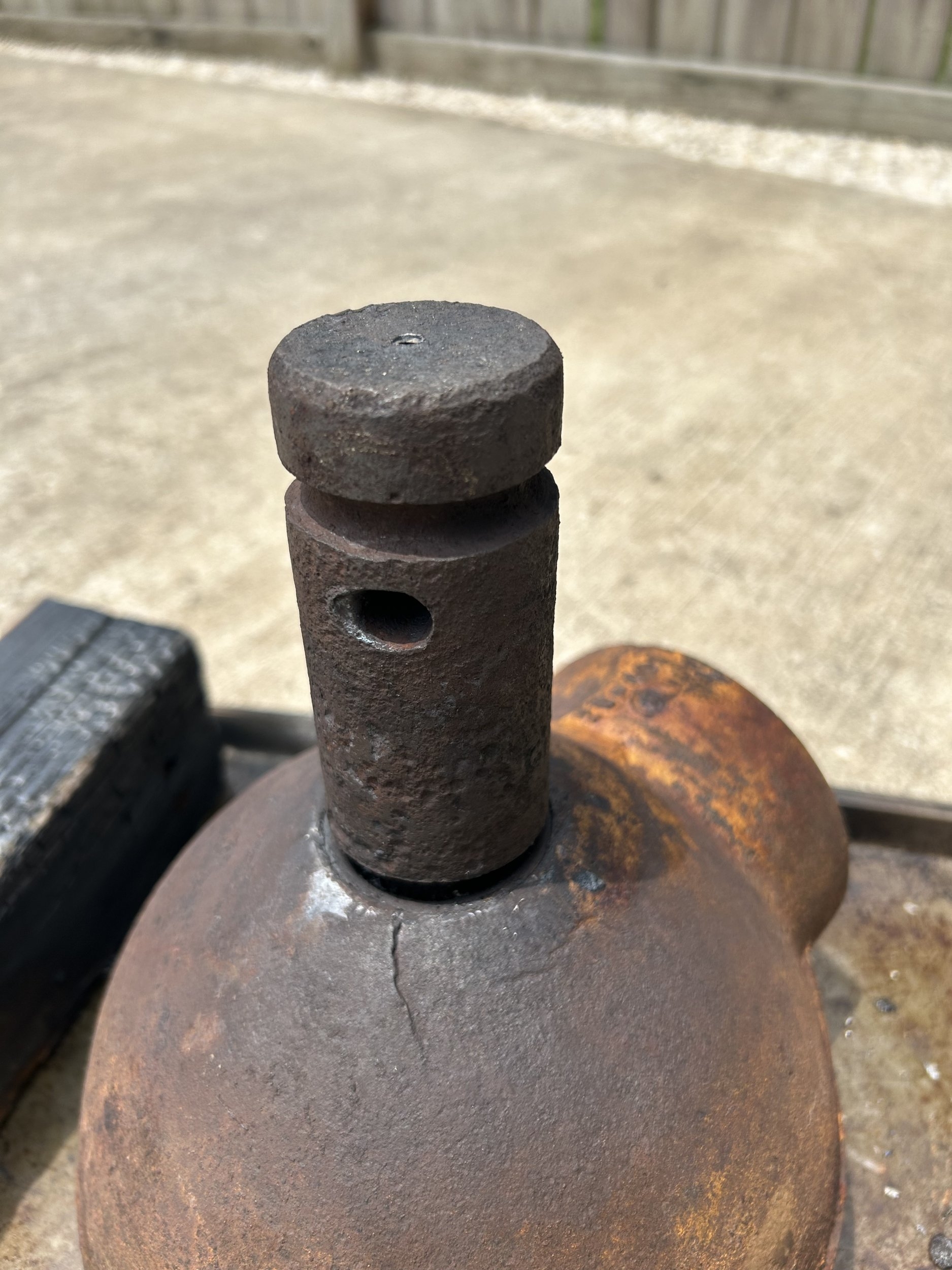

Can’t get this what looks like an adapter or sleeve off the output shaft. Tried torch, maybe need a bearing splitter. Looks like AutoZone rental coming up.
   / Old auger worth fixing up? #16
Got a parts diagram for this thing? It'd be good to be sure it's supposed to come off, before breaking it while trying.
