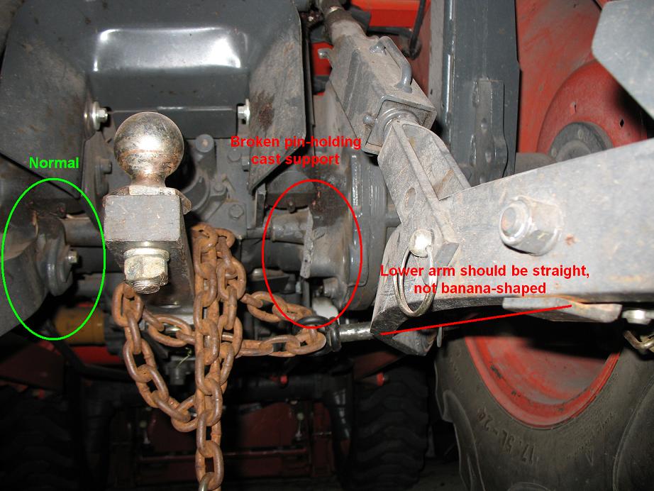

Pic below
The arms are for pulling, not pushing.
That's what my new ones will be doing from now. Well, I might push some cool whip or warm butter, but that's it :)
Why not use the FEL?
I felt like the leverage I get using the box blade was actually better. Also felt like the rear of the tractor is stronger. So much for that thinking.
This really stinks, too, because I always thought I had a good "feel" for geometry & force, good enough to know when I'm pushing something too hard. Dangit all.
ive pushed with my box blade but I always keep in the back of my mind that i risk bending an arm like 3RRL did.
Oh man I wish that's all that happened. :(
But specifically for the job at hand (pushing a tree over) id pick my FEL before my boxblade.
Will have to change to that policy from now on.
It's a good lesson for others to learn from.
Others may differ, but I'm thinking the blade on the rear of the BB is for smoothing out dirt and not for bulldozing.
Prob true. I just didn't know it.
As others have said, use the FEL. First give the tree a push, to loosen things up a bit, then throw a chain around the tree a couple of turns, hook it to the bucket, and use the curl, not the lift, to pop it out, roots and all. With one person driving and another chaining, we cleared about a dozen 6" saplings in ten minutes.
I've done this a lot, too, but it was sure nice to be able to back up to trees & uproot them without the need to get off the tractor to do the chaining, or have another person there to make it faster.
The 3 pt hitch is for lifting/lowering implements, and then pulling them, NOT pushing.
I now know. A day too late.
I got lucky and just bent the BB linkage all to crap when I did it.
Lucky duck. I thought the cheap TSC box blade I was using would bend before the lower arm, or surely before the casting would break.
(The chain in the pic is just holding the arm from swinging around & getting caught on the wheel or the ground during for my sad 4-mile ride home last night)

OUCH!! OUCH!! OUCH!!
I hate that when things like that happen.
What is the next step? Remove the housing and try to get a good weld job?
Find a replacement housing? It's on the wheel/axle side and not the main tunnel by the looks in the pic.
My Kubota dealership is handling the repair. I believe the broken/ bent parts will be replaced.
Do wish you well.
Thank you ... Hopefully others read this before the break happens. Sure wish I had. Just did not occur to me. Kicking myself.
