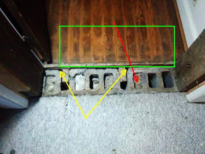

That board was a rough cut Oak 2 x 8 that served as the threshold board for what used to be the outside door on the front porch. It was laid over the concrete blocks shown below. Why those blocks weren't filled is a question no one alive today can answer. They WILL be filled solid in the next day or so.
I've since enclosed the old porch and made it another room (with the grey carpet). The wood floor is the old section and main house.

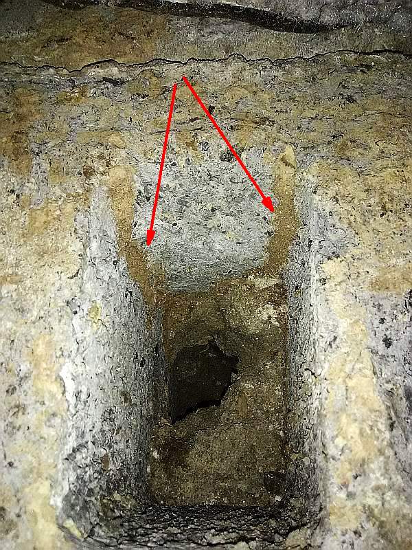

I demo'd enough this morning to find their entry point and find out how far they traveled. That material has all been discarded. The picture below shows the path. If you've never seen it before, you may not know what to look for.
There is NO crawl space or other access under this house. The only vents are a few concrete blocks turned sideways. I wasn't even sure until a few weeks back how much room there was under the floor. I had been hoping to someday cut an access door through the floor to get down there and look around. I finally found out that there is only about 8-10 inches, about the height of a concrete block between the floor joists and dirt. No possibly way for a person to move around.
Going back up to the threshold picture, the red arrow point to the void where the entry path is shown in the other picture. The two yellow arrows point to the ventspace under the floor. Air is moving freely from the outside vents up through those holes.

>> Other than the stuff at big box stores, what can a homeowner buy to treat these devils? I have a Bayer product that killed them on contact this morning. I sprayed as much as I could down into areas I couldn't see into and along some of the wood joints beyond where I found them. Pouring the voids full of concrete will stop future access.
>> How should I refinish the edge around an access/inspection hole? Back to the threshold picture, the green box is where I'm considering cutting the floor now that I can see in there a bit better. I don't need to make it big enough to get through, but just a foot or so, enough to get my head or a camera through to do more of a visual inspection further back. I won't cut the joists, just the rough and finish floor boards. I'm hoping a single circular saw cut will get through and there won't be a wide space left. I know I'll have to add another 2x to support the cut section, But I'm trying to figure out what to do on top for the finish floor.

Yeah, I've seen that mentioned a few times here. This Bayer stuff worked fine, but again, you have to get at them. It kills on contact, but that means ON CONTACT, it doesn't work below ground.

Not cheap by any means (neither is termite damage) but works... FUSE Termiticide Insecticide. It goes a long way... been using it for the past 5 -6 yrs in the spring on the perimeter of the foundation & have had great success with it.... even for the carpenter ants. Nice thing is it is:
"Fuse is non-repellant, which means that the insects cannot detect it and will readily come into contact with it. In doing so, they will receive a lethal dose of the insecticide. With insects such as termites and ants, they will also carry this lethal dose back to the colony and spread it among the other insects as well."

I would ask an exterminator...they generally tell you that infestations of subterranean termites begin when there is moisture present (i.e., a roof or plumbing leak that runs down the framing)...they need the moisture to make the (mud) tunnels up the blocks to reach the wood...

For termites, use anything with the active ingredient 'fipronil'. As mentioned above, 'Fuse' is one of those products. Read and follow the label and you will have good results.

I'm not really understanding how spraying this stuff on the surface with a normal garden sprayer will make it penetrate the ground deep enough to get to them. One of those sites casually mentions trenching, but doesn't go into detail.

Both are labeled for use on termites and both contain Fipronil. So either one would work. I did not read the entire label for either one, but I think you should read it before deciding which one to use and before applying either one. Here is a link to both labels for your convenience.

you use taurus sc outside in the ground either through injection , or a ditch or i used a 2 and half foot drill bit, and funnels. i used FUSE inside in specific damaged area's then used bora care on every single piece of wood i could spray in the basement, this stops them from eating it in the future.

One guy mentioned a trench 6" wide by 6" deep. I can do that in some places, but I kinda' like the drill idea too. Would make a lot less mess to drill a 3/8 hole every two feet or so.
I was planning on drilling each concrete block to inject into the webs, but I'm not sure I want to get into all that if injecting into the ground would accomplish the same thing.
   / OK, Gang, Need House Advice, KIinda Urgent. #20
You have a serious infestation and treatment for such is more than an exterior perimeter application. Probably an interior and interior application of two products. Don’t screw around, get a professional in there, then do your own applications after that.
