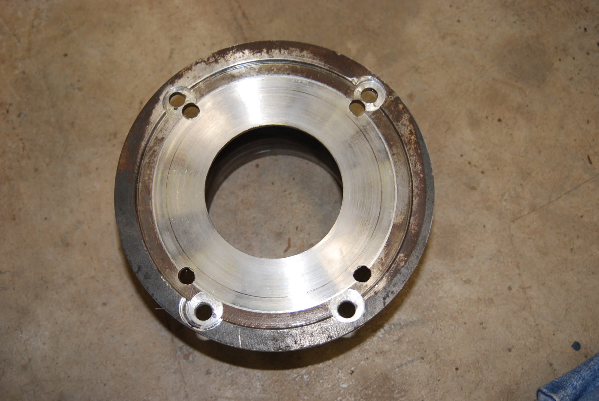

Ok, something ain't right. So, let me post some additional details.
If you go to tewarehouse.com and look up these engines, you can download a high resolution image of the bolt circle under the "Specifications" tab for each engine. For the image I posted of the 25 bolt circle, you can see in the orange highligted area a spec of 163.5 for the pilot flange. Assuming this is mm, that's 6.43701". In the image below, you can see a 6" scale on the motor mount. The machined flange is clearly larger than 6" and is probably 6.44" (I only have a 6" caliper).
As far as I can tell from the spec, the 35 uses a 5.75" flange. But Gravy said, if I'm reading his message correctly, that he needed to enlarge his motor mount flange to fit the pilot flange mount. So, ether I'm not understanding his comment, or his old 25 motor mount is significantly different than mine.
Now, my mount will fit the 35 bolt circle, assuming it's 5.75", but it won't take advantage of the engine's pilot flange to accurately position the mount. Given the natural "play" in the coupling, this may or may not matter. I have a milling machine with a DRO that will accurately position a new bolt circle in my existing motor mount. Would this be "good enough" and I can just ignore the pilot flange altogether?

/ OK, decision time: 28 or 35 #42
DSC_3095.JPG Hopefully this will explain the modification. The new bolt circle is larger and unevenly spaced, while the new pilot is smaller.

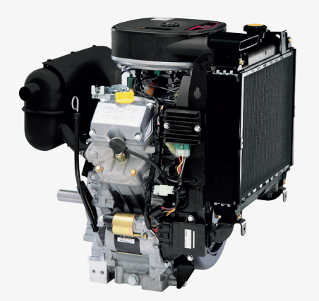

Hmm... no one's done the Kawasaki before. I know I'm curious about how'd it turn out. ;)
Scrag did.
http://www.tractorbynet.com/forums/p...-modified.html
http://www.tractorbynet.com/forums/power-trac/110268-pt-429-project.html
He had problems fitting it all in, and ended up mounting the radiator above the engine lid, making the back end of his PT425 about a foot taller. There has got to be a cleaner way to shoe-horn it all in, since the base engine (sans radiator) is basically the same size as a EH72.
I seem to recall he had like a 150 page thread on blow-by-blow of his conversion, but couldn't find it.
