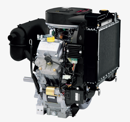

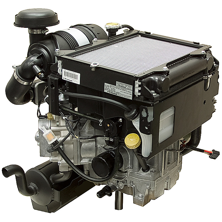

I would like to see an adaption of a vertical liquid cooled engine, with the hydraulic pumps mounted vertically and driven off a drive belt with a clutch to make starting easier. I am betting it would be a more efficient use of the space in the engine compartment, and maybe allowing shoehorning in a liquid cooled engine.
Something like this Kawasaki 26:

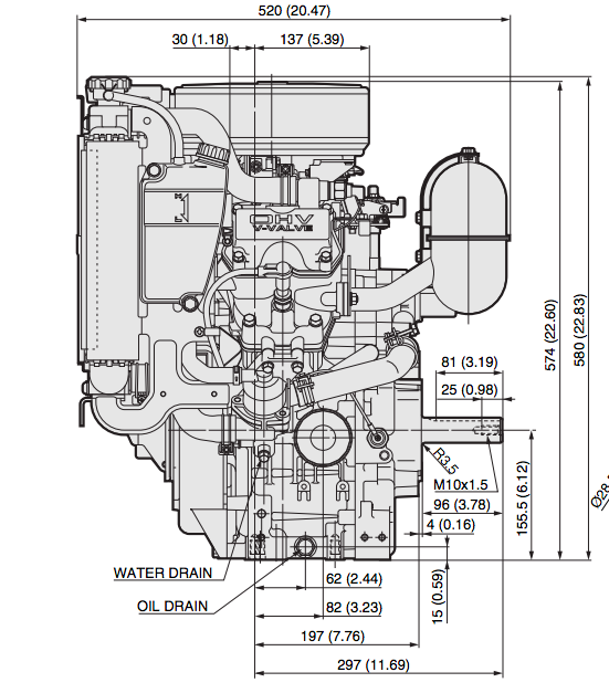

OK, that might be a bit much to make that work. Back to the Kawasaki FD791D horizontal liquid cooled, DFI 26 HP engine. This would require an additional 4" in the tub over the existing Robin 25. At $2200, it isn't much more expensive that the air cooled twins.
Kawasaki Engine Model FD791D-S01 - On Sale At Tulsa Engine Warehouse
Screen Shot 2015-07-18 at 1.49.18 PM.pngScreen Shot 2015-07-18 at 1.51.06 PM.png
I think that cutting the back plate off the tub and welding a 4" extension would work. You could continue the natural slope up of that back section of the tub to avoid giving ground clearance problems. I think with a bit of thought this could be done elegantly. I think if I was re-engining that I would start playing around with solidworks to see if I could fit it all in.
You could also step up to the FD851D 31 hp engine, which I think has the same footprint, for $2450.
View attachment 433434View attachment 433437
This was the engine I was looking at a while back. I didn't spend much time on it, but do you think the radiator connections could be extended such that it could be mounted out the back of the tub (with a protective shroud)? Maybe the rear-facing side of the cover could be removed so that it would rotate right over it when opened? I was thinking the bulk of the existing tub could be left as-is and the only major fab would be the shroud (and maybe some cutting of the rear tub section). That being said, I didn't actually look at measurements, etc...
