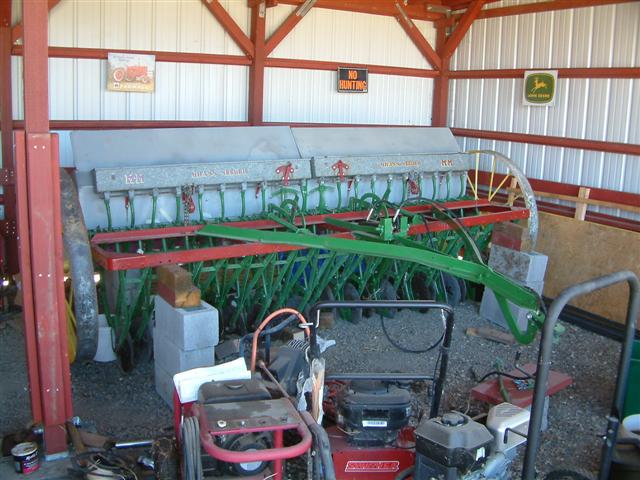

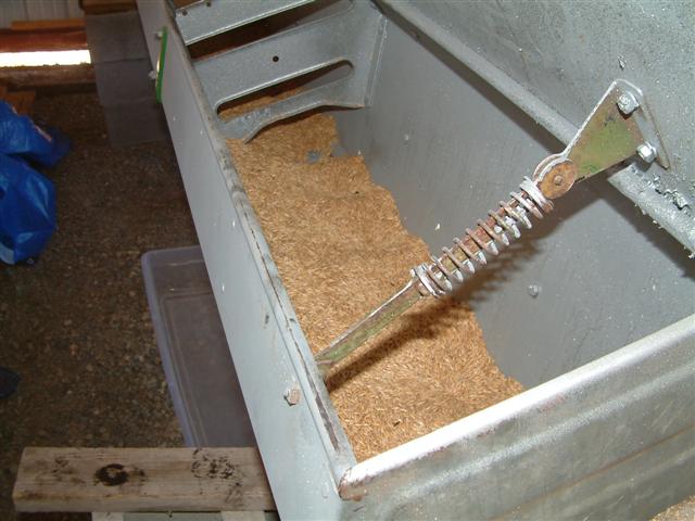

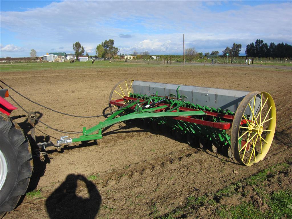

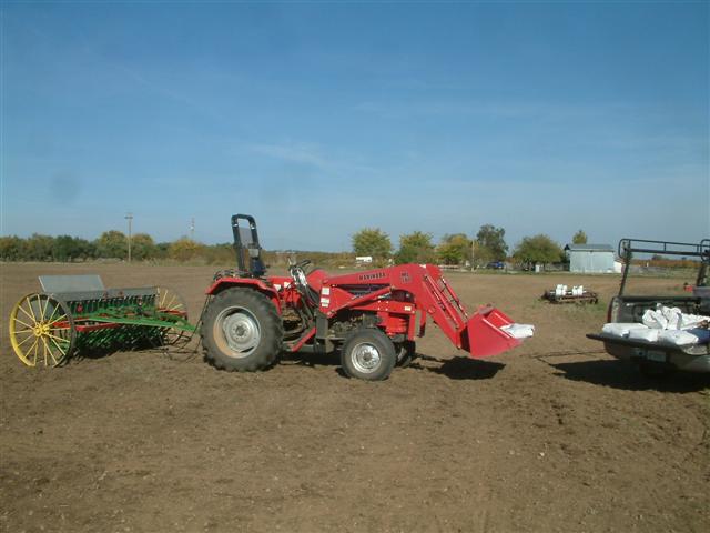

Here are a few photos of a Minneapolis Moline P3-6 grain drill I refurbished about 10 years ago. Bought two of these from a neighbor for $250. Both were restored. Parked one on my front lawn. It's 10 ft wide, 20 drops, single disc openers.
M5525 drill---3.JPGM5525  drill-1.JPGDrill-6.JPGDrill cal-3.JPGDrill cal-2.JPGDrill cal-1.JPGKanota oats-1.JPGKanota oats-2.JPG

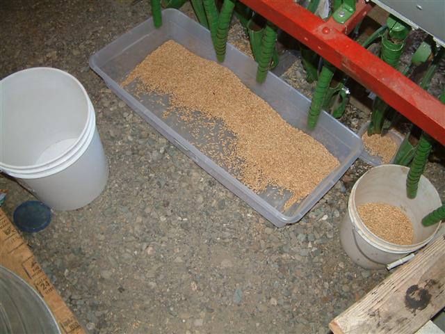

I calibrated the feed mechanism by jacking up the drill, putting a weighed amount of grain in the hopper and counting the number of turns of the drive wheel to empty the hopper. Knowing the diameter of the drive wheel (4 ft) and calculating the perimeter of the wheel (diameter X pi) and using the width and number of turns, you calculate the area and then divide weight of seed by area to get pounds per acre. There are other ways to do this, but I think this is the most accurate way for a drill like this.
The photos show the seeding result using Kanota oats.
The tractor is a 2008 Mahindra 5525.
Be sure to lift the openers before making a turn. I installed a hydraulic ram for this job. It has two trip clutches with pull ropes but that was a little too authentic for me.
Good luck
