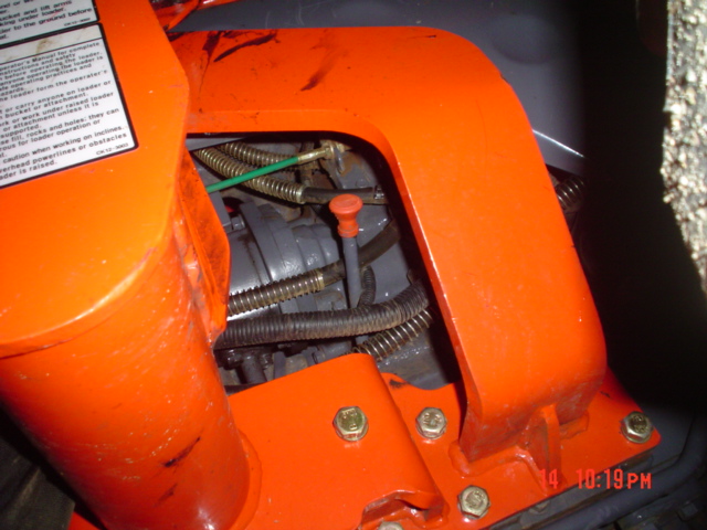

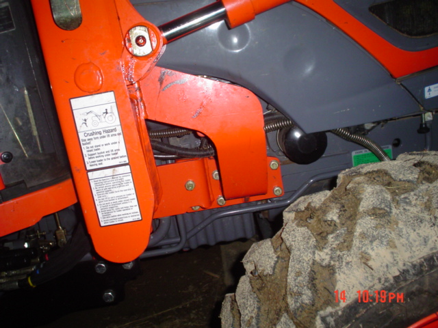

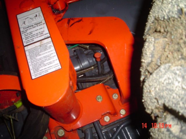

As you face the tractor left side. Its the opposite side that the manual shows you.
Thanks, SunnyJim and Mousefield. Now I do not feel like a complete idiot. Do they read backwards in Korea, or drive on the wrong side of the road?
ha ha ha. That dipstick is pretty hard to find actually.
