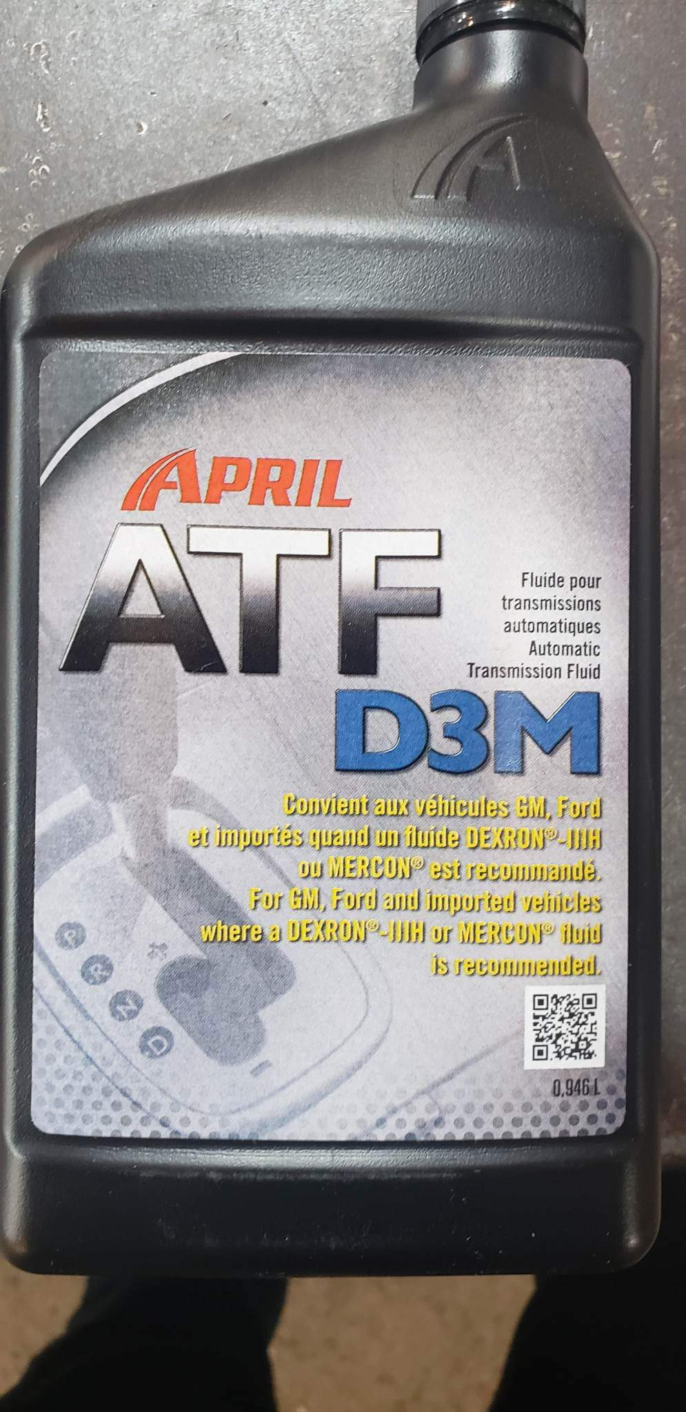

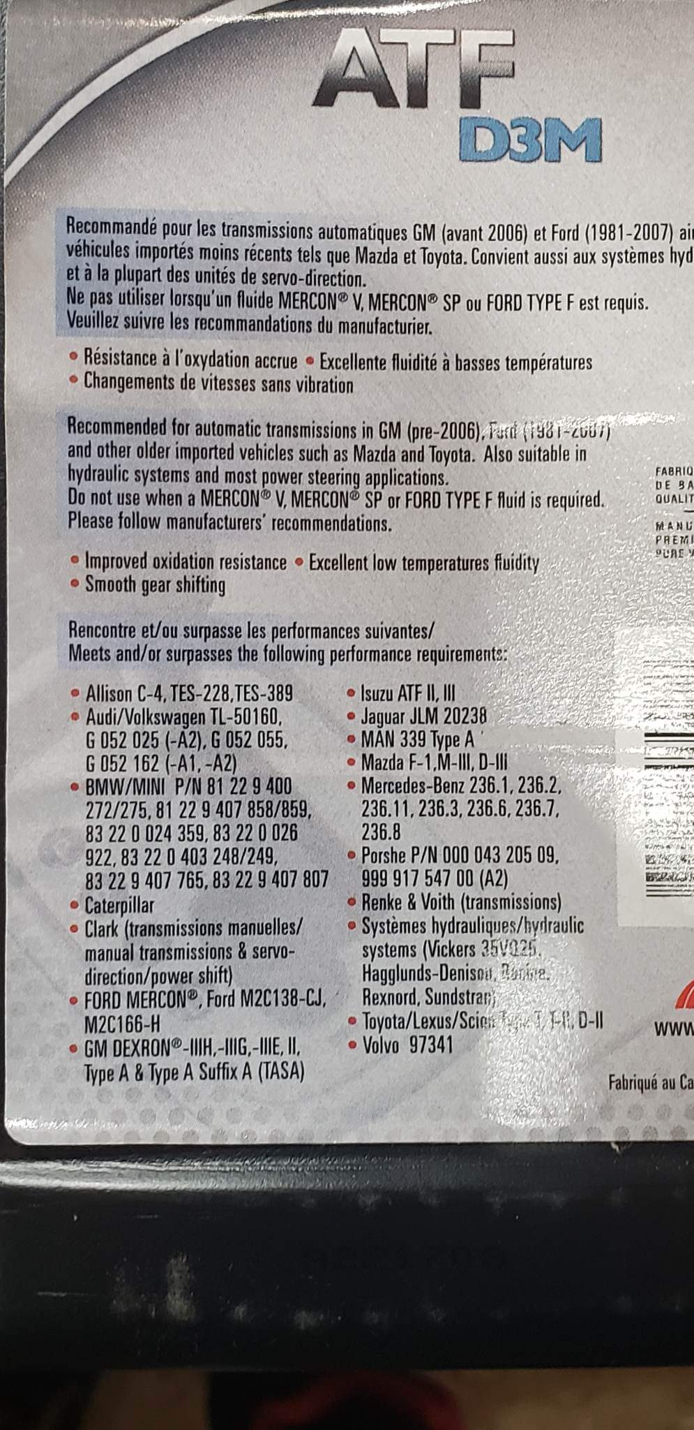

Hoping there might be an oil expert that can answer this but if kioti factory filled my front axle with hydrolic oil could I not use this ATF when I do thee 50 hour service? I was always under the impression that ATF was superior to hydraulic fluid and wasn't used simply cause of cost. I have 3 crates of thiss ATF and no use for it. I also have a crate of synthetic 80-90 but feel that the viscosity of ATF would flow received_724407792420148.jpegreceived_4820494254741849.jpeg better and lubricate the axle turning spindles better as they are integral to the axle.

Hoping there might be an oil expert that can answer this but if kioti factory filled my front axle with hydrolic oil could I not use this ATF when I do thee 50 hour service? I was always under the impression that ATF was superior to hydraulic fluid and wasn't used simply cause of cost. I have 3 crates of thiss ATF and no use for it. I also have a crate of synthetic 80-90 but feel that the viscosity of ATF would flowView attachment 782846View attachment 782847 better and lubricate the axle turning spindles better as they are integral to the axle.
An automatic Transmission is just one, big, Hydraulic mechanism that sees more stress in 5 minutes than your LS front end will see in its lifetime.
But there's always the question of "What's in the front end and will the ATF play well with those metals?". In a Tractor front end? I can't think of any reason not to use it
But don't take my word for it --
ATF makes a fantastic hydraulic oil.
Automatic Transmission Fluid is used in everything from a Fiat 500 to a Ford F-150, and because of the astounding service life required by vehicle transmissions, the fluid used is some of the most high-quality lubrication available. ATF experiences such extremes in temperature, humidity and viscosity, yet can last 30,000-60,000 miles or more.
ATF is formulated for high viscosity index (the ability to maintain test viscosity over a wide temperature range), and has excellent water control properties, allowing the fluid to hold more water in saturation before being released to create corrosion. Also, the additives in ATF are formulated to improve lubricity, anti-foaming, shear stability and resistance to oxidation.
ATF is a premium hydraulic fluid, but also comes at a premium price, which is its major downside.

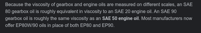

remember that the "80w90" of gear oil is on a different scale than your engine oil - 80w90 is similar to 20w50 engine oil, as far as viscosity goes:
