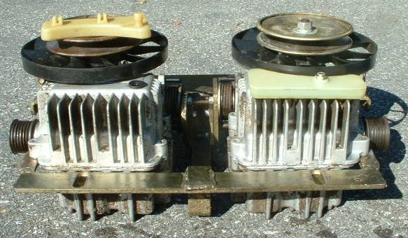

Nov 30, 2018 / Oil/Fluid for Peerless 2100? #1 Diggin It Super Star Member Joined Aug 12, 2018 Messages 11,200 Location I'm thinking, I'm thinking! Tractor LS MT125 TLBM My field & brush mower has these two Peerless 2100 transaxles as shown. I can't find out what kind of oil to use to top one side off that's a bit low. Anybody know?
Nov 30, 2018 / Oil/Fluid for Peerless 2100? #2 T tomplum Elite Member Joined Jan 30, 2017 Messages 2,914 Location PNW Tractor XJ2025H The spec is Mobil 424.
Nov 30, 2018 / Oil/Fluid for Peerless 2100? Thread Starter #3 OP Diggin It Super Star Member Joined Aug 12, 2018 Messages 11,200 Location I'm thinking, I'm thinking! Tractor LS MT125 TLBM Which I haven't been able to find. At least not in consumer quantities.
Nov 30, 2018 / Oil/Fluid for Peerless 2100? Thread Starter #4 OP Diggin It Super Star Member Joined Aug 12, 2018 Messages 11,200 Location I'm thinking, I'm thinking! Tractor LS MT125 TLBM I'm seeing some discussions about cross references that say it's a universal tractor fluid. If so, can I use the Premium Universal stuff from TSC?
Nov 30, 2018 / Oil/Fluid for Peerless 2100? #5 T tomplum Elite Member Joined Jan 30, 2017 Messages 2,914 Location PNW Tractor XJ2025H I'd think so. It shows as equivalent to the low vis hygard JD oil JD 20 if you are looking for something easy to match on the label.
