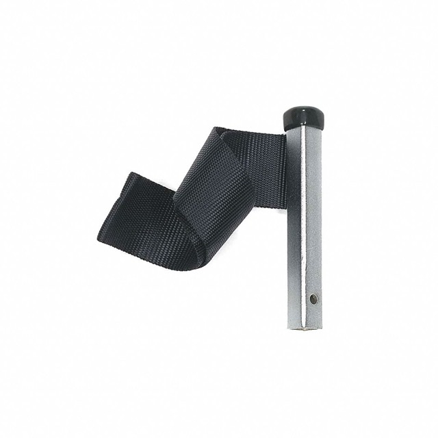

I have quite a few oil filter wrenches but like using the ones shown in post 26. I did not have one for the filter on the Kawasaki Mule and tried channel locks. Started to crush the filter and backed off. Ordered the "socket" style for $10 from Amazon and had it in a couple of days. Had to beat it on a bit as I had damaged the filter with the channel locks but it worked.

I have done that. I have also had filters in such cramped places that the "universal Craftsman tool" would be a lot more difficult than using the proper wrench.
I remember one filter that gave me a bit of a pucker. This was when I was poor and used the Craftsman method to take it off. It was on really tight and would not come off. I had mangled up the filter very badly and it still held firm. Luckily if finally let lose. That was the last time I used that method.
I must be rich or stupid (or both?). I must have about $100 invested in various oil filter wrenches and some are over 50 years old.
