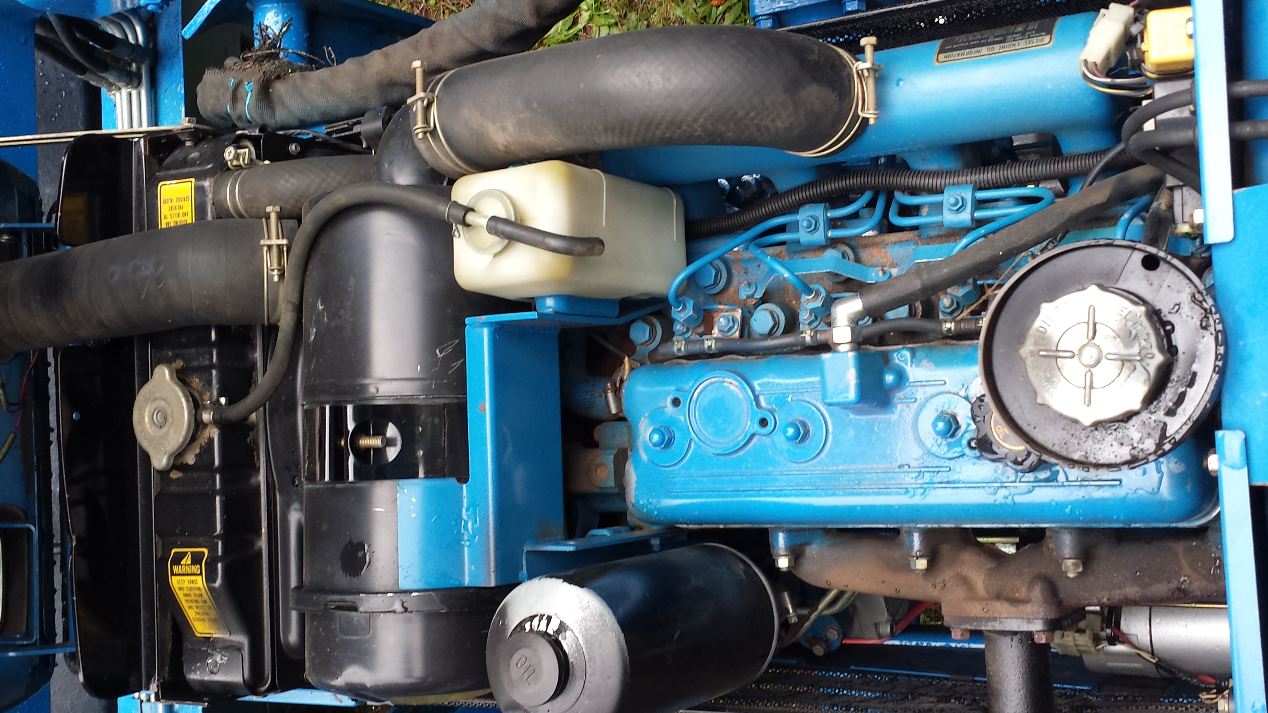

2120 engine oil filter is parallel to the crankshaft.
Threads on to the side of the block, end of filter is close to the lower side cover.......
You can see it to the left of the front tire.
Ed

That's a late Tier I emissions 2120; 1999 or later. Different engine than the OP's 1995 model and takes a different engine oil filter.
I'm not making this stuff up; been wrenching on and selling parts for Ford and New Holland tractors for 20 years. Ed and George are confusing the issue. I don't care if the OP uses OEM, Wix, CARQUEST, NAPA or whatever. But he should use a filter correct for the application, not whatever somebody thinks fits.

Sorry for trying to help. Don't mean to confuse anyone. I only replied with the filter numbers I found published on the filter cross reference sites, not what I think fits. Apparently they're all wrong.

Hopefully I get up this weekend and find out. I am going off memory, so who knows. I took pictures, but none that show it.

That's a late Tier I emissions 2120; 1999 or later. Different engine than the OP's 1995 model and takes a different engine oil filter. .
Unreal! I had no idea they actually switched to different engines in the same model. I never would have that about that. thanks for posting that.
   / Oil filter for New Holland 2120 #30
I have a 1993 Ford 2120. Filter is parallel to crank. Oil filter #s I wrote down are Motorcraft FL-300 or Napa 1329. Those are a few years old but should be right. If you need a pic, let me know.
