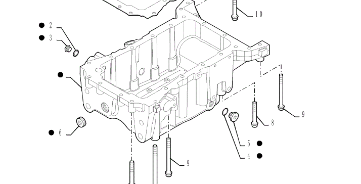

So, I know this is a pretty dumb question, but...where is the oil drain plug on a Workmaster 75. Doing the 50 hour maintenance and got started in dark. I cannot fine the drain plug, though. Any help is appreciated. Thanks.

One in every crowd. I looked there, but the pic wasn't any help.
   / Oil Drain Plug #4
Just a guess, but I think it's item #5 in the image below.
Steve

Thanks. I'll give it a try this afternoon. I guess I was looking for a bolt instead. There is a plug just like that one on other side too. Thanks, again.
   / Oil Drain Plug #6
It's hard to tell from the diagram, but it looks like the Workmaster drain plug has a hex drive head. FWIW, the hex drive head on my TN 55's drain plug is 12mm.

Thanks a bunch, brother. Mine was probably a 12mm too, but I used a T60. Couldn't find a 12mm anywhere. Thanks, again.---Craig
   / Oil Drain Plug #8
Sears has a 12mm hex key: Sears.com.
You can make a workable driver using a bolt with a 12mm hex head and two nuts (one acting as a jam nut).
