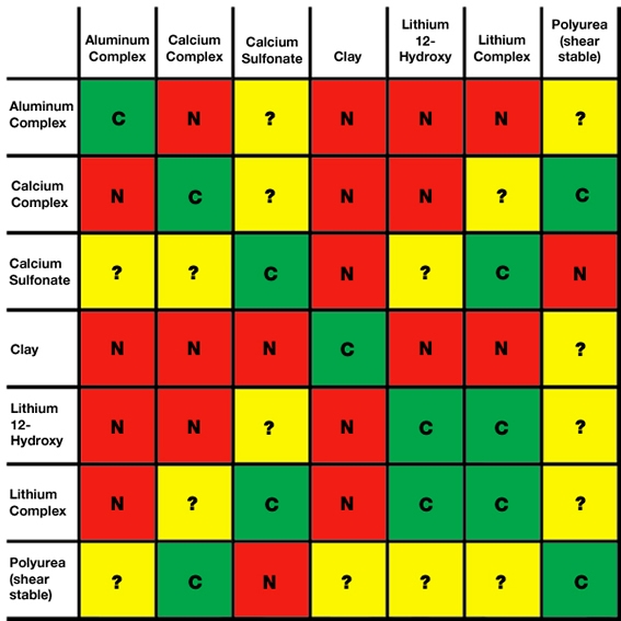

/ oil decision #36
Oil compatibility is a cake-walk compared to grease.
  • C when the mixture is compatible
  • N for when it is not compatible, and
  • ? when the combination is questionable. (This means it might be compatible, but needs to be tested.
  • Good Post
Reactions: DMW
