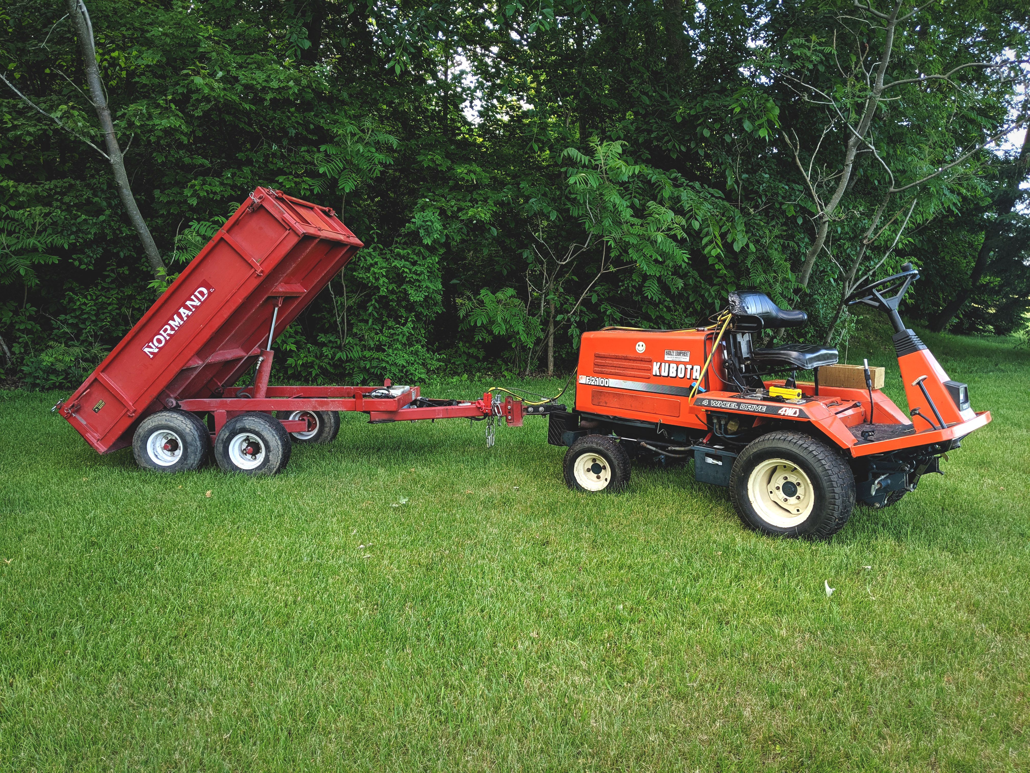

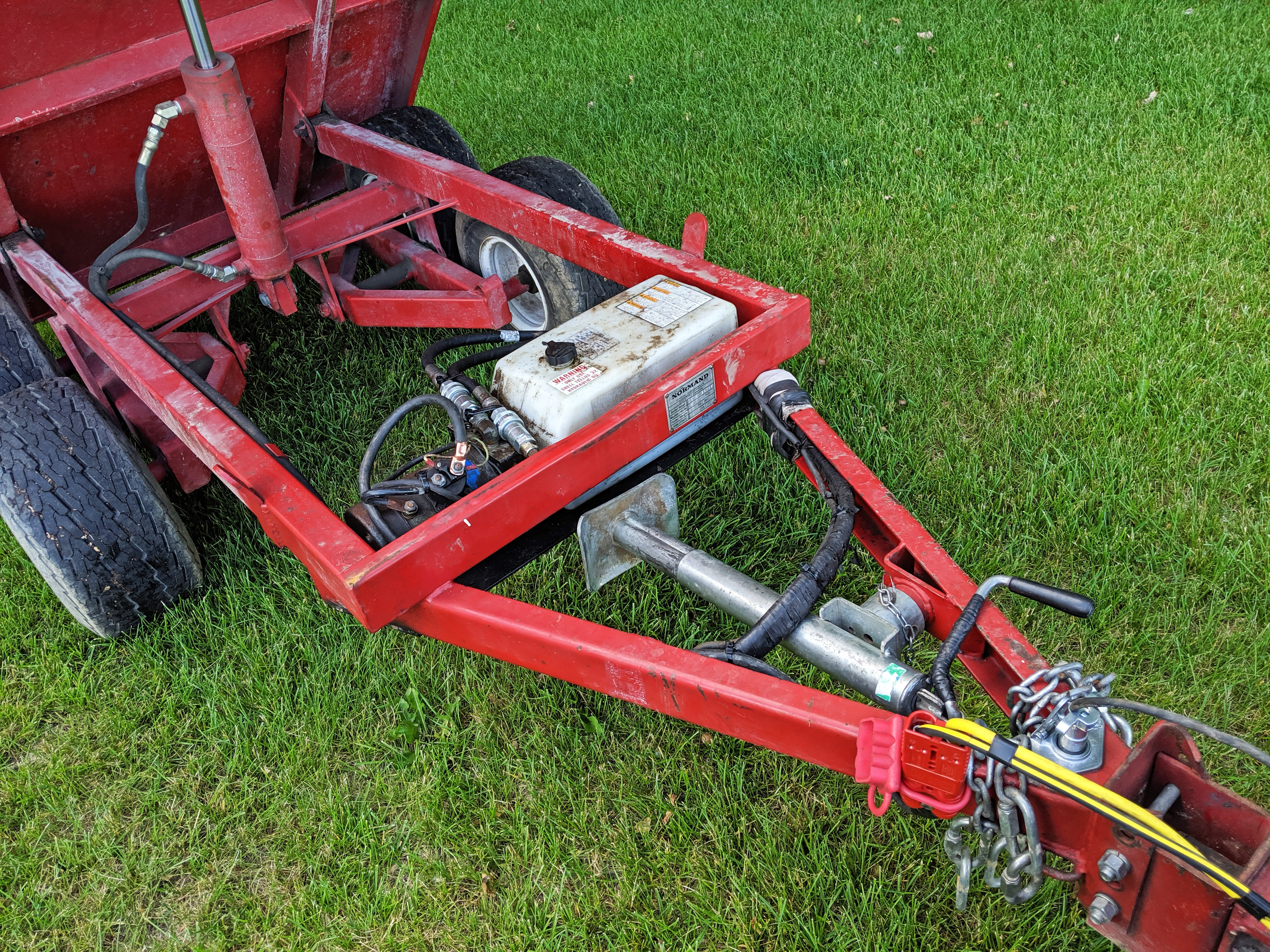

So a friend wanted to borrow the trailer to support some excavation he was doing. He didn't want to use a tractor to dump, so he asked if he could add a 12v hydraulic system off an old dump trailer he had. I was reluctant as he has a habit of cobbling things together in a hurry, but he did a pretty decent job and only welded on the one plate to hold the pump (which fit conveniently under the box) and drilled a couple of holes for the quick connect wiring (power supply and pump controls). The trailer doesn't have much room to mount a battery out of the way anywhere and I told him I didn't want it outside the tongue as I sometimes like to jackknife it. So he decided to use tow vehicle power via booster cables that quick connect to the trailer through a plow harness power supply. It works perfectly with my Kubota as the battery is readily accessible. A battery could always be temporarily mounted to the tongue and he maintained the existing hydraulic hoses and couplers on the trailer if I ever want to hook it to a tractor. The only thing I'd like to see different is the "return" line coming from the cylinder. It's just dead ended with a "vent" that seems to weep a tiny bit of oil (as it's a single action pump). I would've maybe drilled into the hydraulic tank and used a couple to feed it back into there. It works well though and raises fast and comes down relatively good by gravity.
If you told me that was factory I'd would've believed you. Going to get spoiled now.. ;)
