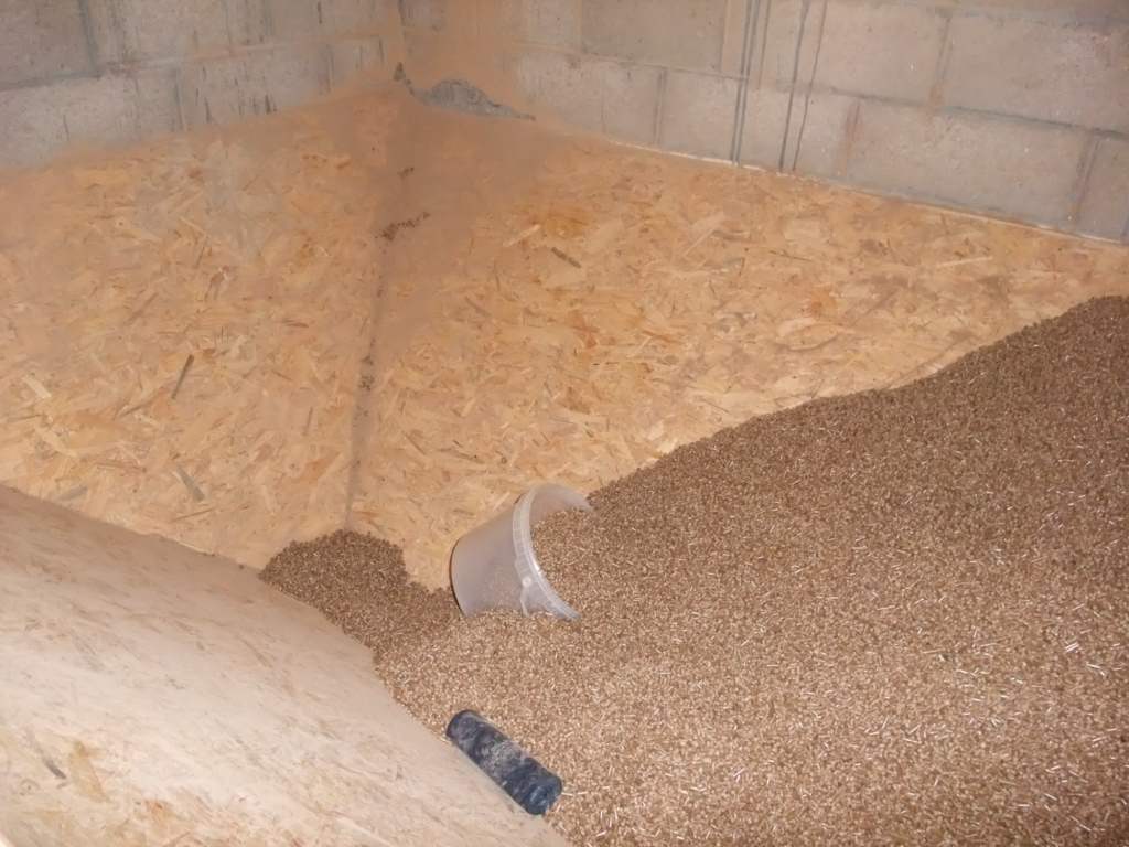

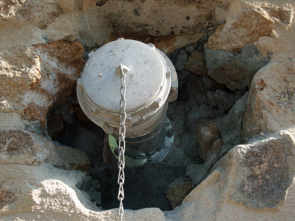

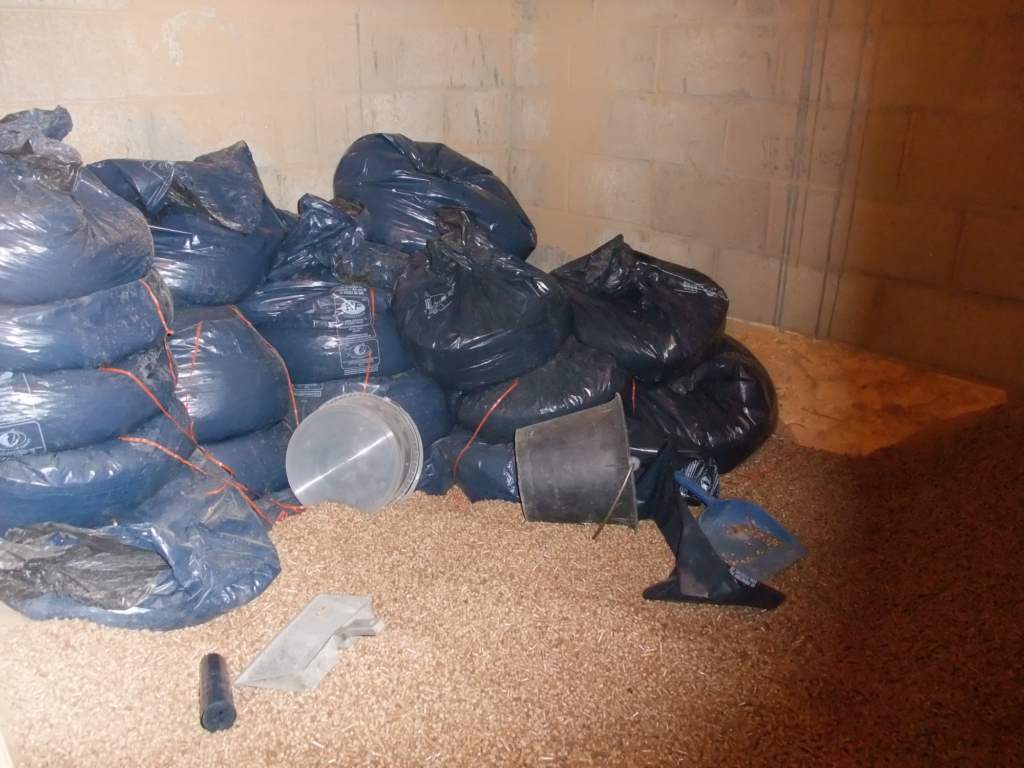

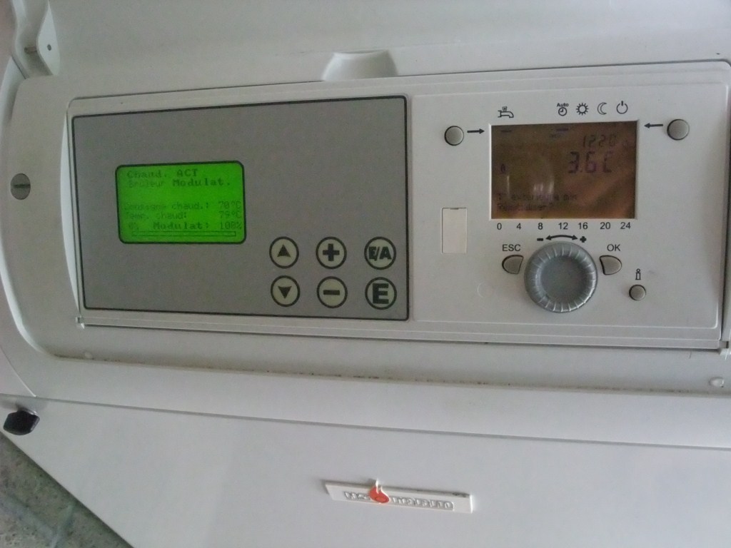

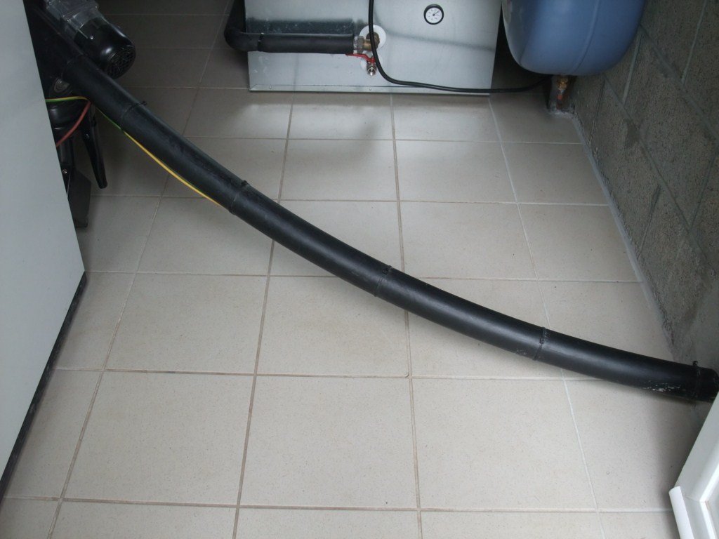

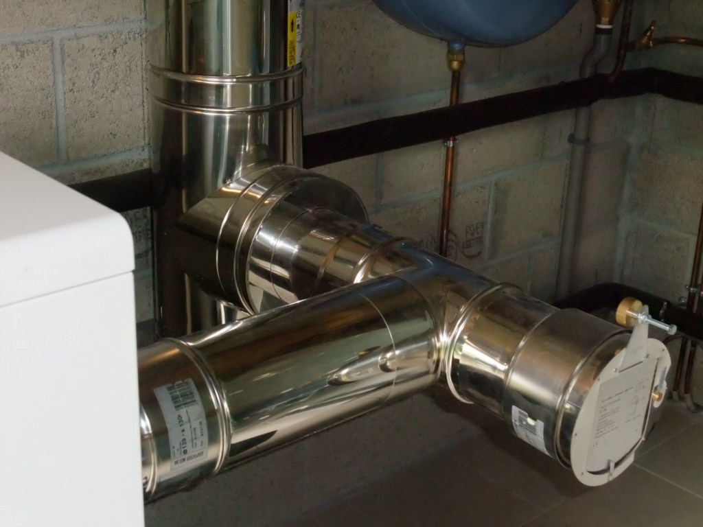

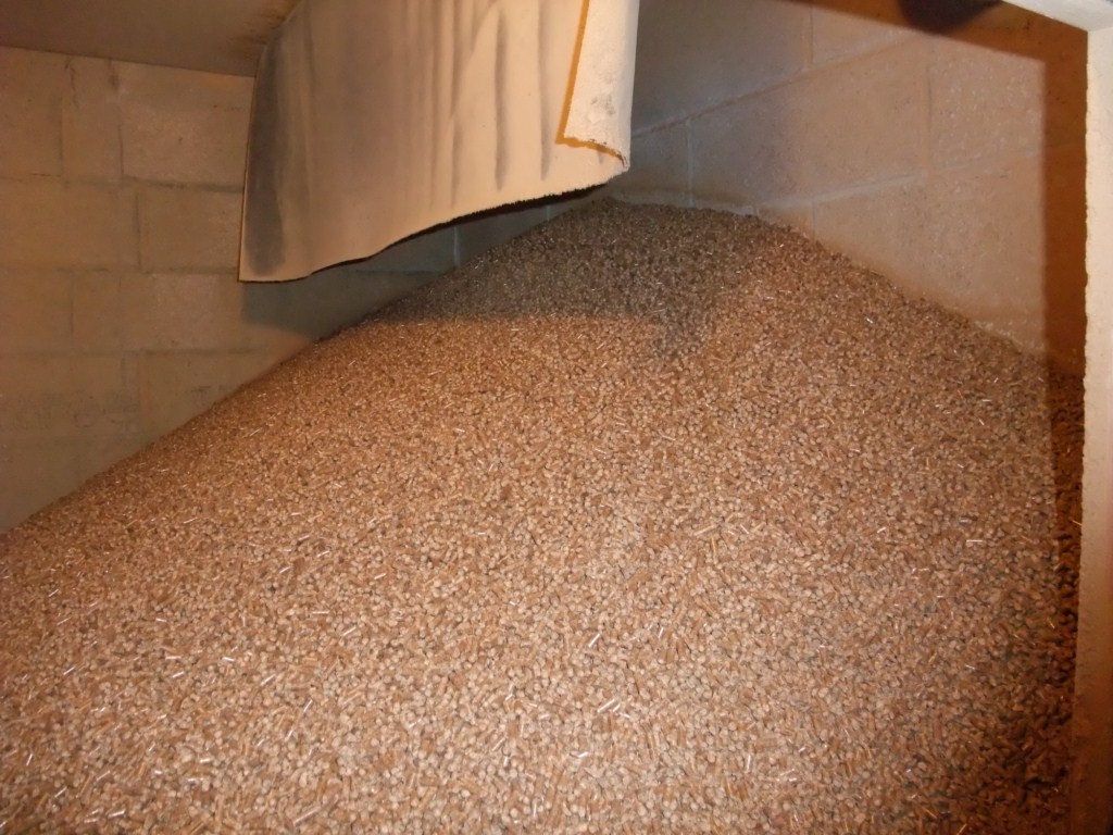

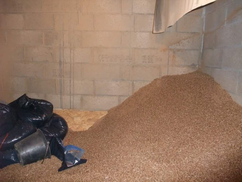

I am a bit worried about that, but no moisture so far. The walls are thick (granite on the outside and cinderblocks on the inside), the floor is isolated from the ground and the pellets rest on wooden slopes. I keep my fingers crossed. The only incidents I've heard about concerned metal silos.
We just had a problem with the pellet feed. Quite a lot of saw dust was loosened when the pellets rubbed against the inside of the pipes , against each other or on the silo walls. When the collecting part of the screw was finally filled with loose dust, the screw stopped feeding anything to the burner and the system came to a halt. Had to empty the remaining 2 tons of pellets by hand to clean the screw and put them back in the silo. A very tiring job that took 2 persons a whole day. The good news is there was no moisture. Hope this does not happen again soon !
