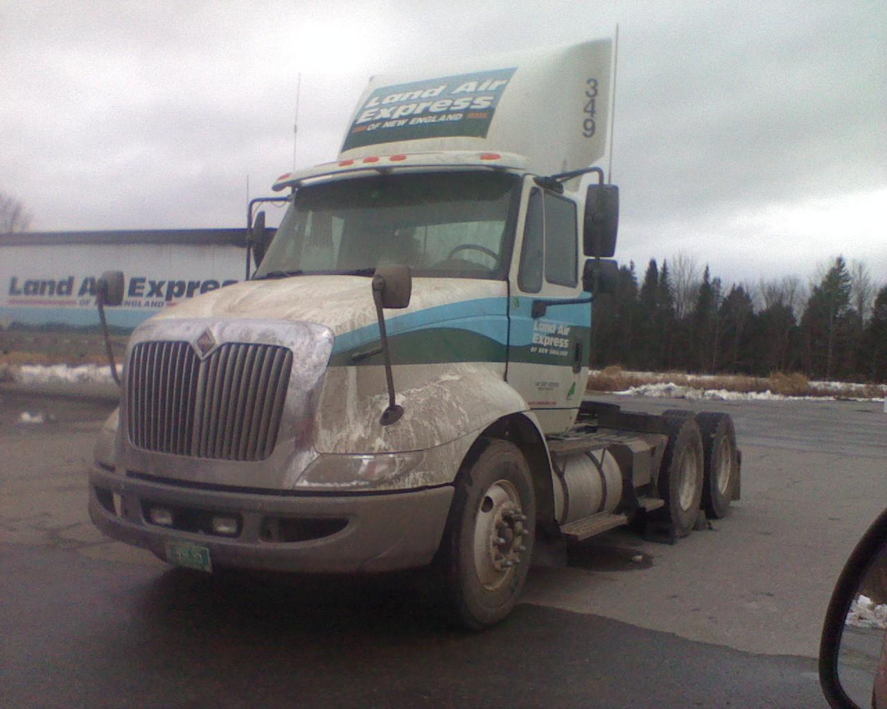

Hmm...... Tranny slap? Odd. At least it was a findable issue, not like the electronic gremlin my 8600 has had. Our "Master Mechanic" (spoken VERY loosely with max gvw of sarcasm) has fixed the issue no less than three times. (Right) Truck would momentarily shut down going down road from the computer loosing power momentarily. Wednesday night, in a Nor'easter, it died for good. Truck broke at 1730, tow truck showed up at 0100, I punched out at 5am, 22 hours after punch in. Only thing worse than breaking a truck 120 miles from the barn is picking the second most remote corner of Maine to do it in.
Good news is this time the issue is permanent and the 2k towing bill, while our brand new tow attachment sat unused in the shop, is sure to catch some attention.
