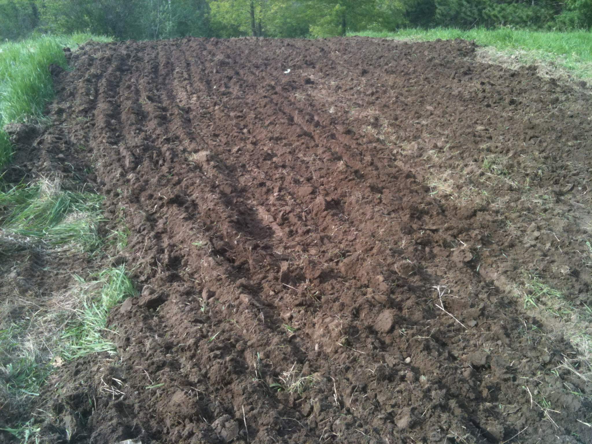

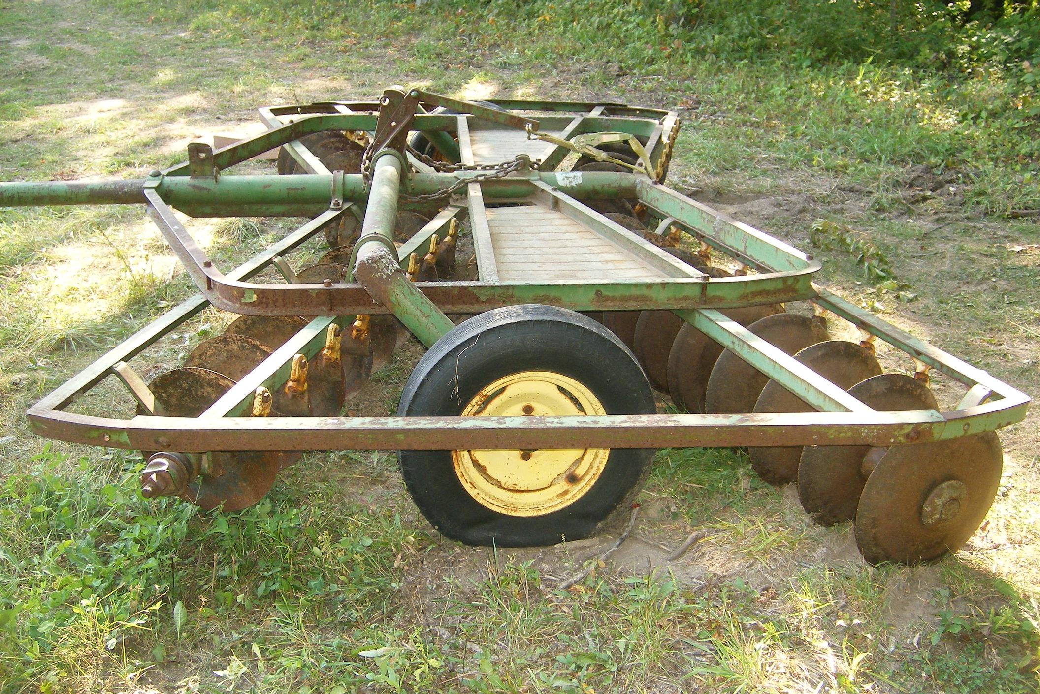

Well i got started on the off-set disc i have wanted to build for a while from parts from a john deere 1300 disc and a kewanee model 88 cultimuncher. So far it seems to be going pretty well here are some pics so far.

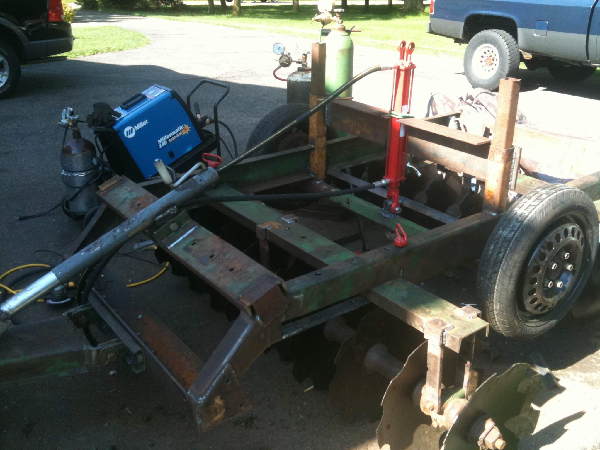

   / Off set disc
#2

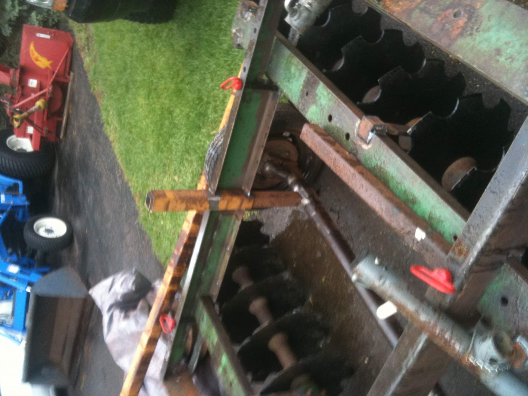

starting to work on it

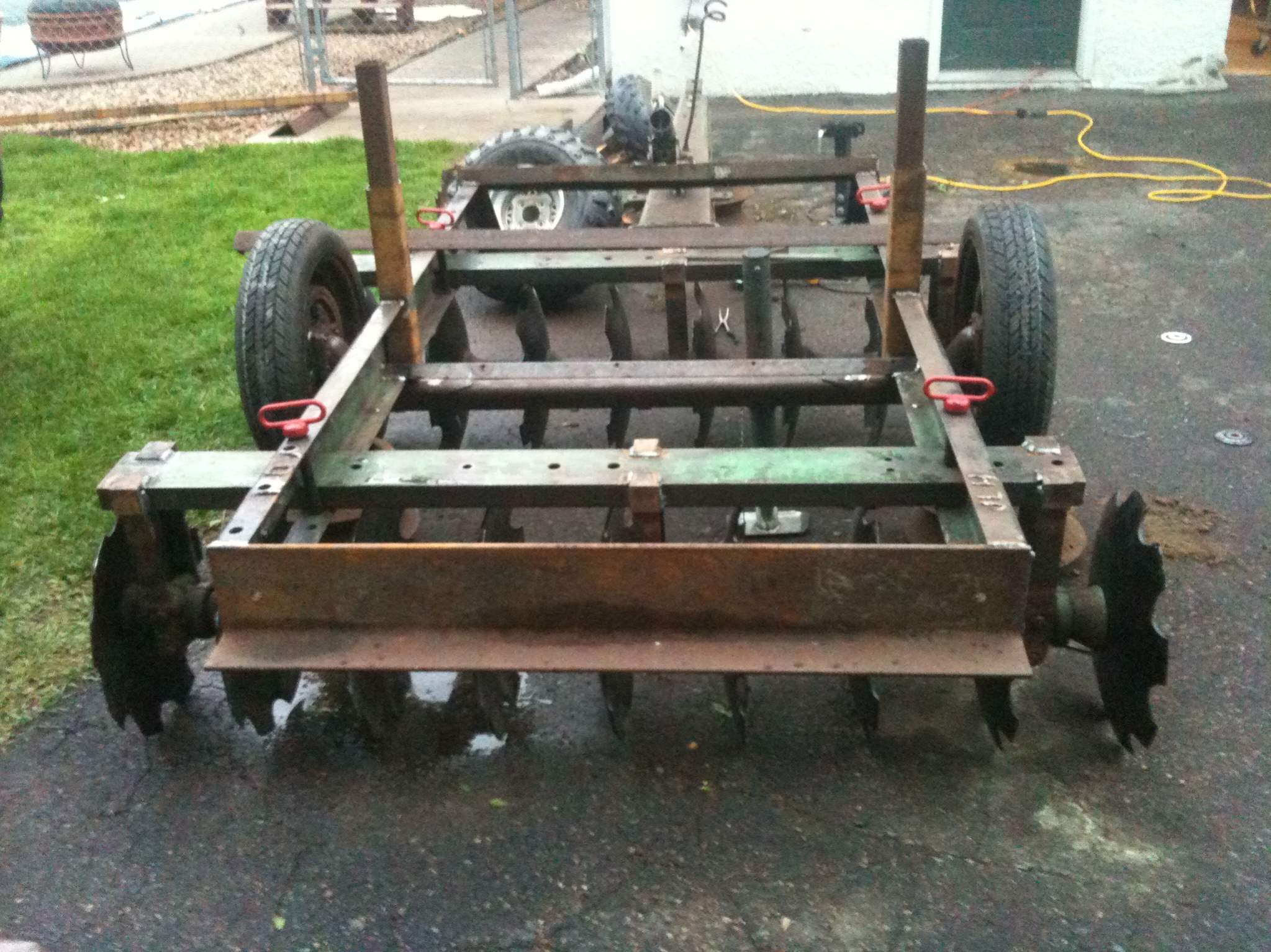

   / Off set disc

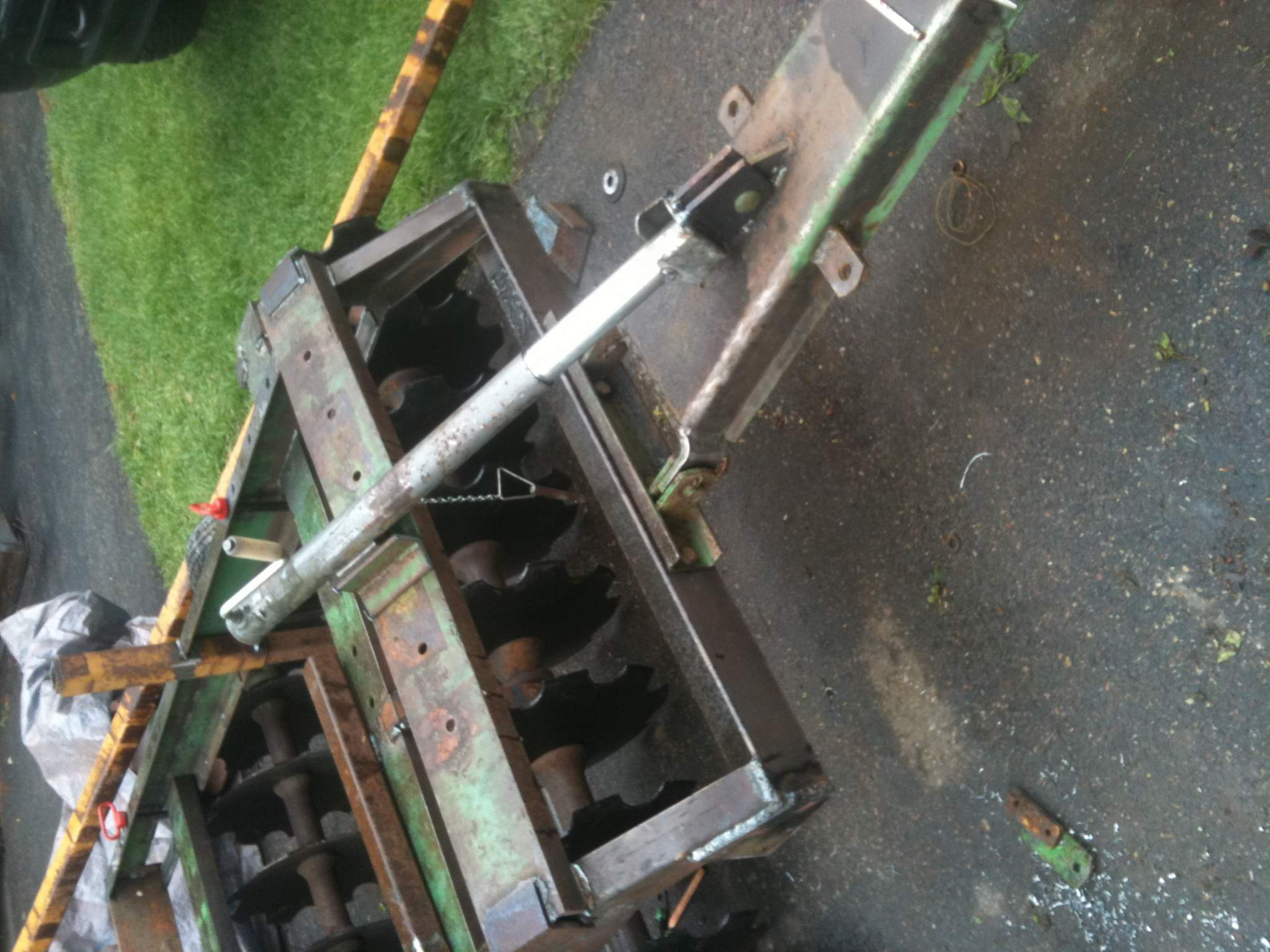

here it is with the disc gangs on it
   / Off set disc

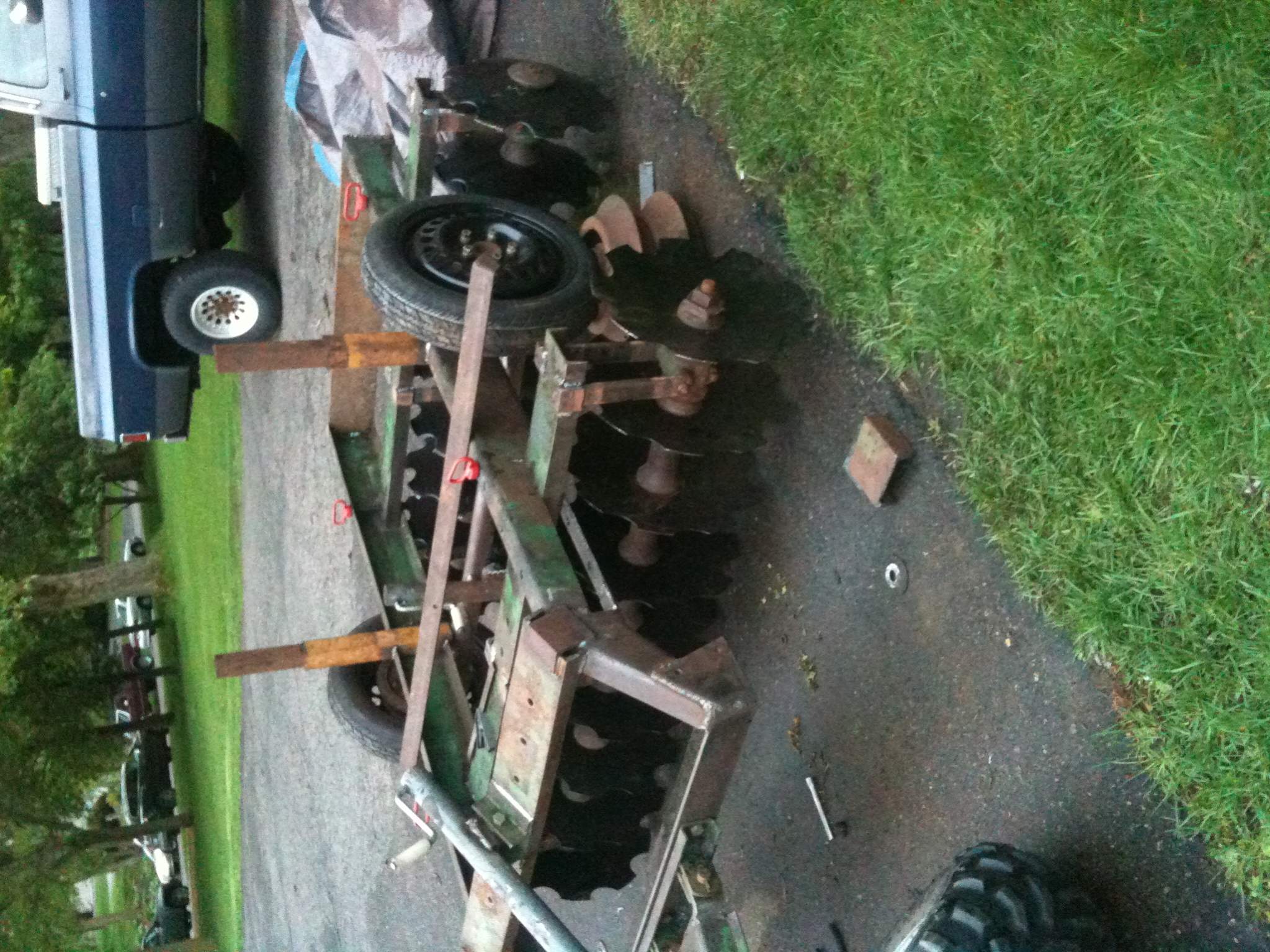

Here the gangs are opened up. I still have to get the cat 2 top link on to set the weight distribution betwen the front and rear gangs and the wheel set up for transporting it.

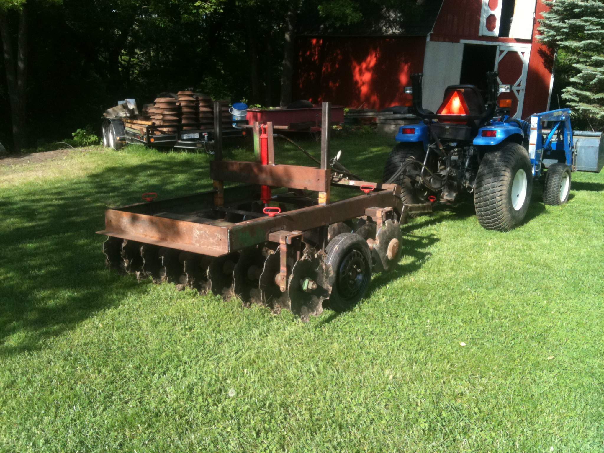

Here are somepictures of the build again, its all done now

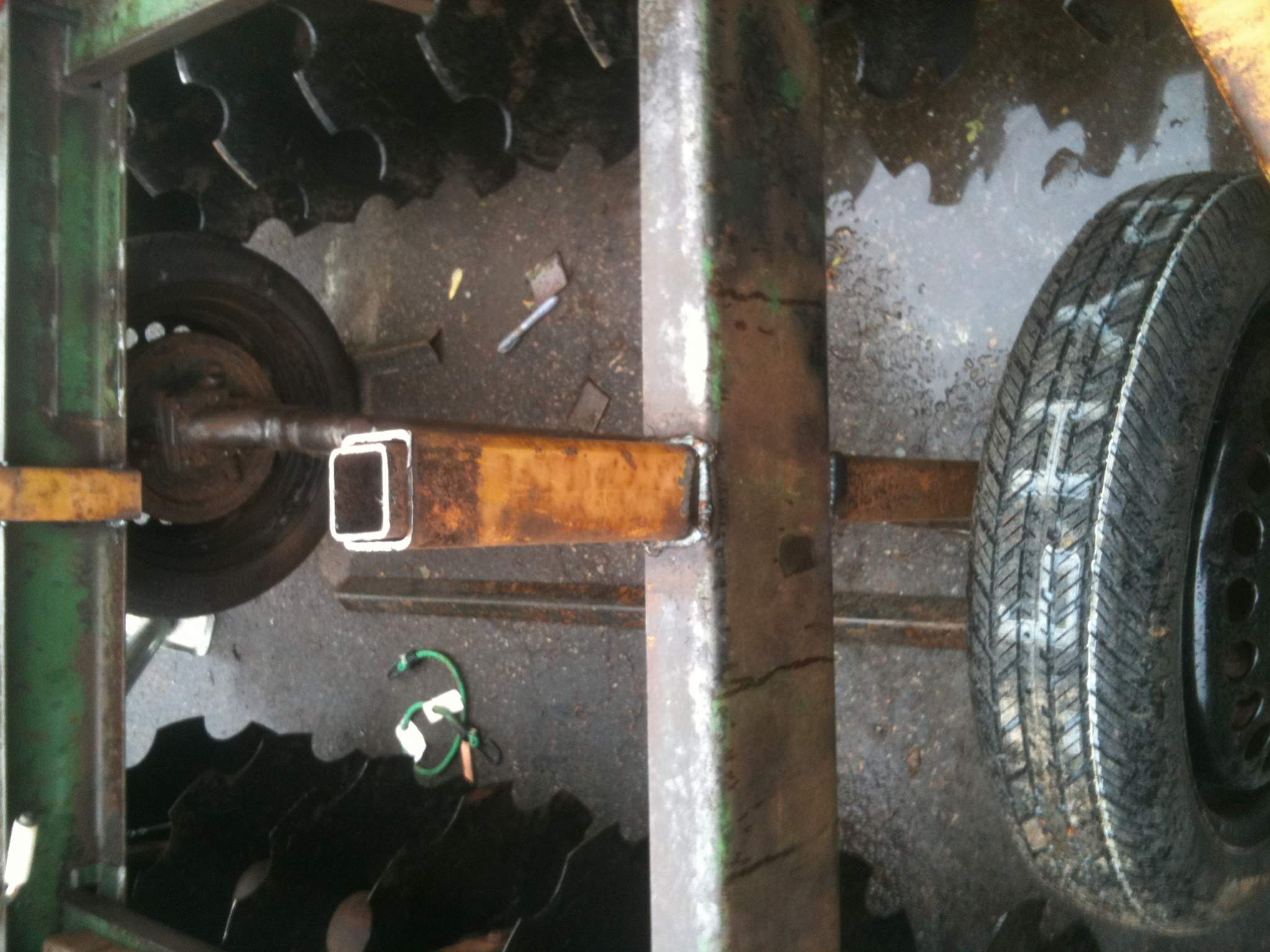

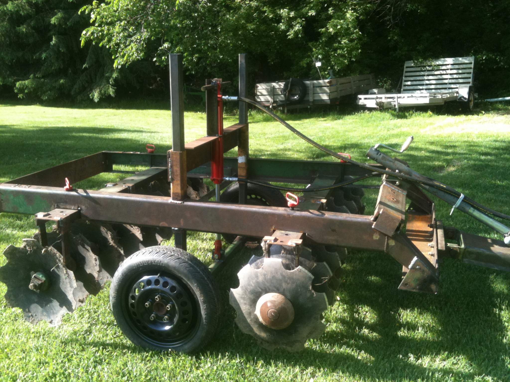

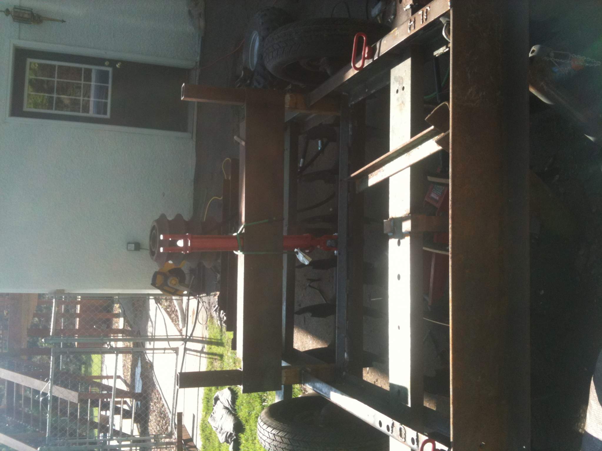

   / Off set disc
the hydrolic ram for transport
   / Off set disc
behind the tractor ready for the maiden voyage,still has to be painted.
   / Off set disc

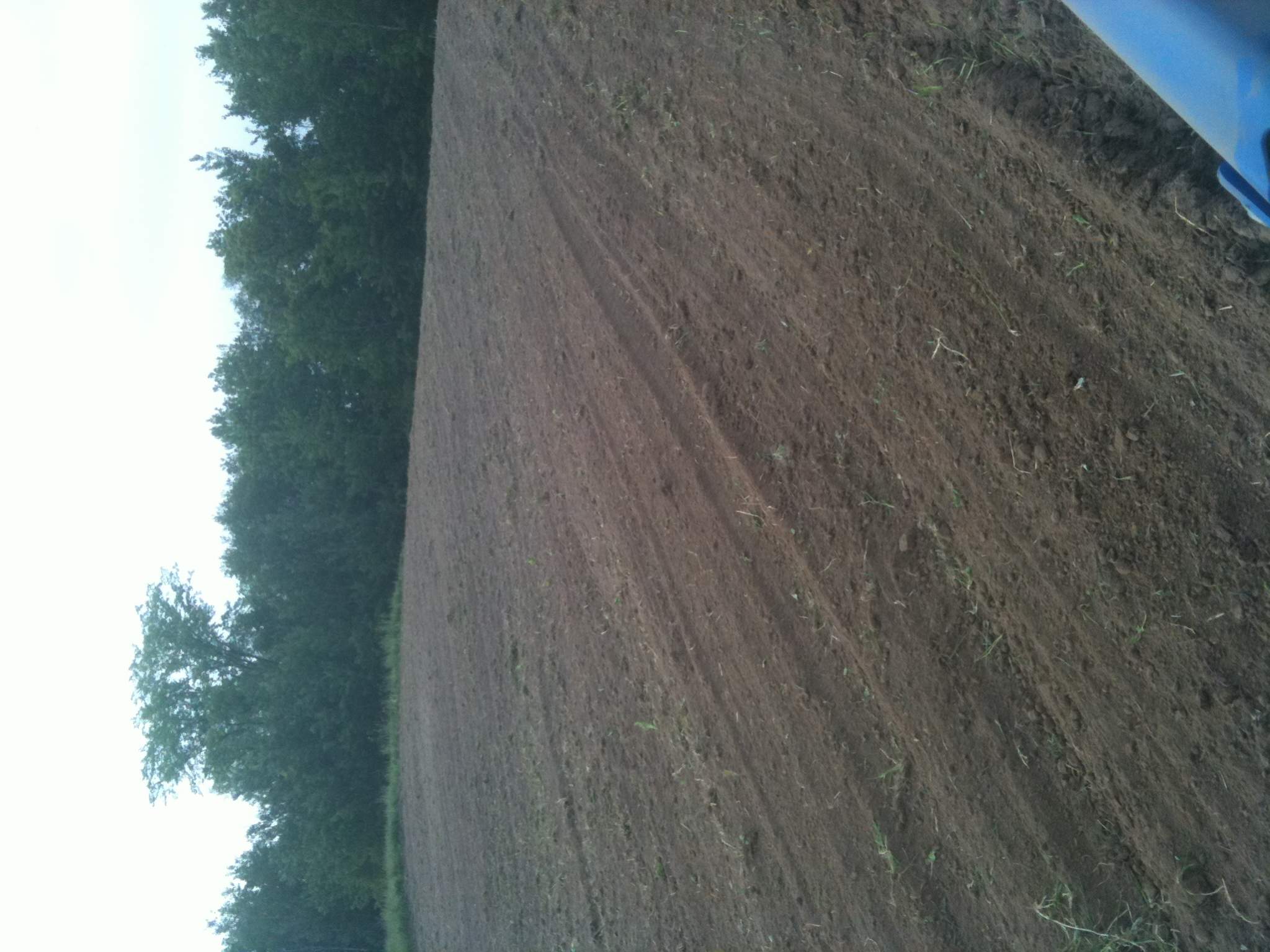

#9
seems to work ok!
