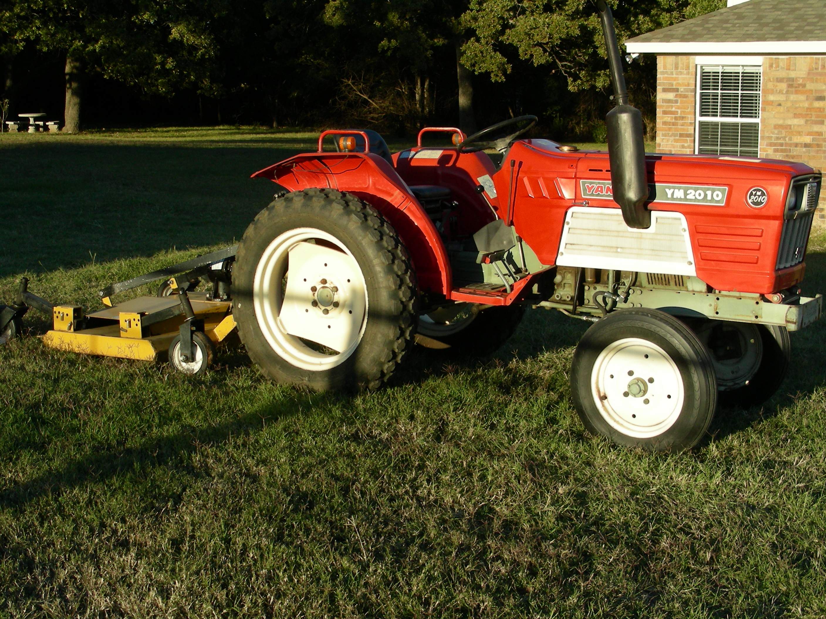

got the yanmar ym2010 haven't had a chance to really run it yet too cold. should i run regular diesel or off road diesel, thanks.

Yup what he said only the price and color I use red because I can. :D
/ off road diesel or regular diesel #3
I'll repeat what the others said. there the same thing only difference is that the offroad is dyed red to be used in non taxible senarios, like off the road applications like marine applications, generators, dirtworks equiptment and ag applications. So there is no tax on it.
That being said, in the past and still in areas where i live offroad deisel is Low sulpher deisel(150ppm) and on road is Ultra low sulfer deisel (15 ppm). Both are ok in your tractor as it was designed to run on high sulfer deisel. The off road is prolly better as it has more lubrication qualites and more energy per gallon. But no need to worry or ask and frive all over to get it the ULSD is fine.

thanks for the help. wasn't sure if it could be ran off this ulsd. i use both in my mitsubishi, just depends on if i can get offroad or not sometimes its hard to comeby around here. :thumbsup:

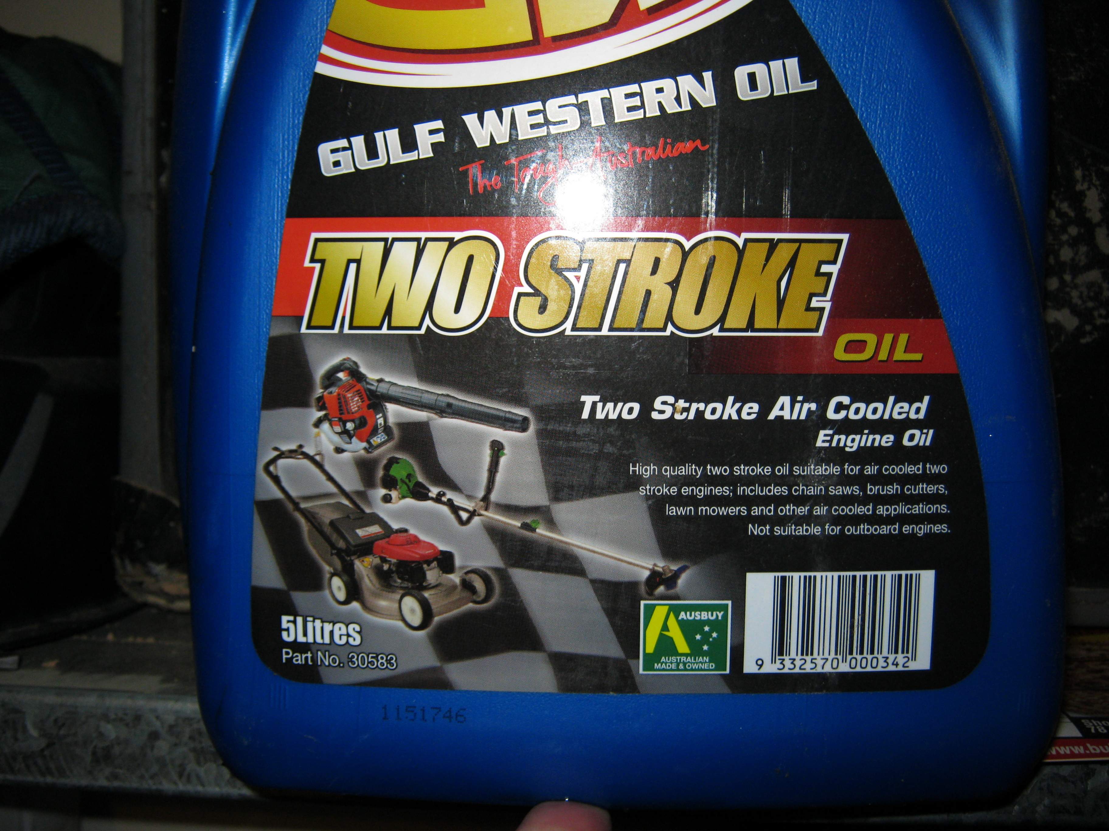

even cheaper way to do it, run 300:1 of 2 stroke oil in the diesel. i do this for my landcruiser,1500 and now the YM14. takes care of low lubricity ULSD.use the non marine type also.

I should have said standard 2 stroke oil, not non marine:eek: as i have been told it has other additives( non corrosion and water dispersant detergents) in them as well which for the Landcruisers and Yanmars is not required or recommended. i was reading alot of literature from 4WD clubs here in Australia about the use of 2 stroke oils in ULSD some years ago after it was introduced and most agreed this was a good ratio. they were also speaking to some oil guy who really knew what he was on about, also there were some older guys who had been using 2 stroke oil in their old diesels for 20 or more years an reckon it has helped prolong the pump and engines life no doubt. my Landcruiser had a major pump failure in 2006 which was possibly caused by lack of lubricity, the pump ground itself to bits and over/under dieseled and caused a crank break, new motor and pump thanks:mad: and after that most recommended i run 2 stroke as it does not do many miles and i think it is also quieter in operation so i will stick with it i thinks:thumbsup:
/ off road diesel or regular diesel #16
heres what i have been using for a few years now,$18 for 5 litres. it lasts me more than a year.
