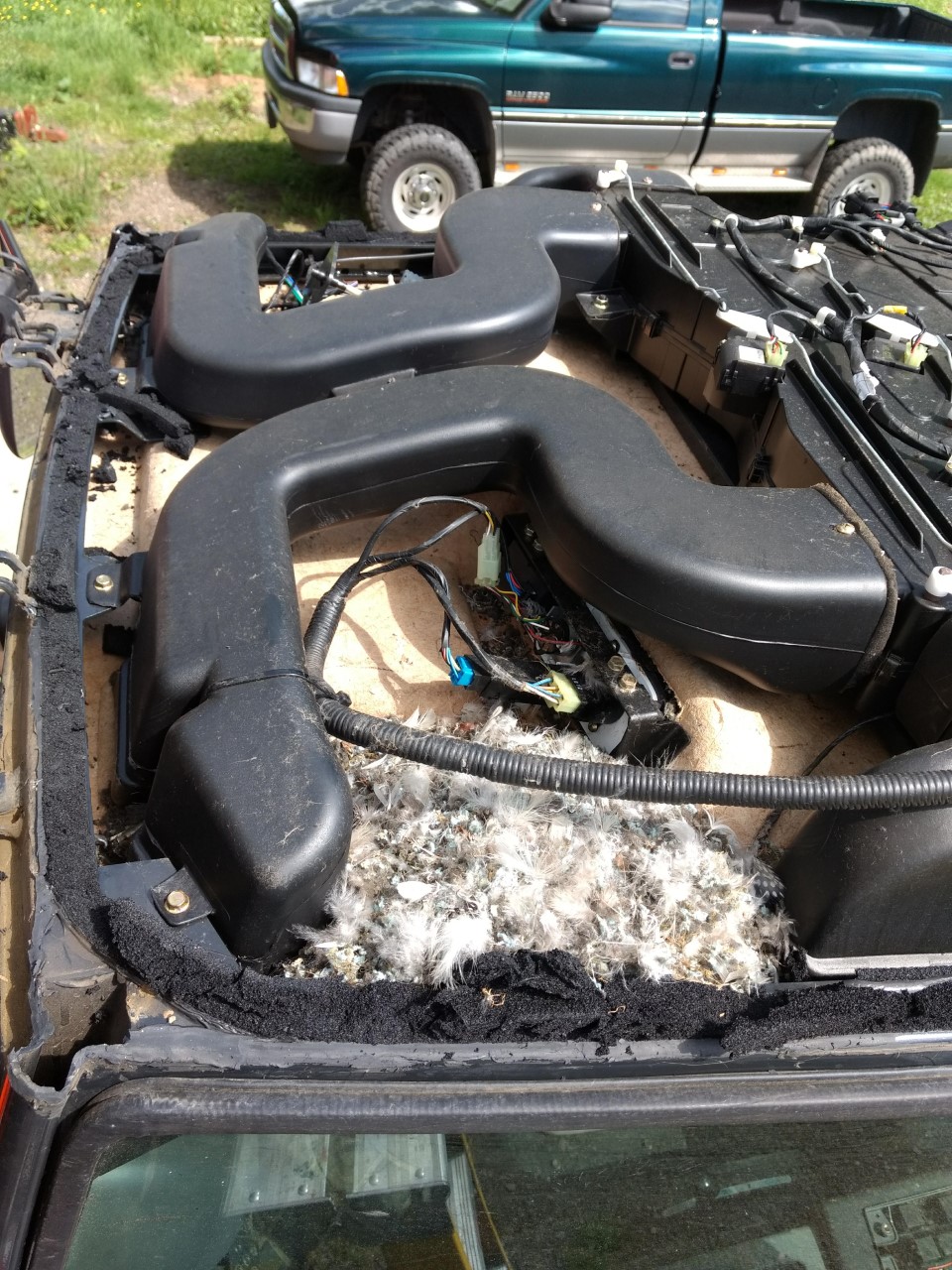

Here's a pic of the scene of the crime:
Have not done full forensics yet: I'm still thinking that it's the rear pillar where a wiring harness runs up from the fuse box/tray: I think I can access it from the bottom side such that I can jam some steel wool into the hole. Nor have I fully looked into the cabin fan issue: no obvious signs of damaged wires, thankfully.
While things are opened up I can finally secure the rear mount of the stereo: I didn't do it during install owing to the dealer having RTV'd the lid (which is going to ring up a good 6 hours or so of additional work time [to remove the lid and to then clean everything up- it's a massive mess, as I document in this thread]).
