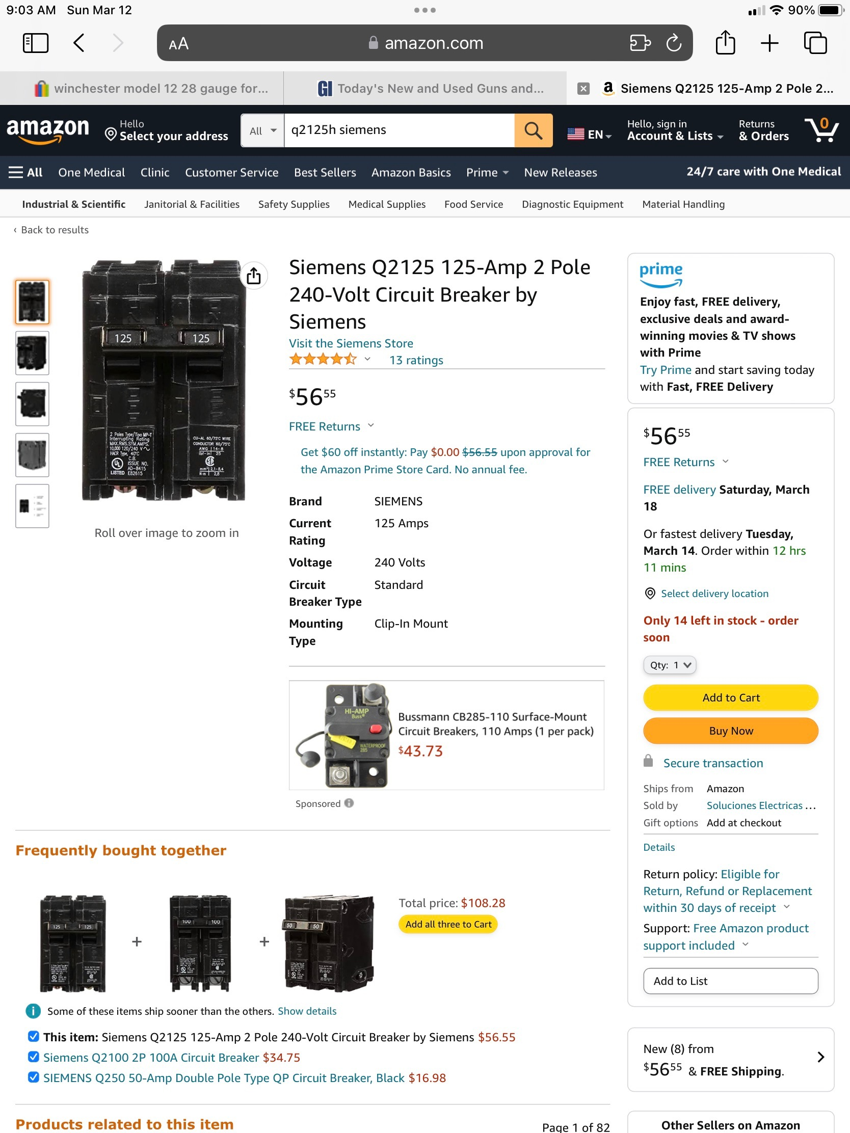

Thank you Scott, appreciate it
This one is UL advertise. Cannot see CSA on my phone

If you get the breaker from Amazon shown in the pictures then you have a good deal. All of the pictures and spec sheet match the ones from Home Depot.
