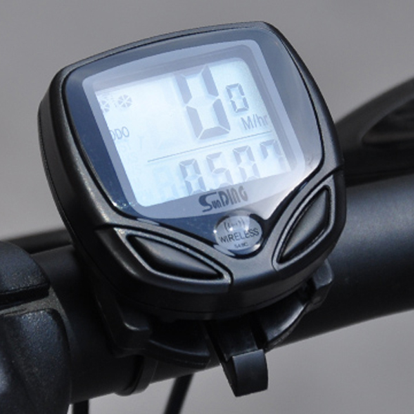

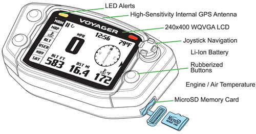

How about a GPS Odometer for a bicycle or ATV.
Free-Shipping-Wireless-LCD-Waterproof-font-b-Bicycle-b-font-Odometer-Speedometer.jpgvoyager_drawing.jpg
