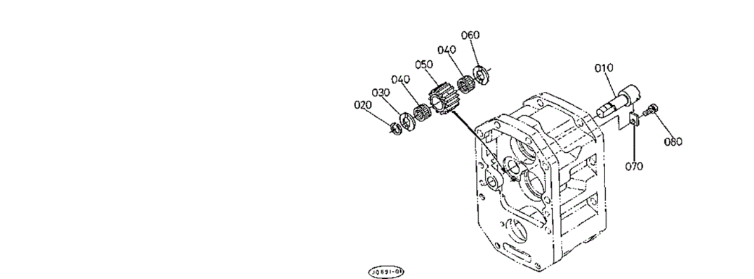

The part I am lacking is the final lever for the forward reverse shifter going into the transmission. About a 30 spline connection with about a 3" arm. Just wear in the spline after so much shifting.

From Messicks: "Dear Customer I regret to inform you that part 32430-23280 LEVER, SHUTTLE is no longer available thru Messicks or any of our obsolete vendors. Your order has been canceled and your credit card has not been charged. We are sorry for this inconvenience."
Same response from my local dealer. Tried looking for parts tractors but struck out and if I had found one possibly run the risk of a part similar to mine due to wear. I may just ID the spline and make one myself.
I found a work around for now but finding the correct new part would be the ultimate solution of course.

OK. I went to Messicks and see the part. My guess is that a temporary fix would be to drill and tap the lever and put in a socket head grub screw (set screw) to tighten the splines. Of course that messes up the splined shaft that the lever fits on....
What's more interesting is that Kubota uses that same lever on 16 different GST models including some later ones. AND that on several of those models there is a serial number break. Photos show that the serial number break was to add another leverage point to the lever when used on different models....and a new part number. Same price & looks to be the same piece.
New serial number is nearly the same; only the final digit is changed: 32430-23283.
See the inset to the right on the photo below for the L3450DT-GST.
It might be worth seeing if they have that one. I'd be willing to bet $42.10 it's the same part.
How is the shaft # 090? Is it usable?

A couple weeks ago I did EXACTLY as you suggested but I added two 1/4-20 cap screws with locking nuts and sacrificed the potential damage to the shaft thinking if I found the part in the future a die grinder would easily remove the damage. Great minds think alike!!!!!!!!! :)
Shaft appears to be fine as it is the harder of the two.
/ Obsolete parts #19
IIRC, if the last digit is the only change, IE from 0 to 2 or 3, it should work. It is a factory part update to the original part.
/ Obsolete parts #20
It appears that the spline is the same on the two-part numbers so the worst case would be to cut the arm from the old splined hub and weld it onto the new splined hub.
