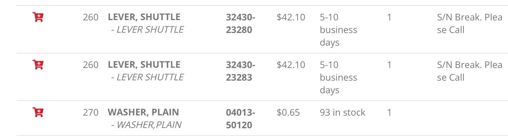

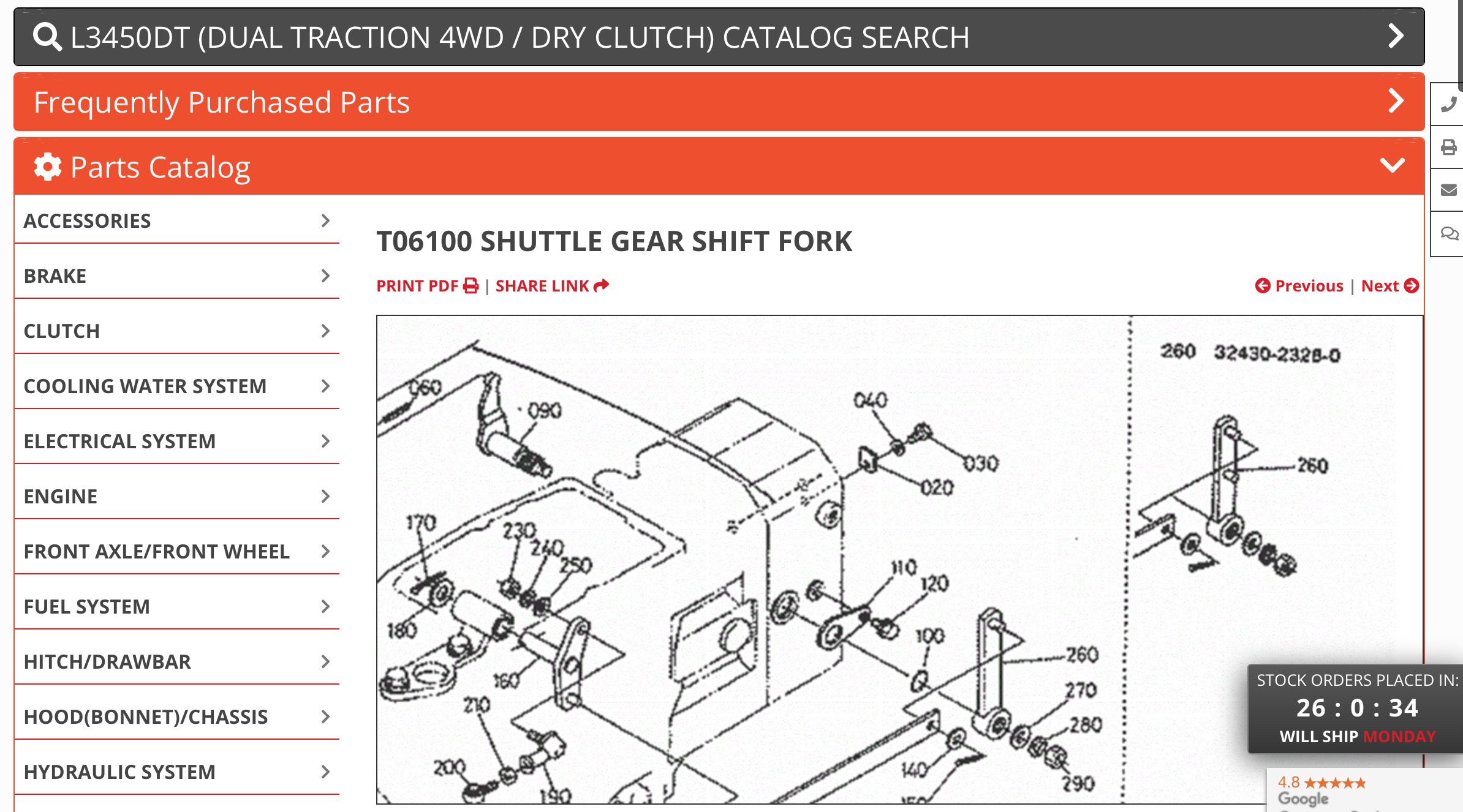

On my L2550DT, with the glide shift, it is sad when I need a piece of transmission linkage and I get the response after I find and order it online of "part no longer available". Hmmmm.
Can it be repaired?
/ Obsolete parts #23
If you have the part number, go to eBay. I was able to get some seals for an EX60 excavator when John Deere told me they didn’t exist.

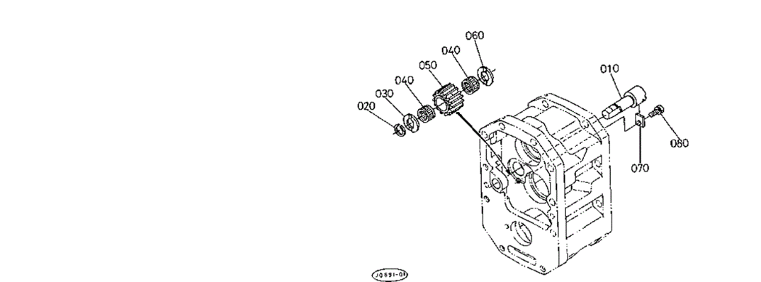

Hm... a short splined shaft with worn splines. That's a stinker. Machinable, but not a simple job. I see you gave a part number. Gotta go see what it looks like for myself.
