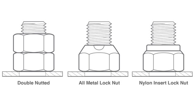

Nyloc is trademarked in Australia. Good for a few cycles but generally does not meet NASM25027 Standard for self locking nuts. 15 cycles is considered minimum for reuse. Also okay for room temp applications but not good around heat sources such as combustion engines or compressors. Again a minimum standard is usually 450degF. the Nylon is good up to 250degF. Also, long term exposure to UV will deteriorate them.
Around the house or farm... acceptable... on an airplane... No. That said, I use them on some projects instead of Loctite but I have way more faith in the Loctite.

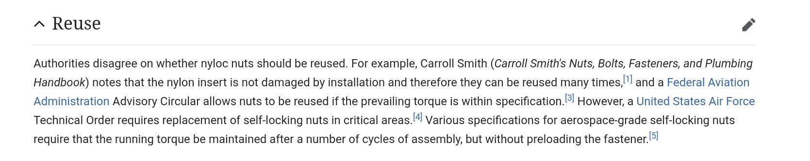

These on anything critical
https://en.m.wikipedia.org/wiki/Distorted_thread_locknut

Nylocs are okay for non heat environments if changed out regularly. I do not trust plastic to hold up all that long.

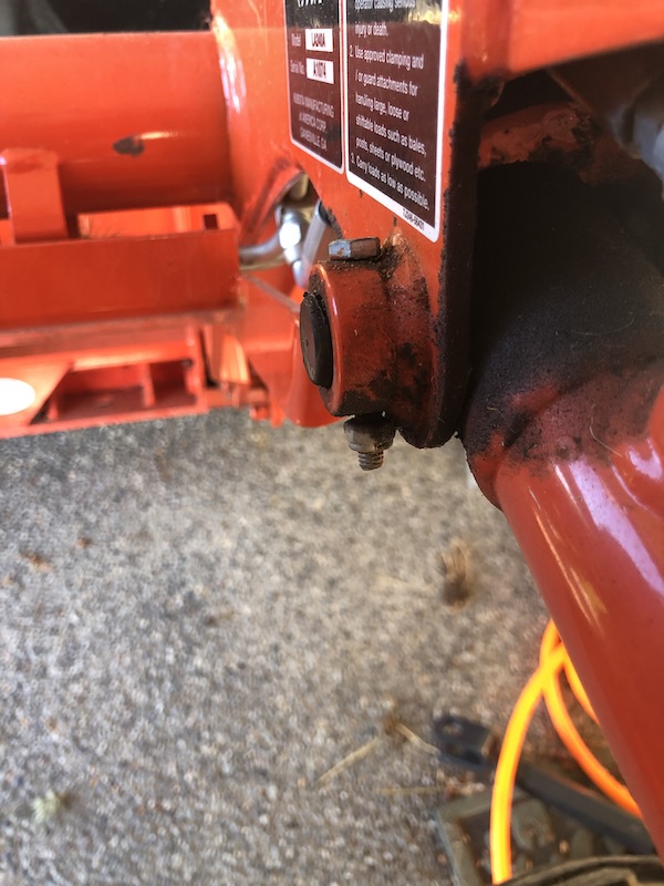

These nuts came out years ago, they seem to have nylon or something on the threads which I guess acts as a lock nut?
I think they are great but, if you don稚 tighten them, why use a nut.
I have probably 8-10 between the fel and bh, all the same. The nut is at least 1/8th inch from making contact, not even close to clamping down.
I don稚 care but, again, if you are not going to tighten the nut, why use a nut and bolt?
I bet there is a good reason, I知 just curious.
I can't think of a good reason, can you? Other than pure forgetfulness that is.... You seem to be asking, "would they work untightened in the same way as cotterpins where the bolt is being used as a locating pin?"
That's a good question, and the answer is I don't know for sure. Nylocks do have a repeatable non-zero threading torque, so I can see where they might. But it would depend on the application.

Here痴 a photo of my nylanut issue. I guess there are 8-10 of them between the fel and bh and they are all identical so, I figured it was done that way on purpose.

That bolt and nyloc nut is just to keep the pin from rotating ,
the nyloc is just to keep the bolt from falling out.
No reason for it to be any tighter it is not in a location requiring any specified torque on the bolt.

I agree. That bolt is being used as a pin, and the nyloc is serving the same purpose as a cotter pin would. No reason to tighten it.
So we solved a mystery and most of us learned a bit more about Nylock nuts. Not bad....

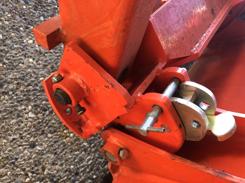

Finally got some seat time in and thought about this thread. Found at least 6 threaded pins with Nyloc nuts on the FEL. All were attached and with a fair amount of gap. At least one looks like there is no thread protrusion. Will have to inspect them all next time out, and tighten as necessary. If I do have to tighten them, I will put on some blue loctite.

My guess is the one you had that fell off was never tightened into the nylon in the first place. Why didn't they use another method to secure the pin? Because bolts and nylon lock nuts are a great way of securing that pin (if done properly). I would prefer this method over roll pins, castle nuts with cotter pins, double nutting, locktite, smashing threads, lynch pins, or any method I could think of that would be used an alternative.
/ Nyla nuts #37
Not me! And I am saying this while my business is centered around plastic aerospace fasteners.
Nylocs are a sexy locking fastener and I use them a lot. But they are not as capable in high vibration, heat, or chemical environments. And a combination of environments makes these poor. That said... good enough for your tractor... absolutely!
