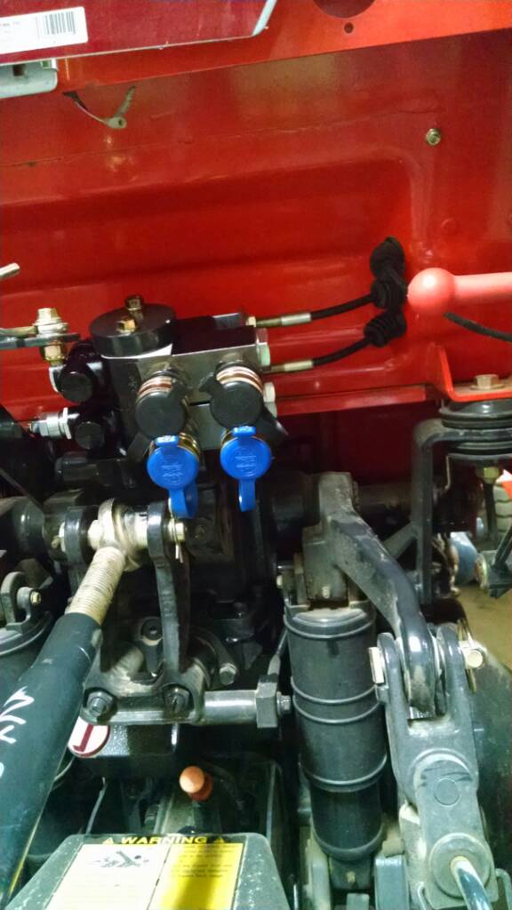

You want the rear remote kits. Just like everyone is saying, you will need them, they are inexpensive and easy to install.
/ NX5510H rear remote #8
I installed my kits myself. IMG_20170528_144617937.jpgIMG_20170528_144727820.jpg
