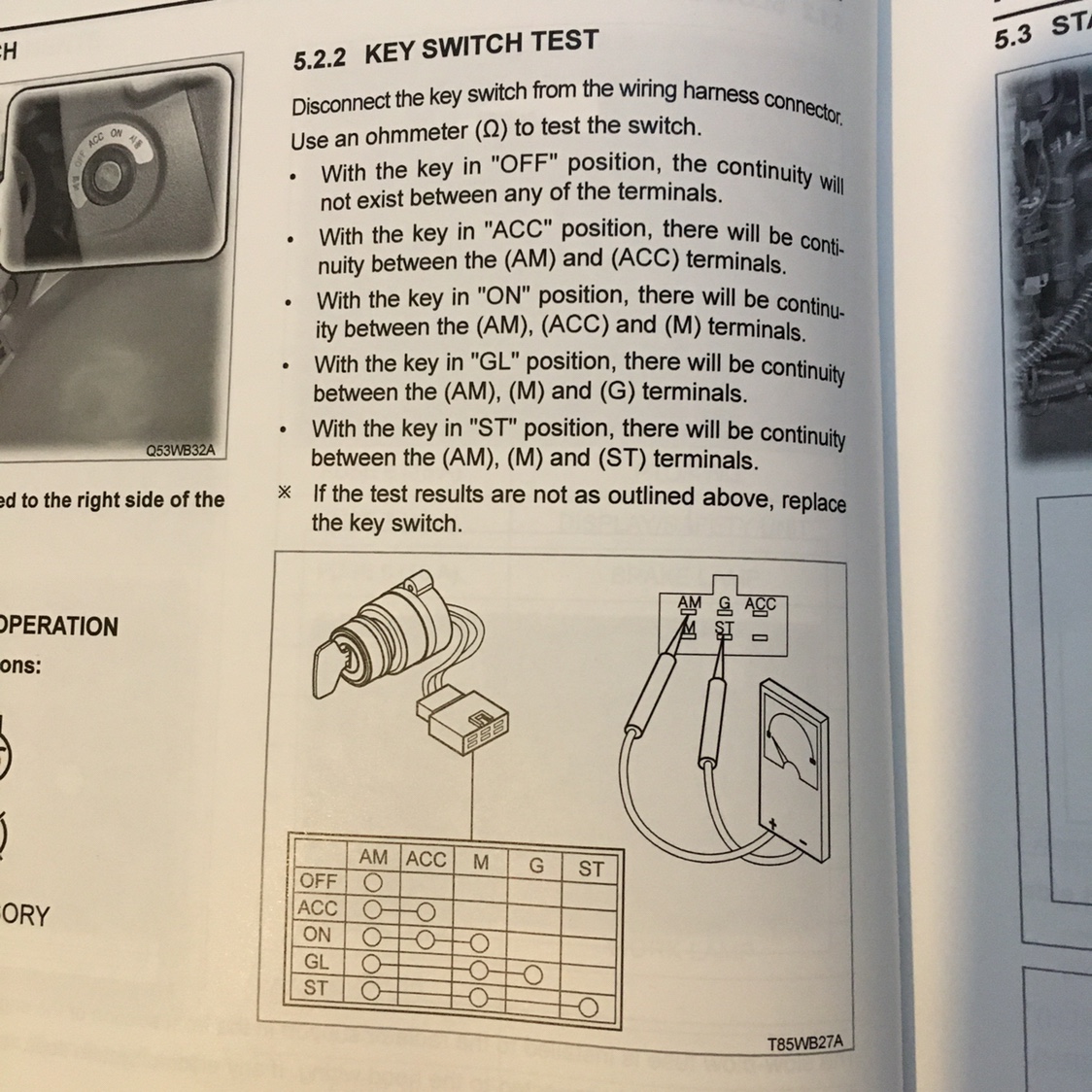

Have you completely tested the key switch? It has been problematic for some people. Here is the test procedure for the key switch:

Very good suggestion on the ignition switch. Unfortunately, continuity checks out and it appear to work as designed.

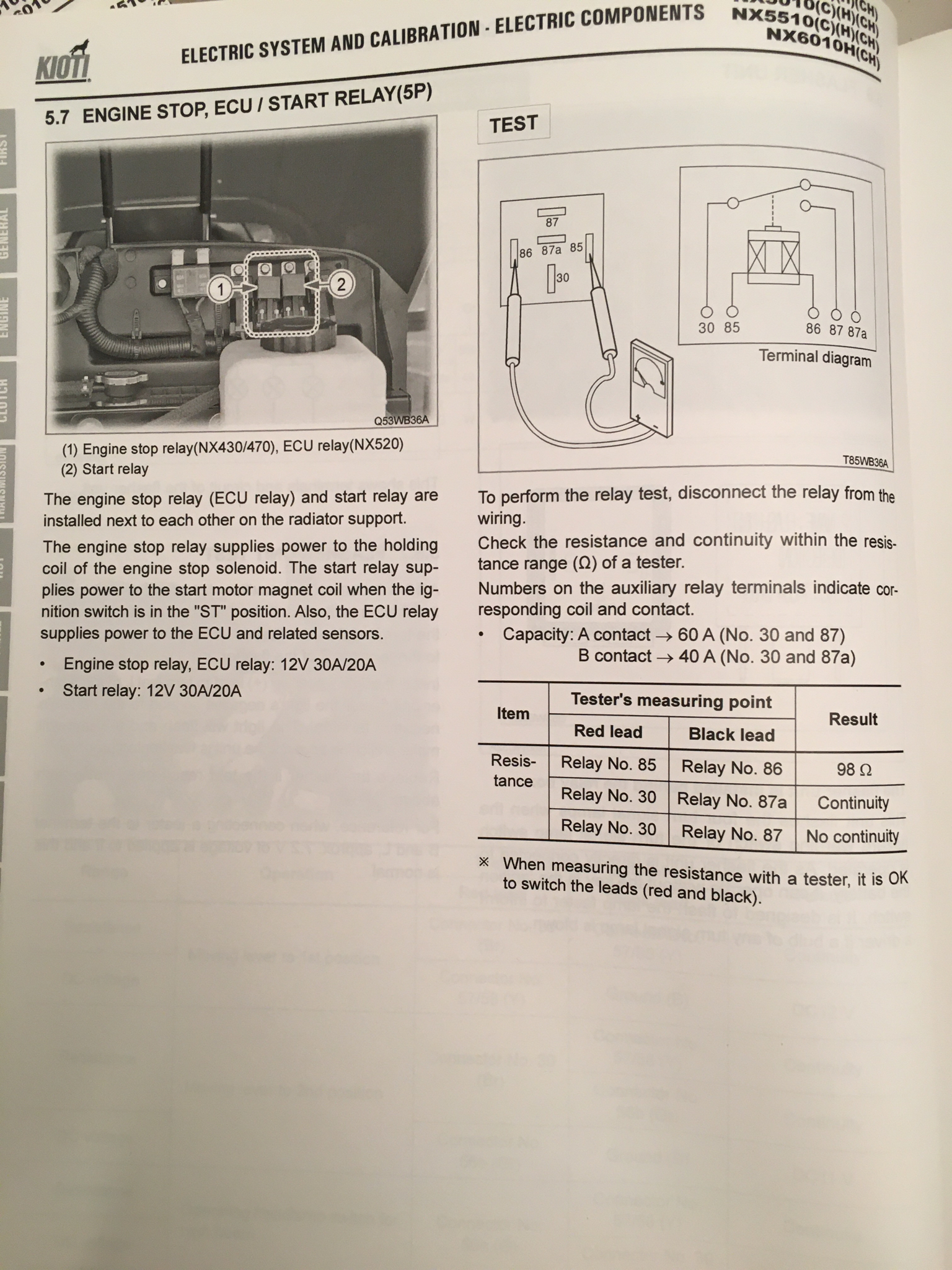

Also have u tested the engine start relay? (Procedure below)

Appreciate the suggestions, especially AWSubie with the workshop manual scans. I've tested all of the above with no love. Dealer suspects that it is a faulty relay control box (inside 'driver side' rear interior fender panel), they've seen a few low hour tractors with this issue. They are sending a new one and I will swap it out.

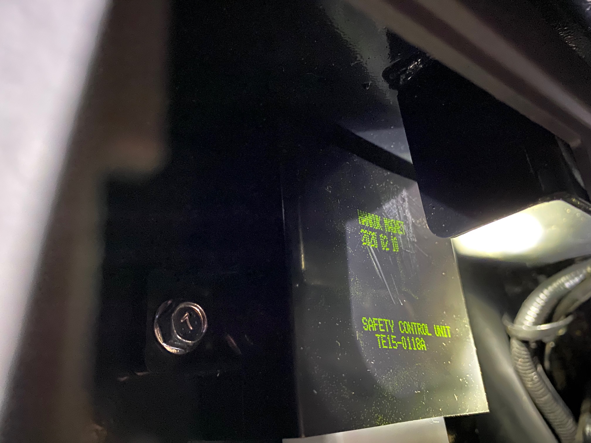

Well, that was a lot of troubleshooting for simple fix: turns out the safety switch module was faulty. Dealer sent me a replacement safety switch module and a quick swap solved the problem immediately. This is the small black box on the 'driver' side fender panel behind the seat (on NX5010 Cab).
Dealer says they've had this issue on several lower hour tractors recently. The module looks slightly different with a color 'filler' resin the new one red, the old one black.

Well, my 2020 production NX6010 HST with 47 hours just started doing the exact same thing.
Checked all the safety switches, can't find any problems. Checked key switch with meter, checks out ok. Checked out battery with battery tester (load test) checks out fine. Checked the ground and positive terminals. Checked every harness I could find. With key set to on, I can start it with a jump wire to the starter relay and it runs fine and functions normally, just can't start with switch. I asked my dealer to order me the safety switch module under warranty. My module is dated February 2020 and has the black epoxy filler.
