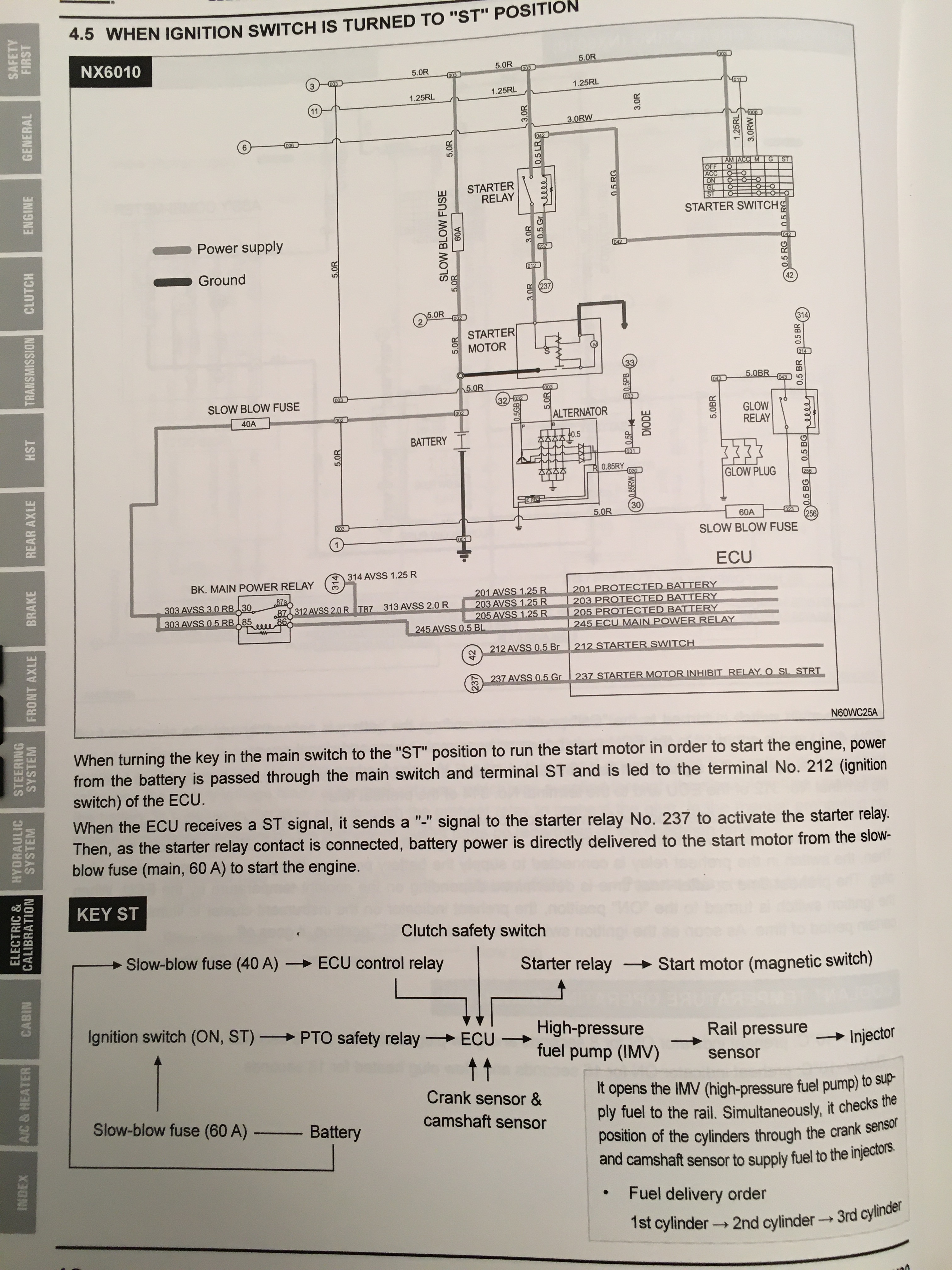

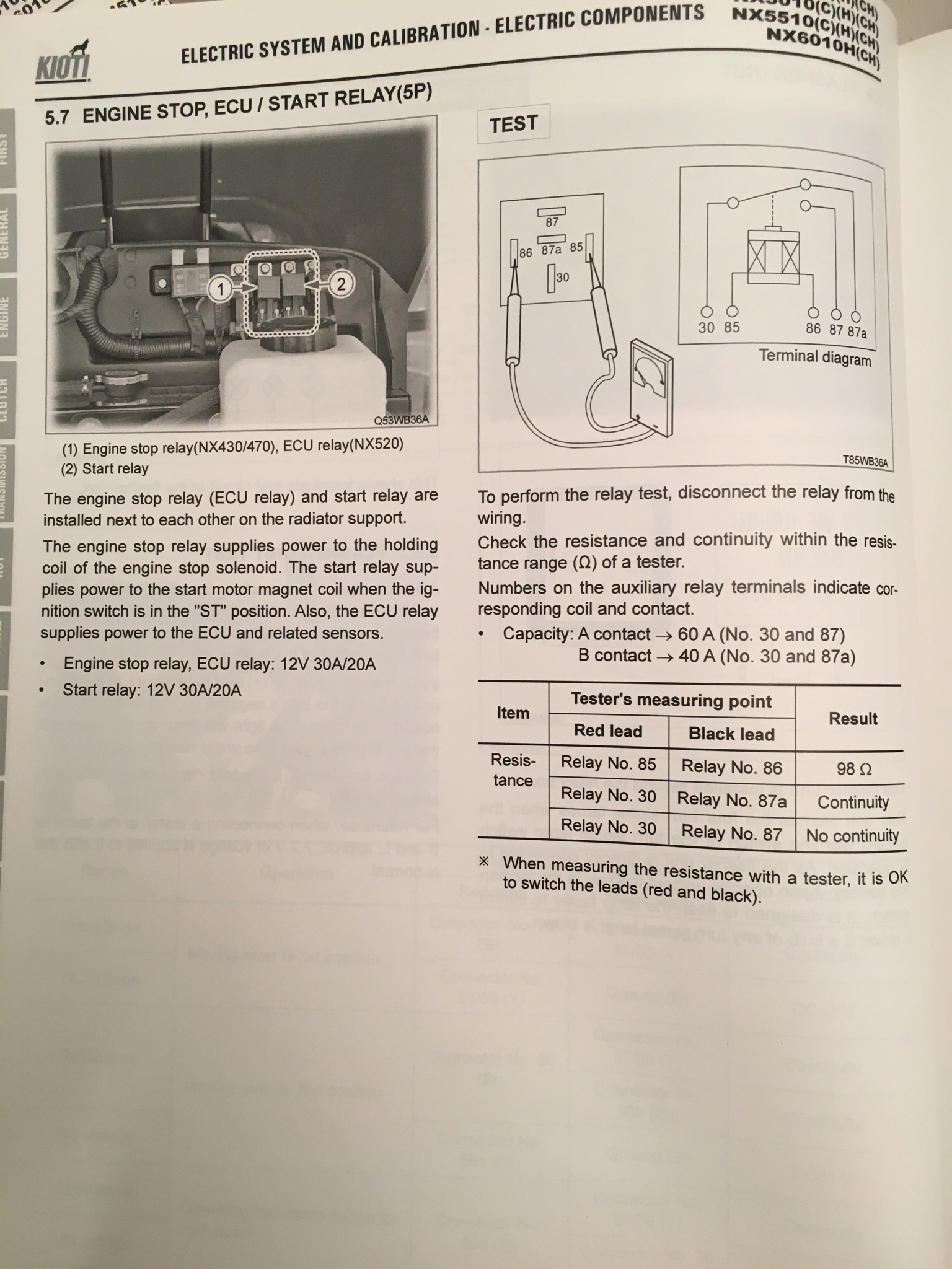

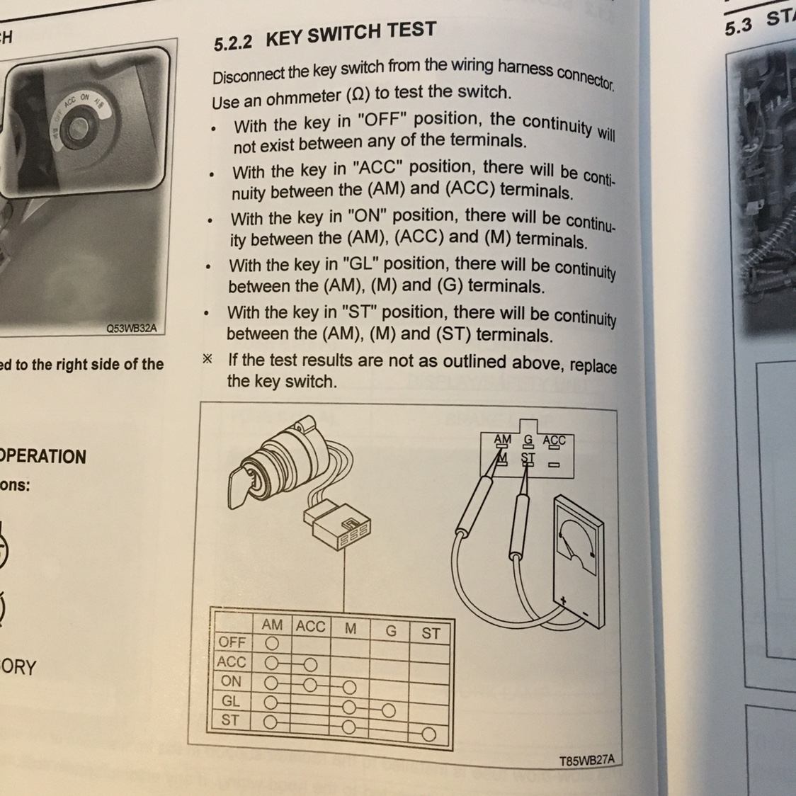

My apologies for wakening an old thread.. I have an NX4510 HST, with 28 hours on it... Starting last winter (at around 18 hours), the tractor wouldn't start. But I found that I left the key in 'run' for about 15 minutes it would start just fine. So, I kept doing that. About a week or two ago, it refused to start even then. I was able to get it to start by running a wire from the positive terminal of the battery directly to the starter solenoid. I was able to start it this way several times...
However, since this morning, when I do that, the engine turns over, but it doesn't appear to be getting any fuel. I was able to start it once this way, by leaving it with the key in run for 30 minutes before jumping the solenoid. But now it just turns over... I'm assuming all this is related to the safety module, but I'm at a loss as to why it would start by jumping the solenoid but won't now.
I'm out of the service range of all the local dealers and because I didn't buy it from a local dealer (none of them had any tractors at the time I purchased it...) none of them seem particularly interested in helping me even though I'm willing to pay the $300 for an in-warranty service call...

I replaced a bad key switch on my cabbed NX6010. It had baked itself. bought a replacement on eBay.
