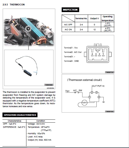

It seems there is a temperature sensor in cab roof. Until temp in roof rises to a certain temperature, the A/C will not turn on. This is to protect the system. After the engine warms up, and the sensor gets to the proper temperature, the A/C will then turn on. Sometimes this takes 20 minutes or so. Run heater at max to warm the roof area up quickly. I also have a 12v fan to keep rear window clear.

Kioti617, here is a post I made last month in another thread that might be helpful:
Attached is a description of the "Thermocon" operation in the NX HVAC system. If I'm interpreting it correctly, the thermistor's set point is nominally 32 F. So, if it senses an ambient temp in the roof cap below that, the AC relay will not switch on. Does that sound right?
Since some are reporting no illumination of the AC indicator light prior to warm up, the light evidently is wired between the thermistor and the AC relay, thus will not illuminate below 32 F. That seems a bit odd, though, as more logically I would expect it to illuminate whenever there is power to the thermistor. Then, as the roof cap temp reaches the set point, the thermistor would allow current to flow to the AC relay, while the light stays lit the entire time until the AC switch is toggled off.
But, then, I'm no electrical design engineer, so I may be all wet on all of this.

Thank you for your reply and very helpful information. I guess I will pick up a 12V fan to help the air movement. We have had weather cold enough that the sensor has not warmed enough even after 30-45 min of operating time with the heat full blast. Others stated that 12V fan did help.
