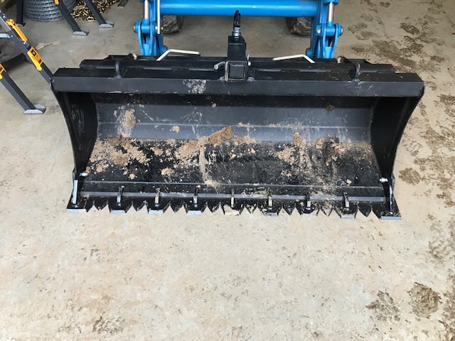

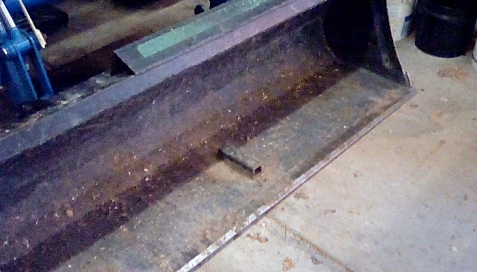

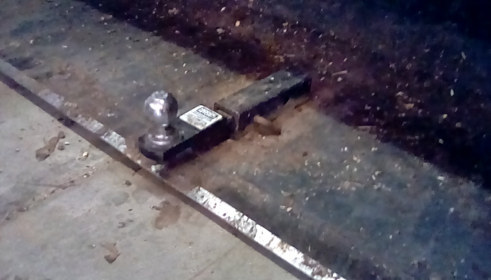

This is what I did, used the smaller 1.25" receiver tube, works good for moving trailers

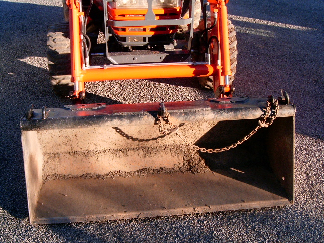

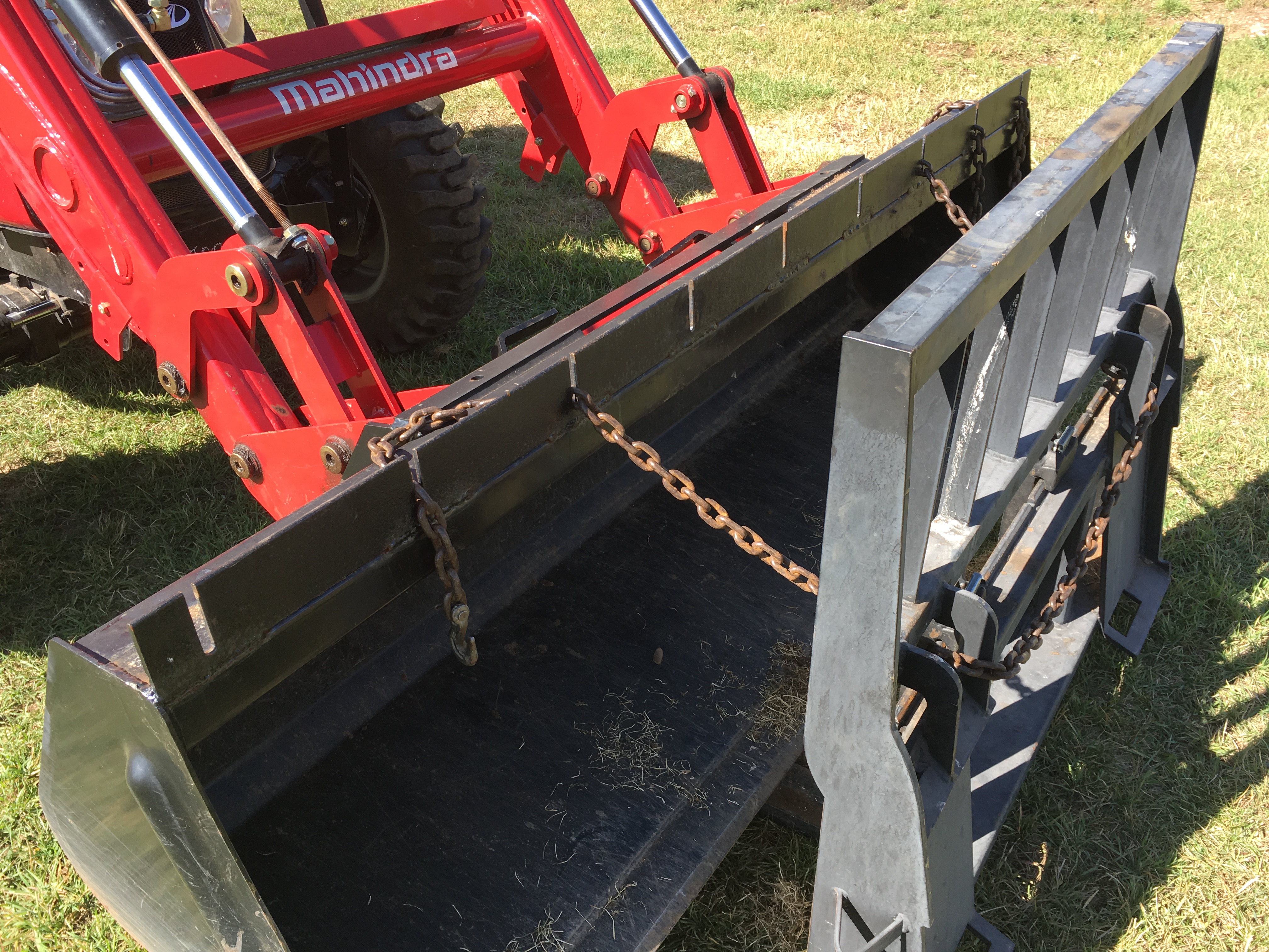

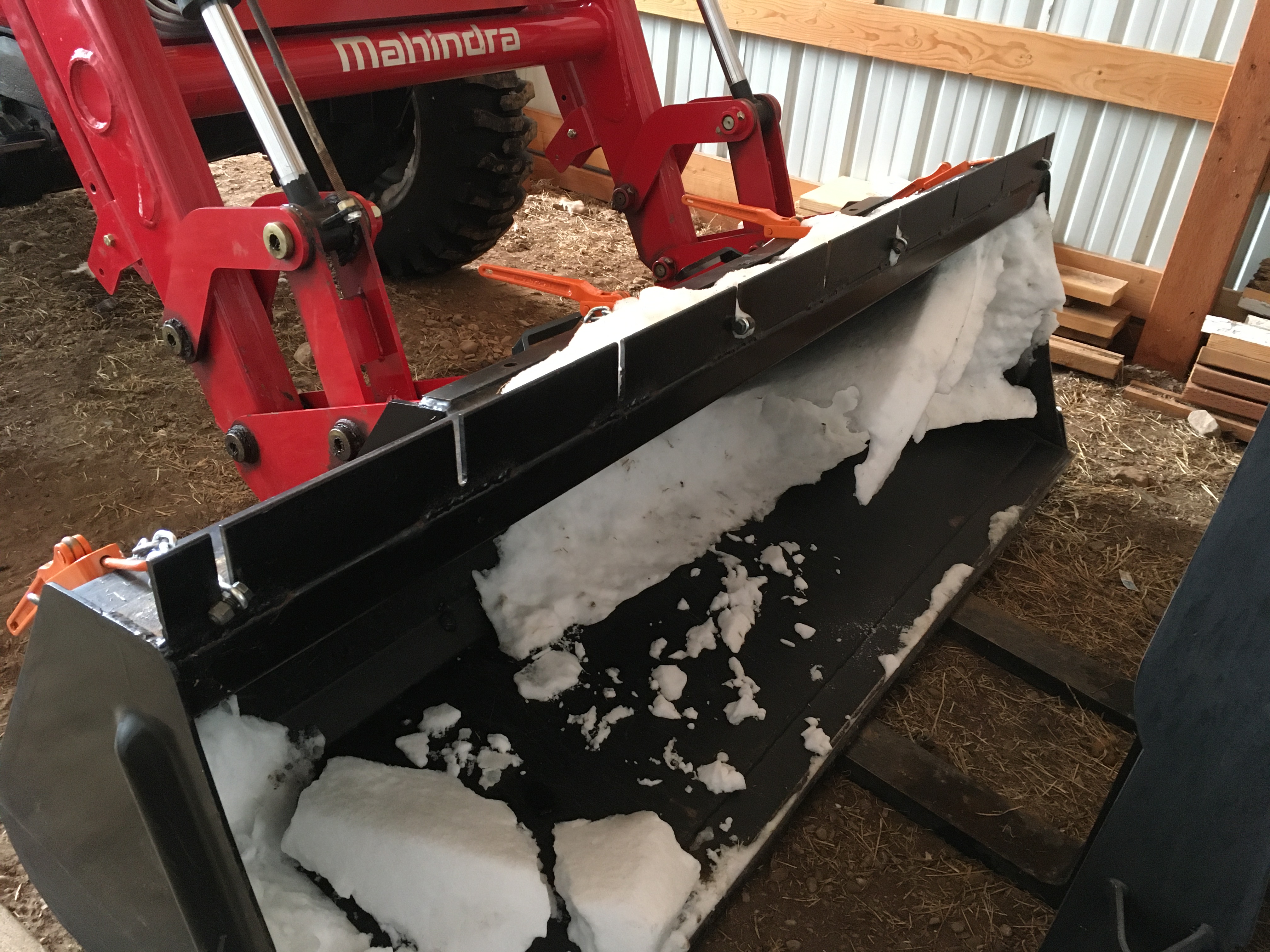

I always figured the more slots/hooks on top of the bucket the better. That makes it easier to center a load if needed or to just accommodate different things being lifted. Plus it gives you places to put the unused part of the chain so it isn't getting caught on stuff.

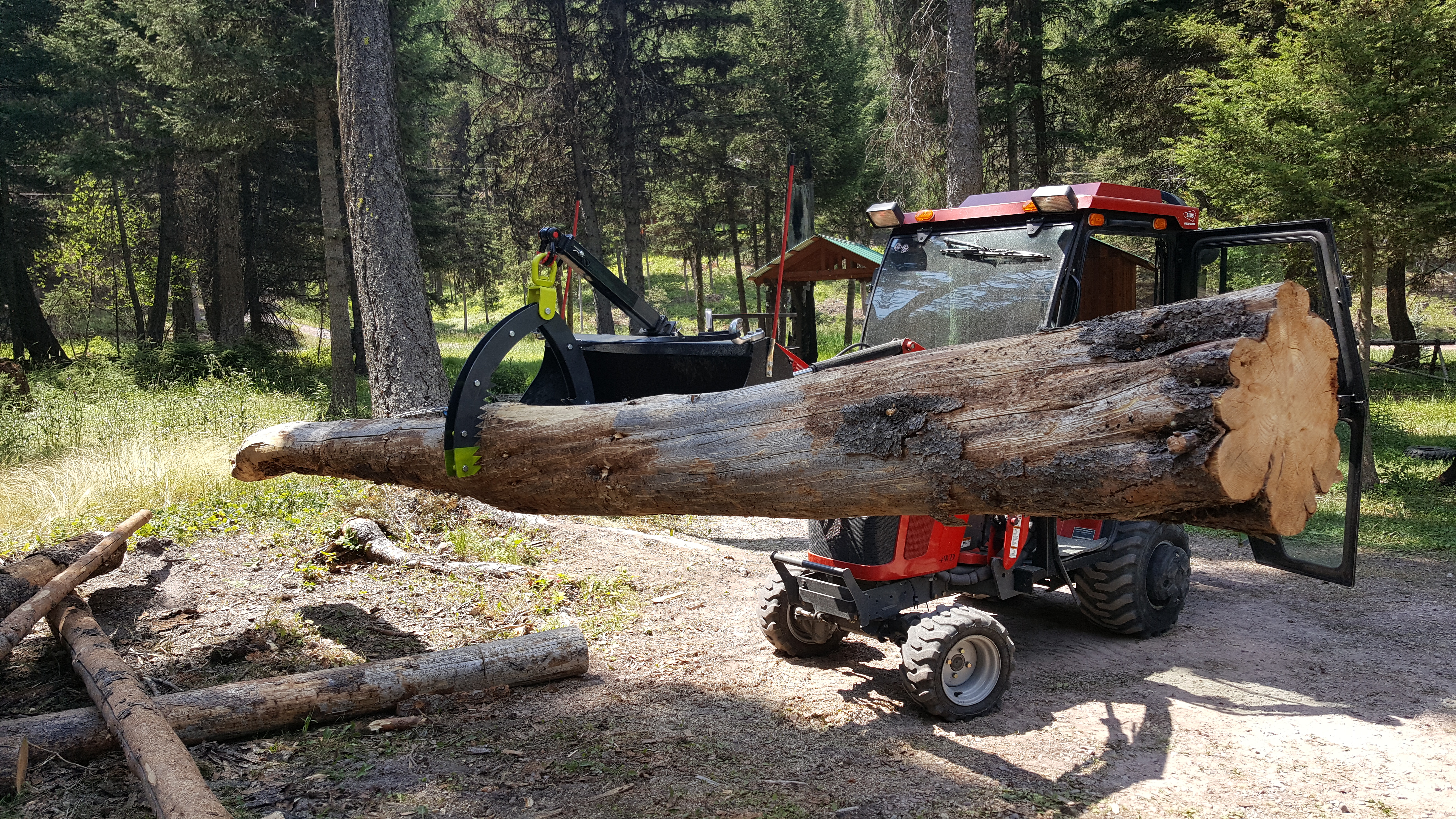

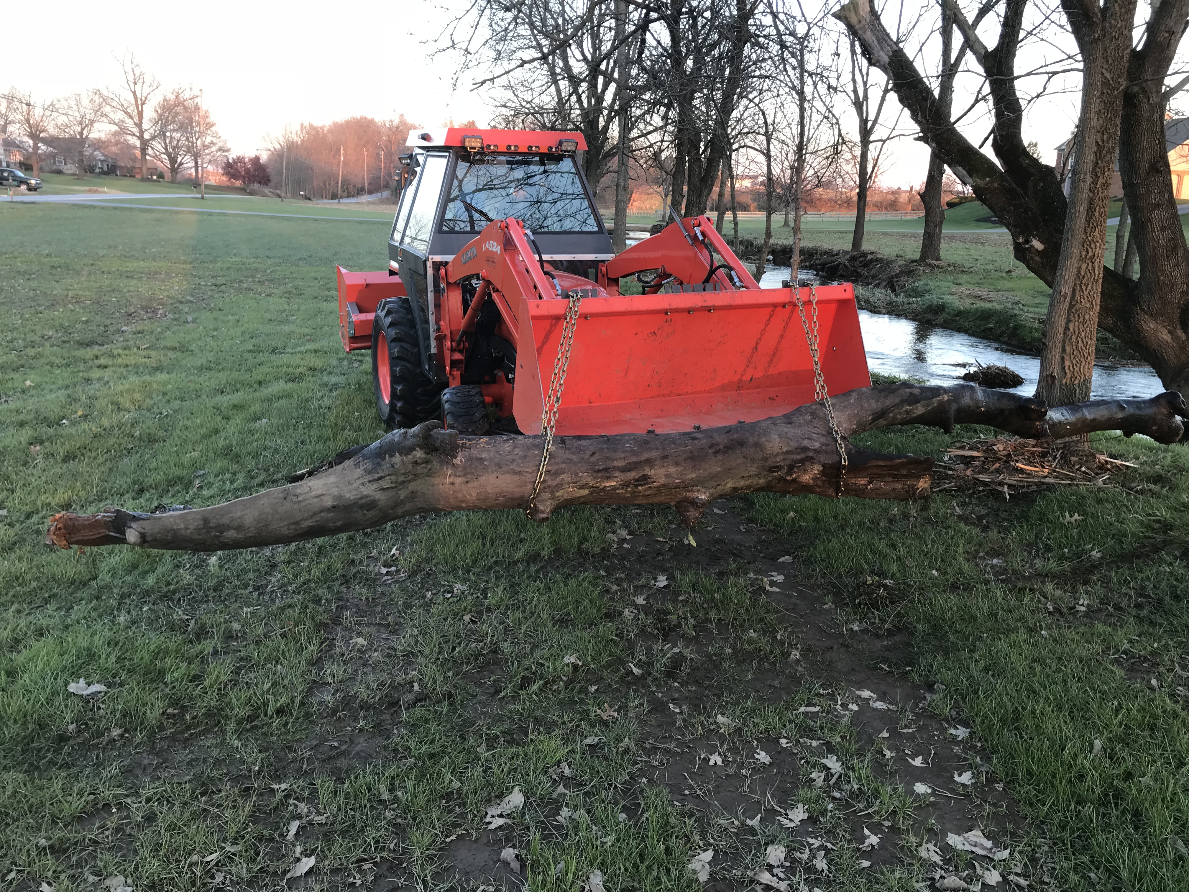

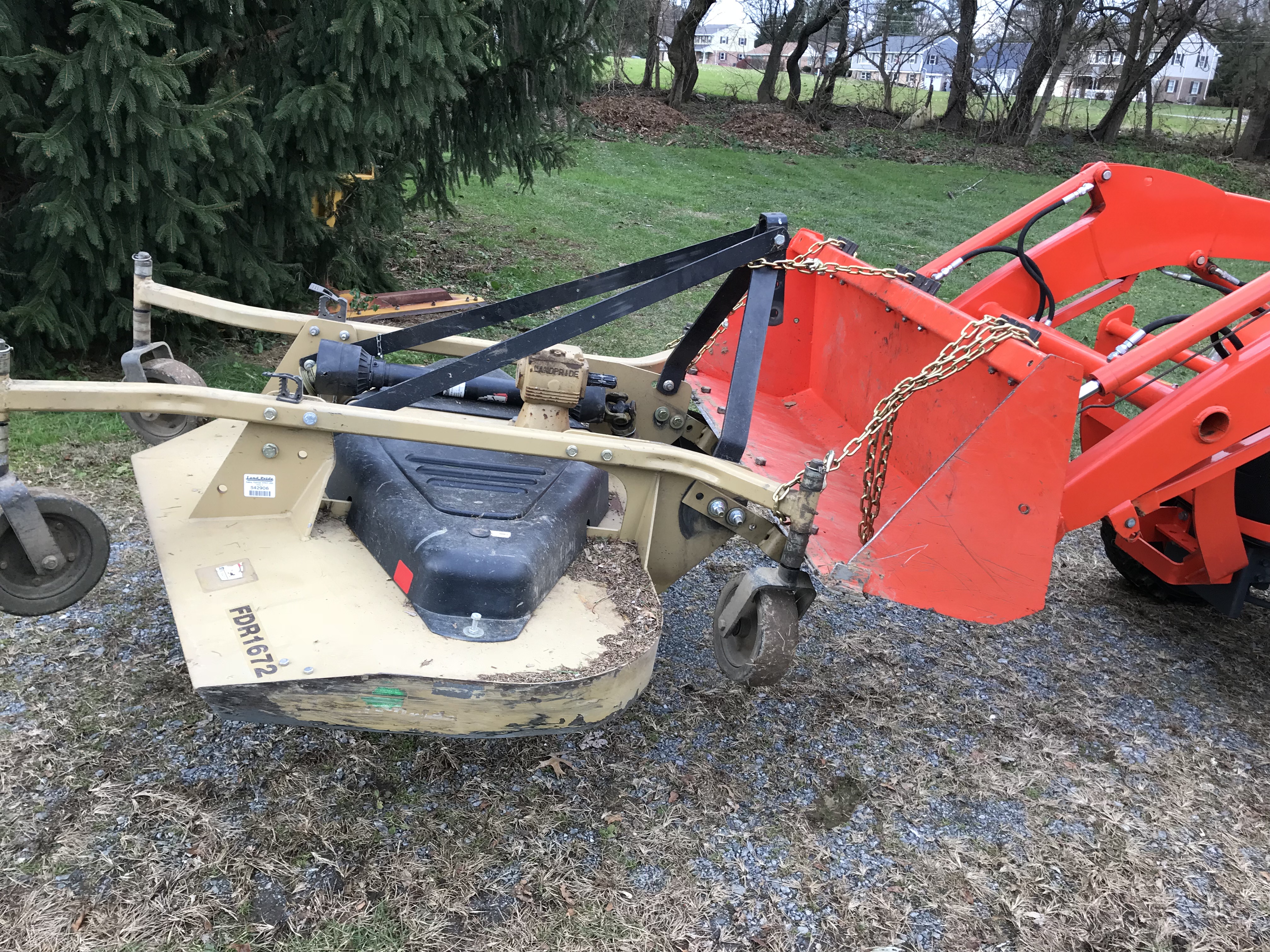

It makes sense in most cases to have the attachment points directly above the load so forces are not pulling to either side. Many loads need to be attached by more than one chain. This can be for the purpose of keeping the load oriented in the same position from picking to setting. It can also be important for balancing a longer load. Here are a couple examples. The limb being I pulled out of the creek in the first photo was carried with two chains spaced wide.
The second is moving a mower deck to or from storage. With three chains it is as easily placed as using forks. I just completed a small shed for the L4240 and built a steel frame in the far end for the mower or snow plow to sit on while using one or the other. The 7-1/2 foot RFM was placed using the 4240's loader as in the second photo.
A month or so ago I helped with a project at our club's outdoor range. Sorry, but no pics. We rented a PHD to drill holes for used utility poles to be placed as a barrier. The poles were about 20' long. For transporting on the site they were carried like the limb in the first picture. To set them, I used a double wrap and choke chain at roughly the balance point. That chain was connected at the center of the bucket so the chain contact at the bottom edge of the bucket was close to the choker hook. When the poles were lifted they could easily be rotated so the butt end could be lowered into the hole.
