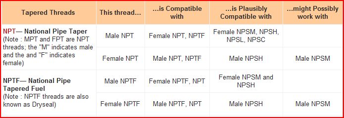

I know the difference is basically in the major and minor diameters...however i was looking at a hyd valve at tsc and it mentioned work ports were npt 1/2" and in and out port were 3/4" nptf
is that a typo on their part.. or? what.
I see they only sell npt adapters.. no nptf parts.. etc.
Will npt adapters or npt fittings work sufficiently in nptf tapped valves?

cool , thanks.
so them, according tot he chart.. the female nptf threads will be compatible with the male npt threads from hoses or fittings.. etc.
