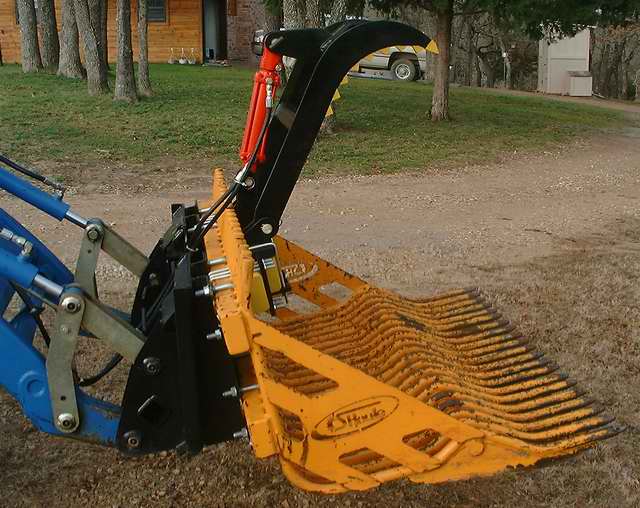

OK, after mocking up a "simulated hydraulic cylinder" using PVC pipe and fittings, I've taken another full set of measurements. It looks like my last dilemma on this particular issue is "too long, or too short?"
My measurements suggest that to completely open the grapple, I need to have a cylinder that retracts to 16 1/2" and to fully extend the grapple (to the point where the cyinder has 1/4" to 1/2" clearance before it would contact the grapple) would be 24 1/2". The choices for cylinders I've found are either 15 1/2" retracted x 25 1/2" extended, or 13 1/2" retracted x 21 1/2" extended. The shorter one means that I have to add some more metal on the "spurs" I'm going to put on the grapple, (using some 1/4" plate and some 1/4" thick 2"x2" angle iron), but it's only about 2 extra inches of steel.
So, here's where my ignorance of hydraulics comes in, do I go for the longer cylinder and just make sure it has "positive stops" to keep it from getting lateral loads again, or do I go with a shorter cylinder that will neither fully open, or fully close the grapple. (Or is there another option, finding a "Goldilocks - just right" cylinder somewhere?)
All input appreciated.

I agree that a shorter throw and shorter cylinder is better. Unless you plan on picking up sheets of paper, you don't need to have your grapple close completely. Opening wide to stay out of the way when not needed is more important than closing until the bottom touches the bucket.
/ Now what did I do? #25
May be illusion, but from pics...appears grapple not contacting bucket lip allows cyl side to contact mounting bracket. Further ram travel bends rod. If you mod grapple to contact lip, extra travel will translate to force on upper lip mount...which may bend lip. Double-check geometry and choose cyl size carefully...

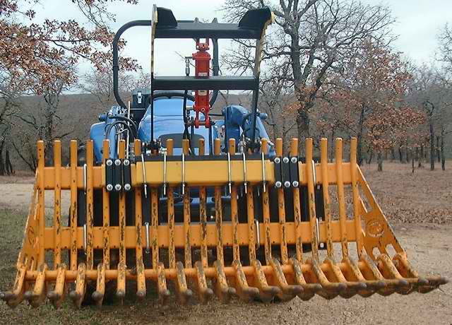

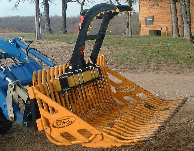

Well in case anyone's interested, I ended making all those measurments for about the 10th time, scratching my head a while, and going with the same type cylinder I originally had, (which I figured I'd use for another project if it wouldn't work) and followed that by some very careful testing. A little more exploration revealed that my "bolt-on" conversion was a big part of the problem, the 1/4" angle bracket that the tabs were attached to actually "flexed" several degrees when closing. The second issue, which was the grapple being able to enter the bucket, was "the straw that bent the cylinder's rod," (if I may mutilate a metaphor.) Since I have some very rudimentary skills in cutting and welding, and some scrap pieces of plate laying around, I made two "extensions" for the side of the grapple teeth, with teeth of their own, and tied these together with a piece of 1/4" square tubing, and a piece of plate across the end, essentially duplicating the last 6" of grapple, and after overlap, extending the grapple by about 2 1/2". Once through with that, and seeing that the "flex" allowed the whole system to bend forward to where the side of the cylinder almost contacted the web of the grapple again (by the way BotaBigot, it wasn't an illusion, that was the problem that started this lengthy thread), I just asked "Mr. Lincoln" to make a firm connection between the grapple and the bucket, front and top. It no longer "flexes" at all. Just to be safe, I then did a 1/4" "relief" at the point where the cylinder had hit the grapple before, even though all my tests showed I had nearly 1/2" of clearance now, I decided I'd add some "safety margin" in case there was any deformation of the grapple, bracket, or bucket as it "works in" after I finish the installation.
