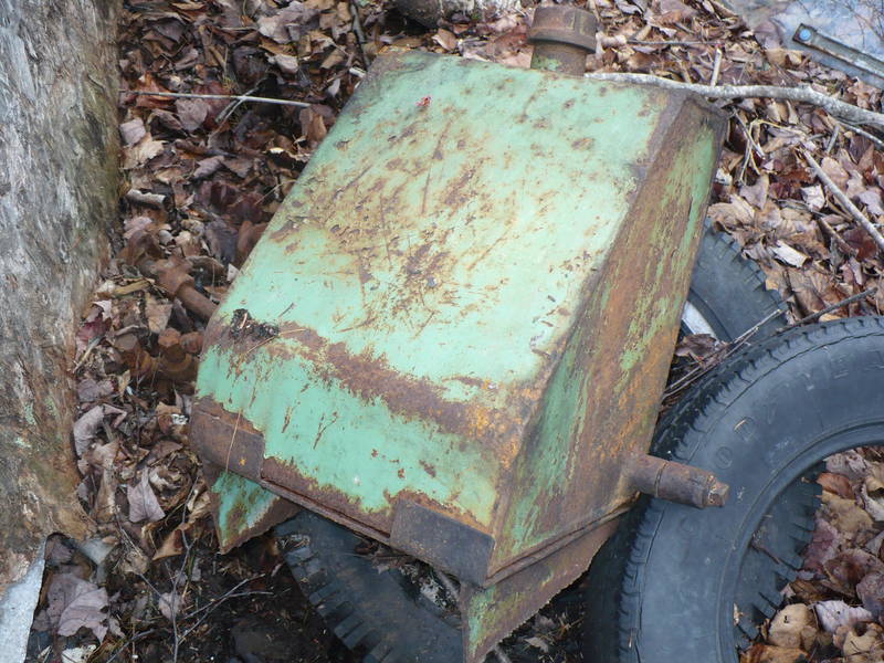

First question will this hydrolic tank work even tho the in and out are inline? Looks like it will hold enough fluid and it is cheap... Thanks

I've heard that the general rule of thumb for a reservoir is that it should be the same capacity as your pump GPM. I.e. a 16 GPM pump should have a 16 gallon reservoir. How big is this tank? If it's big enough and will hold fluid, I don't think the inlets and outlets are a concern.
A concern... 15 hp will likely not power a 16 GPM pump at 2000 psi. A 16 gpm pump at 2,000 psi requires a 18.7 hp engine not counting any transmission losses.

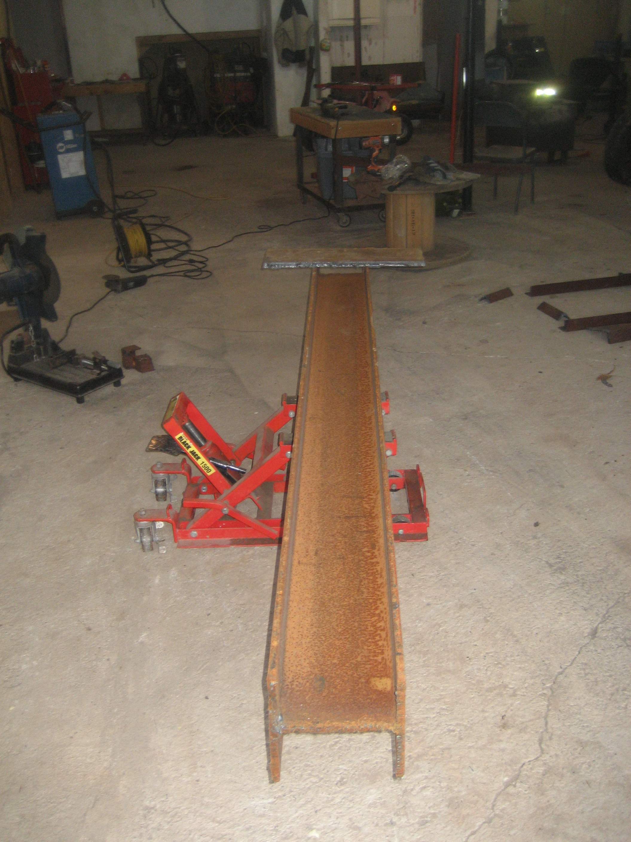

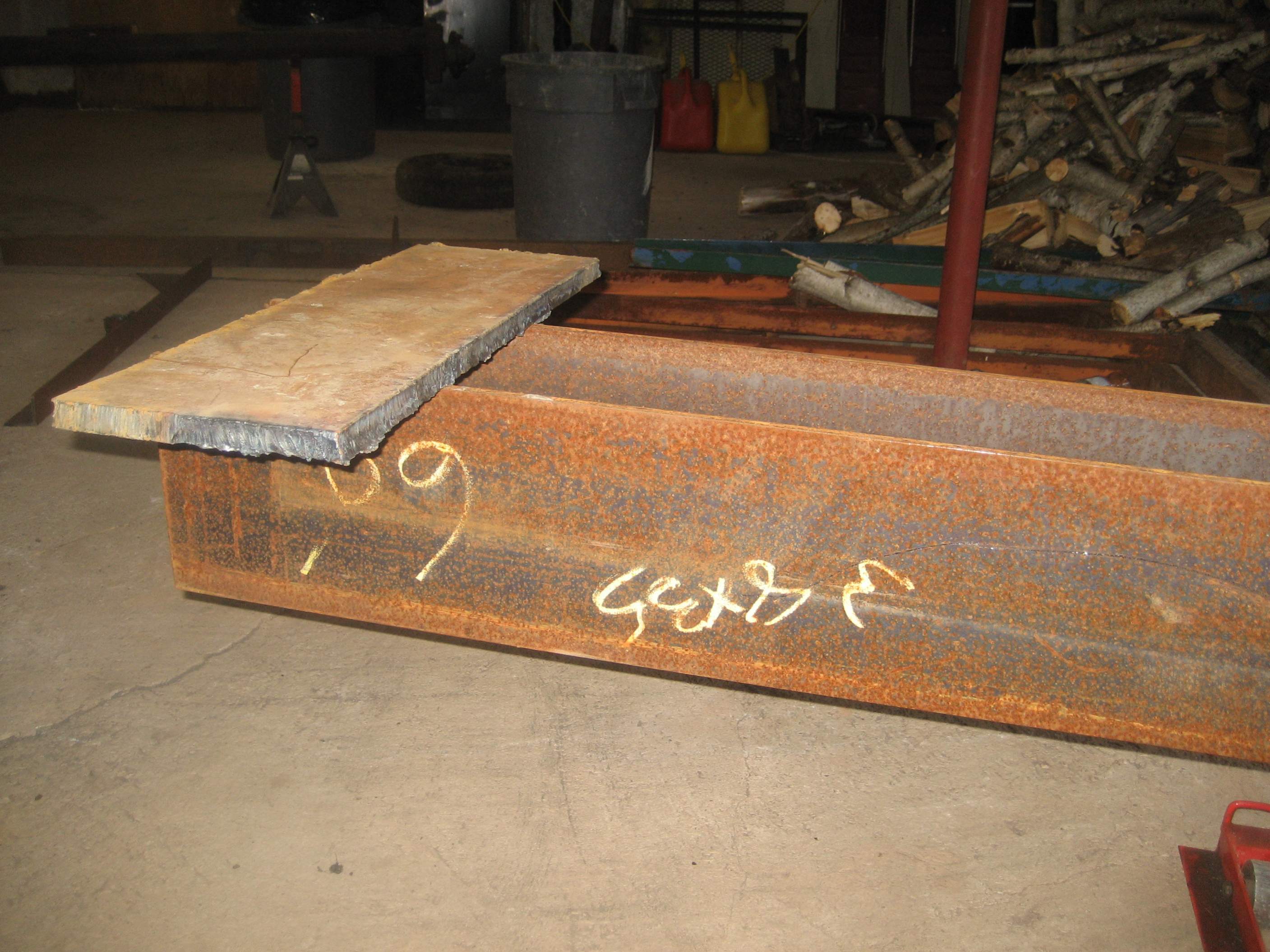

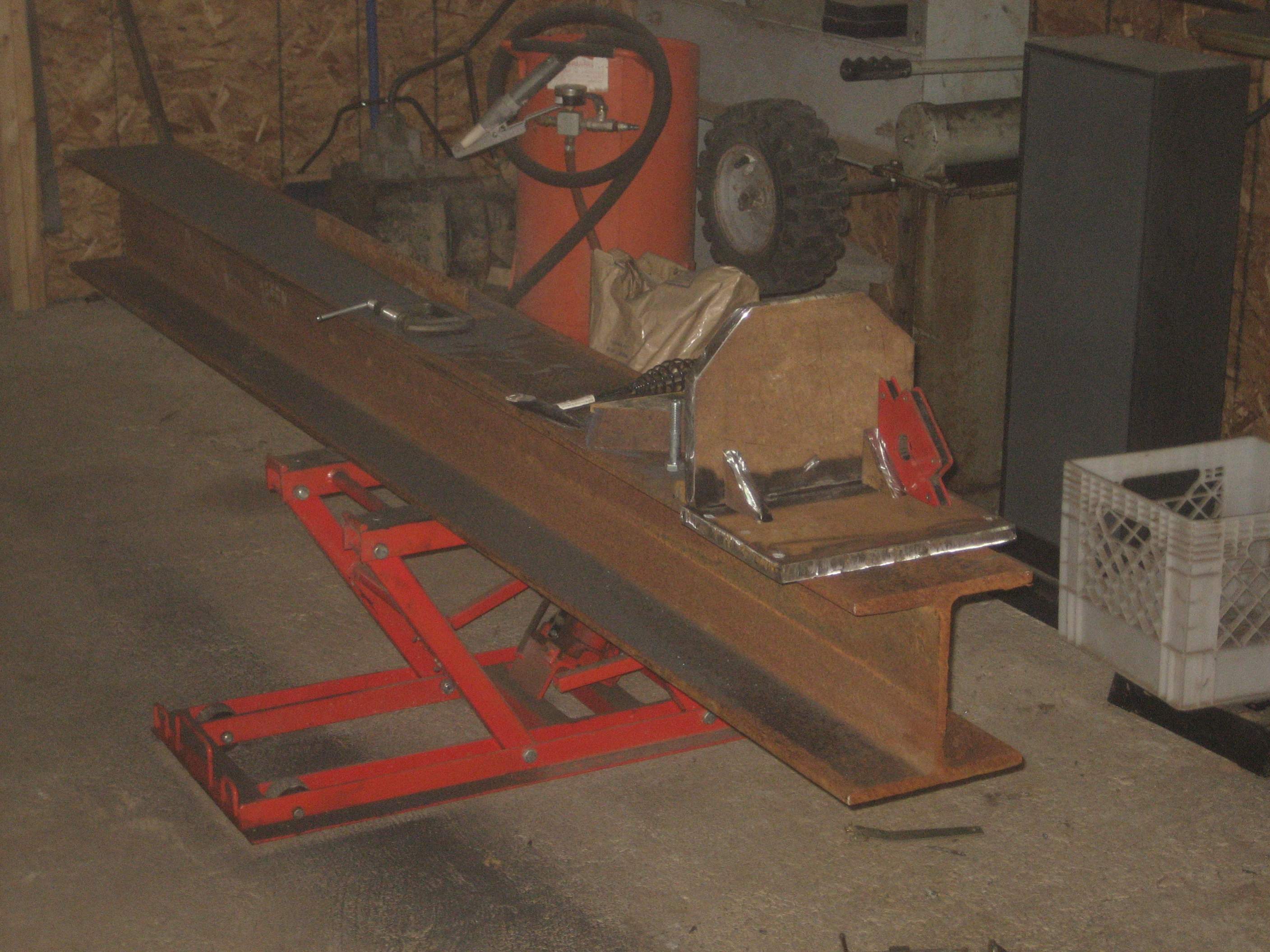

Alright..got me a beam w8 35..1/2 thick..should i brace the top more?
Now its 8 foot long but what are the normal lengths for woodsplitters..i am assuming 4 feet + is required for the ram ( 24 inch) but i am thinking it should be cut a bit longer than need be?

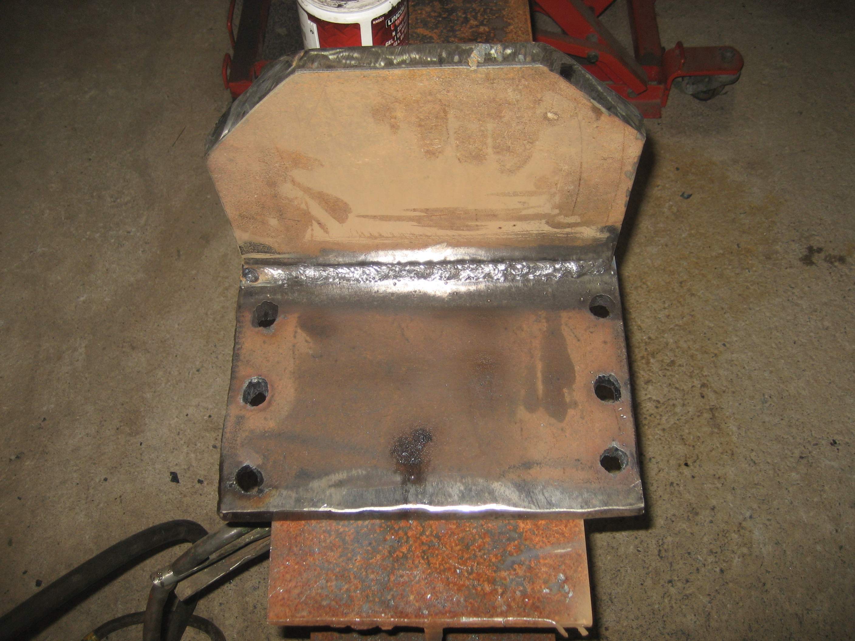

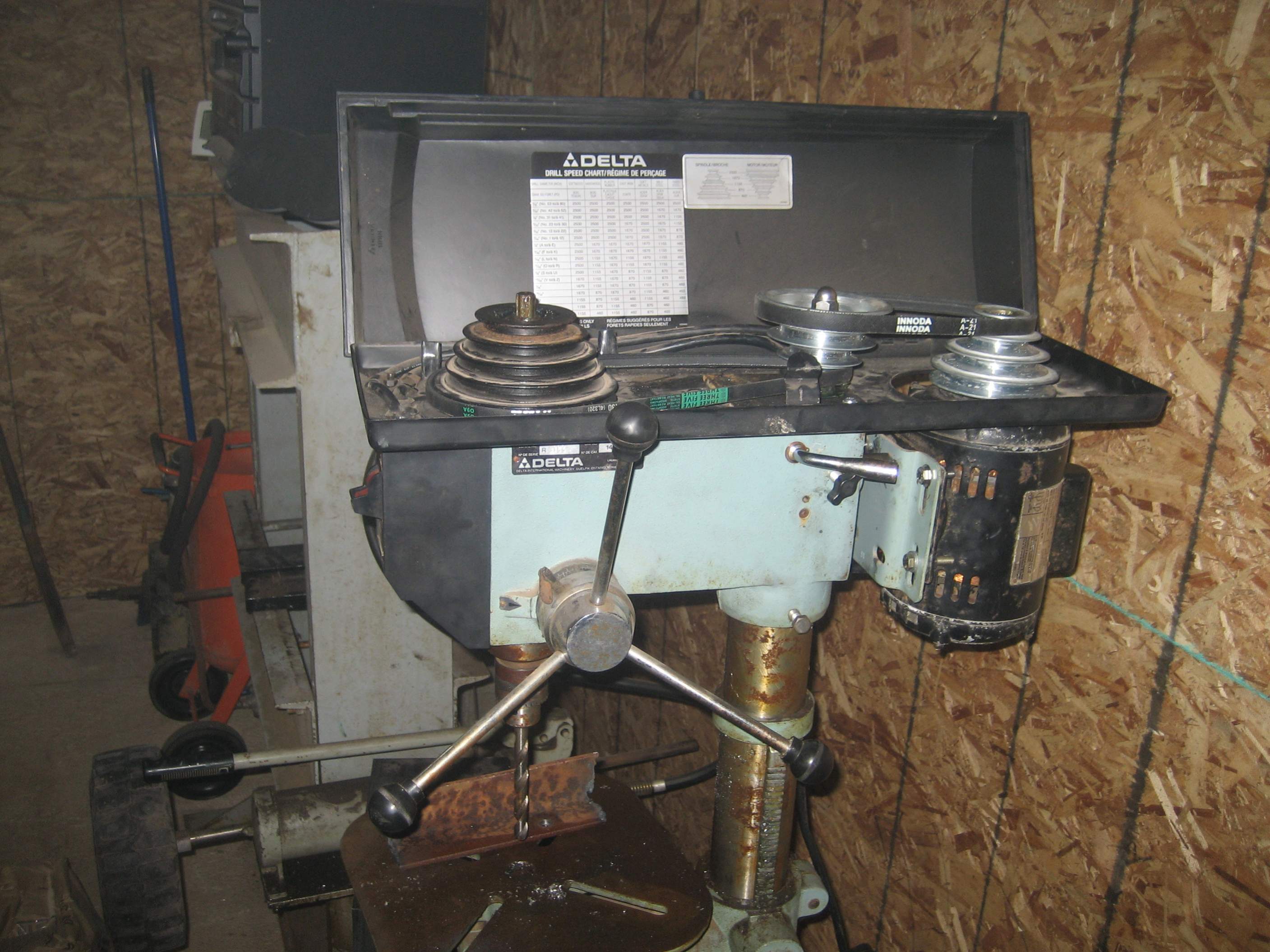

started working on the pusher plate..probably will use the ram mount brackets as the brace and not the little triangle...got hung up on drilling holes..dang drill press cant go slower than 460rpm which means drilling a big bit threw 1 inch plate is impossible..gotta slow it down or figure something out..even tryed reaming out a hole with my plasma cutter but it wasnt working as well as i remember when using cutting torches..i am starting to think i may have went too big on the steel..

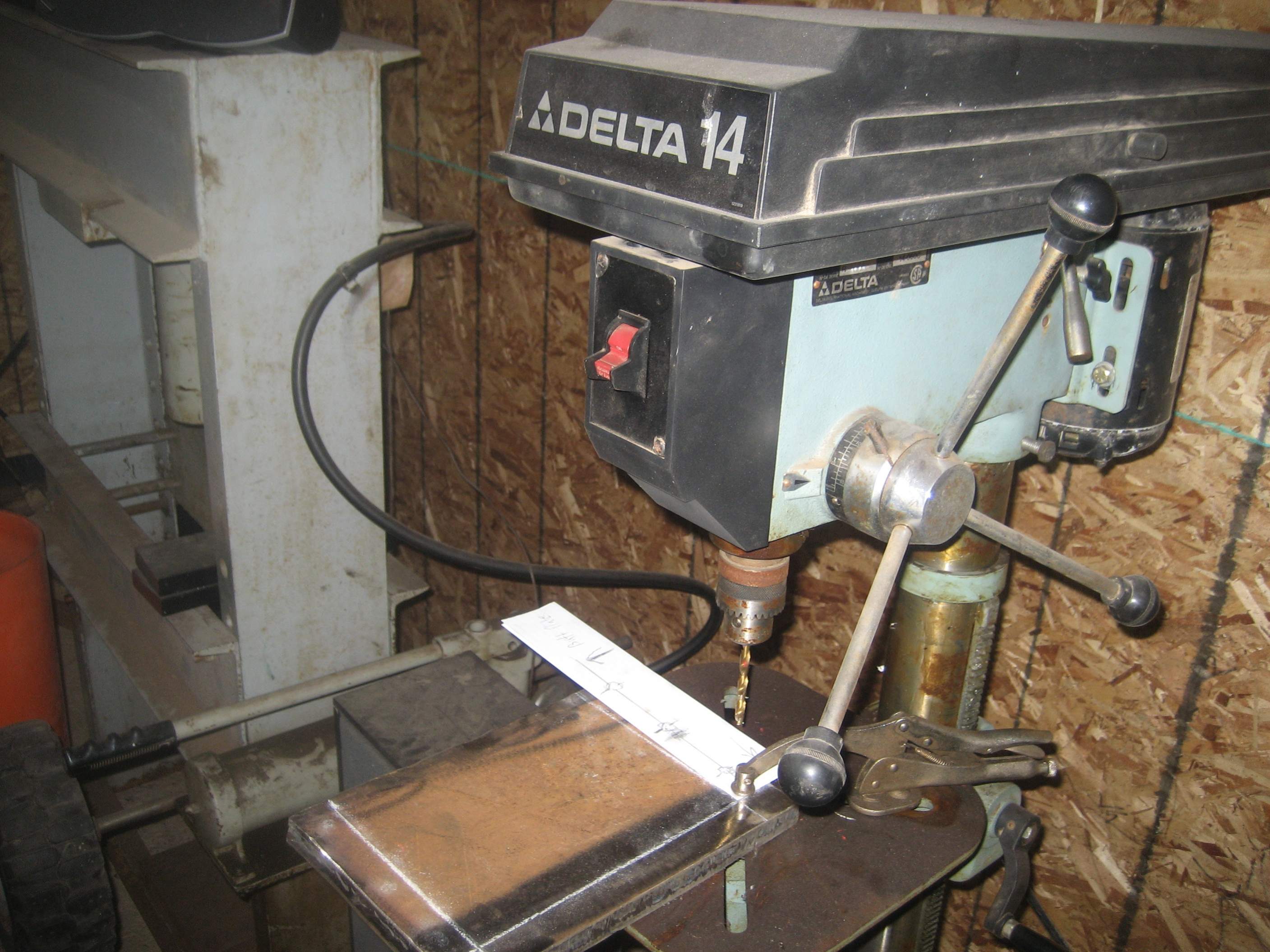

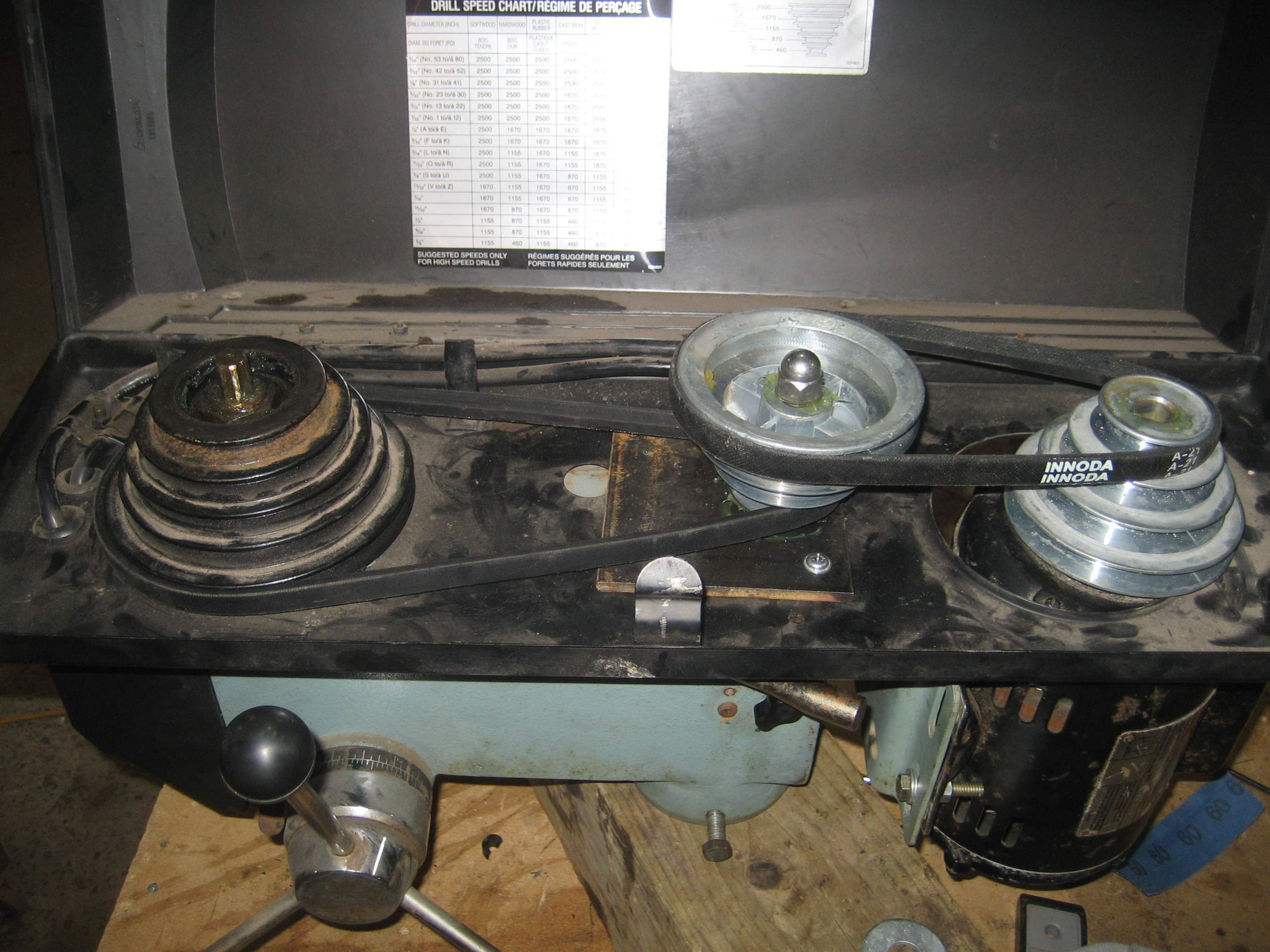

little up date....manage to get my drill press geared down to around 200 rpm..works very well and i am impressed with the new found torque of this monster..almost looks factory!..Best part everything is still contained under the cover!..still cant drill 1/2 holes in one inch plate but it is a big inmprovement in thinner steel..

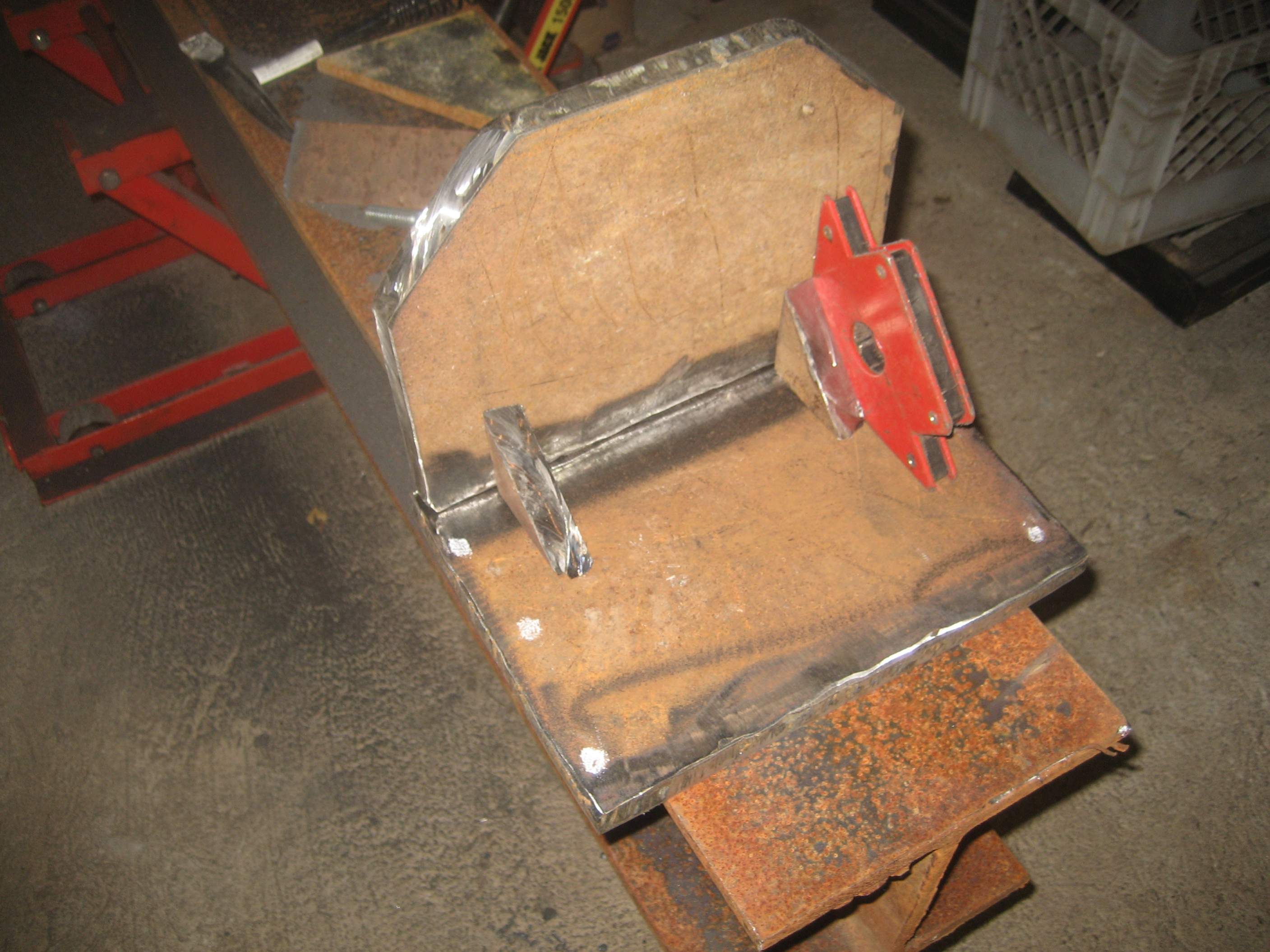

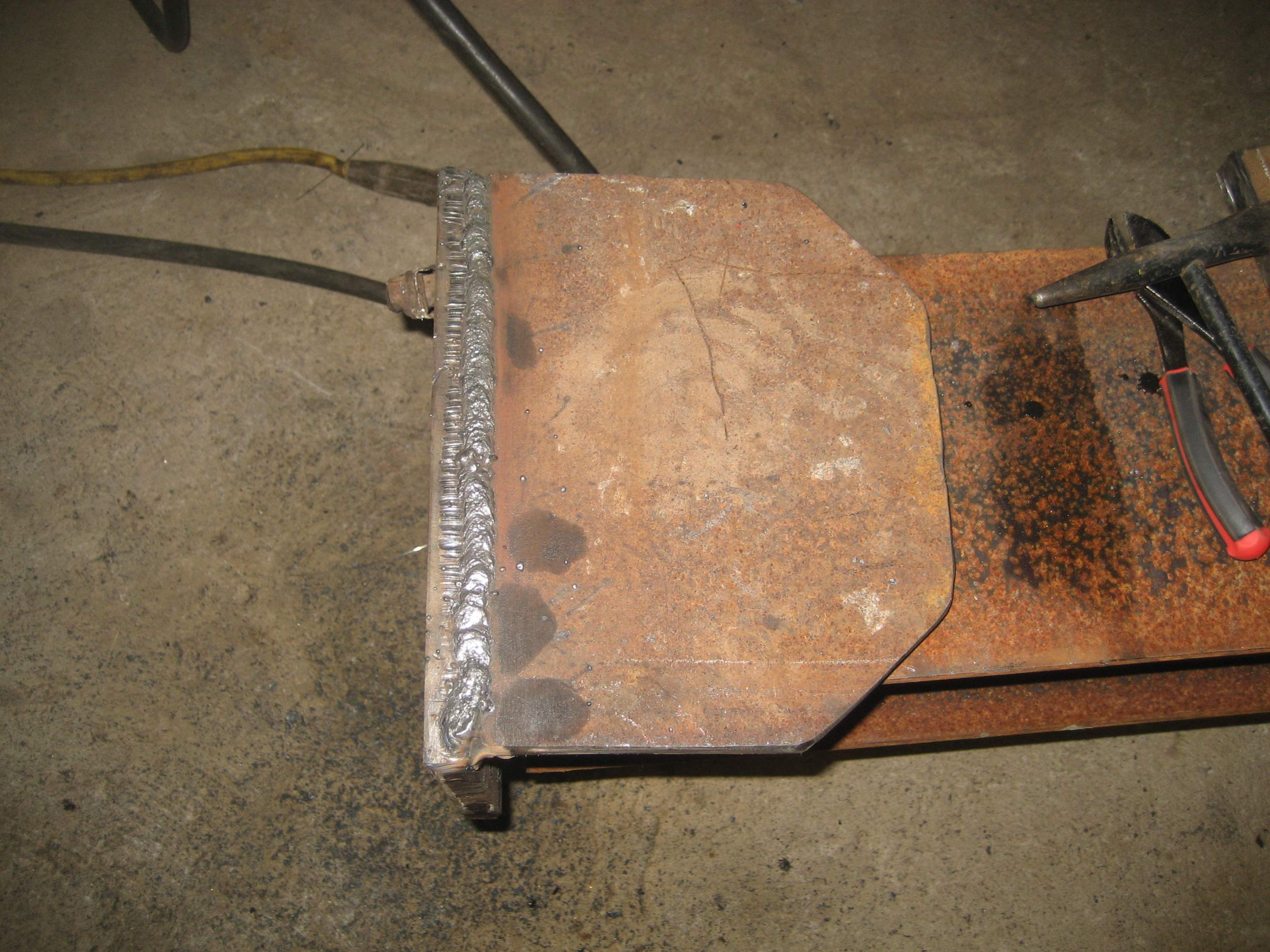

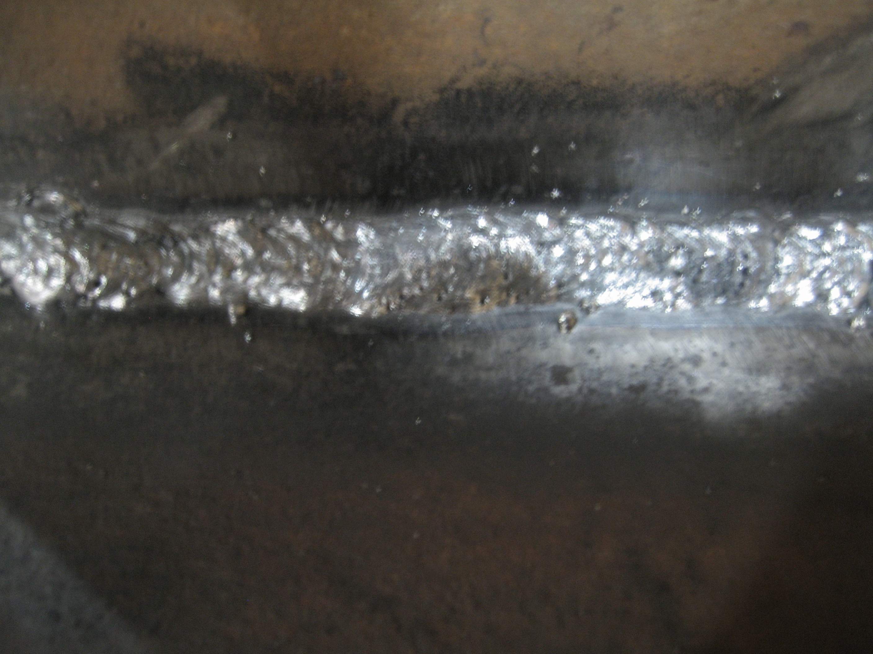

Splitter..Since my plasma is only rated for 5/8" the only way i could make the holes in the one inch plate was to burn threw with the plasma, flip and burn threw the other side..Turned out better than i thought it would but it is still an ugly hole..The washers should cover through..also broke out the welder..This is the first weld i have laid in over 6 months..took a bit to get back into the groove... .45 fluxcore wire, no gas, one pass...got some small air pockets..

Is that a ball bearing pulley you are using for the additional speeds.
If it is, where did you purchase it ?
