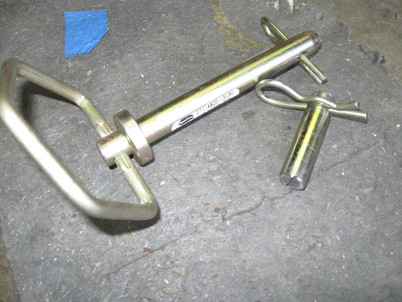

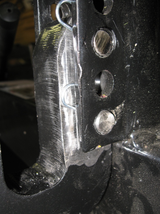

Maybe I'm late with this but if the problem is interference with the bolts on the hook, here is my quick and cheap solution.
/ Not the typical quick hitch question #23
The problem is the top link connection on some implements has a narrow frame that is the same width as the quick hitch frame. In that situation the hook can't get to the pin.
I have a couple that the two frames line up within a fraction of an inch when connected even with the extended hook.
