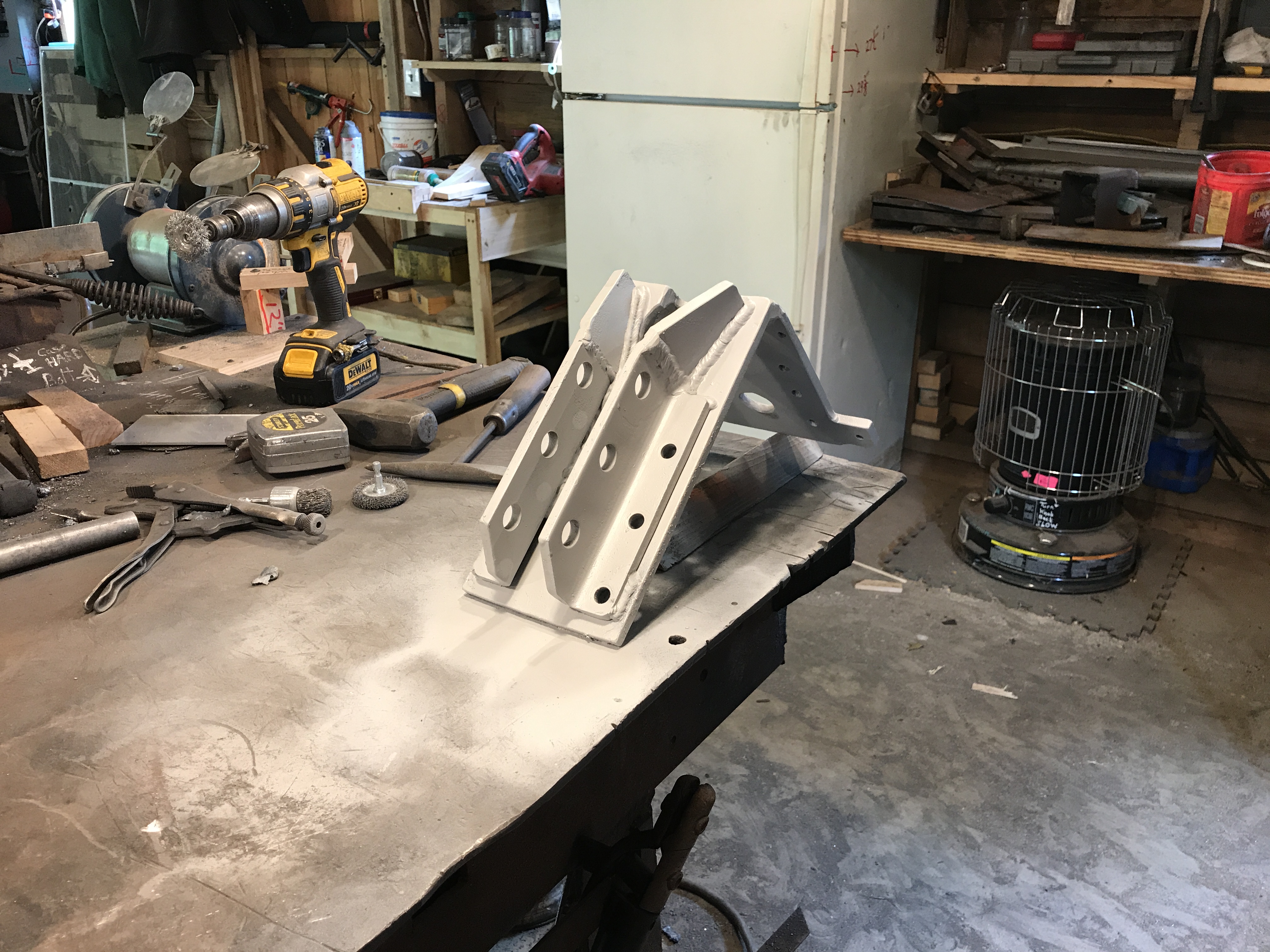

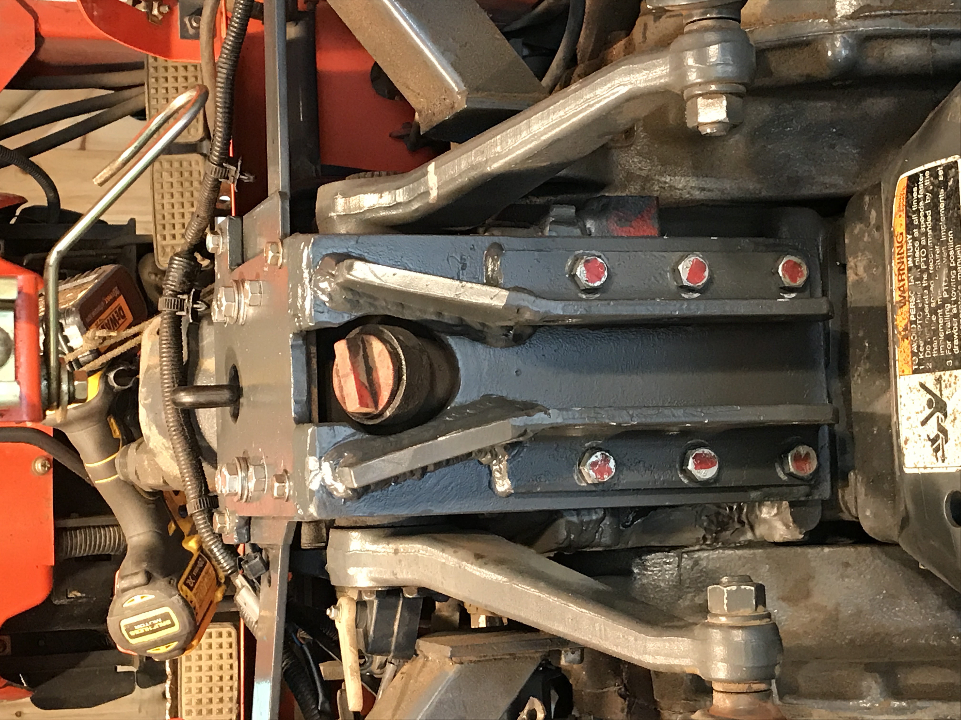

The place I bought my tractor said I must have a sub frame if I put a BH on it, be fore sub sub frame technology kuboto had a wrap around plate that fits on back of trans case. I made that same plate for mine after my trans cracked 3 years ago.

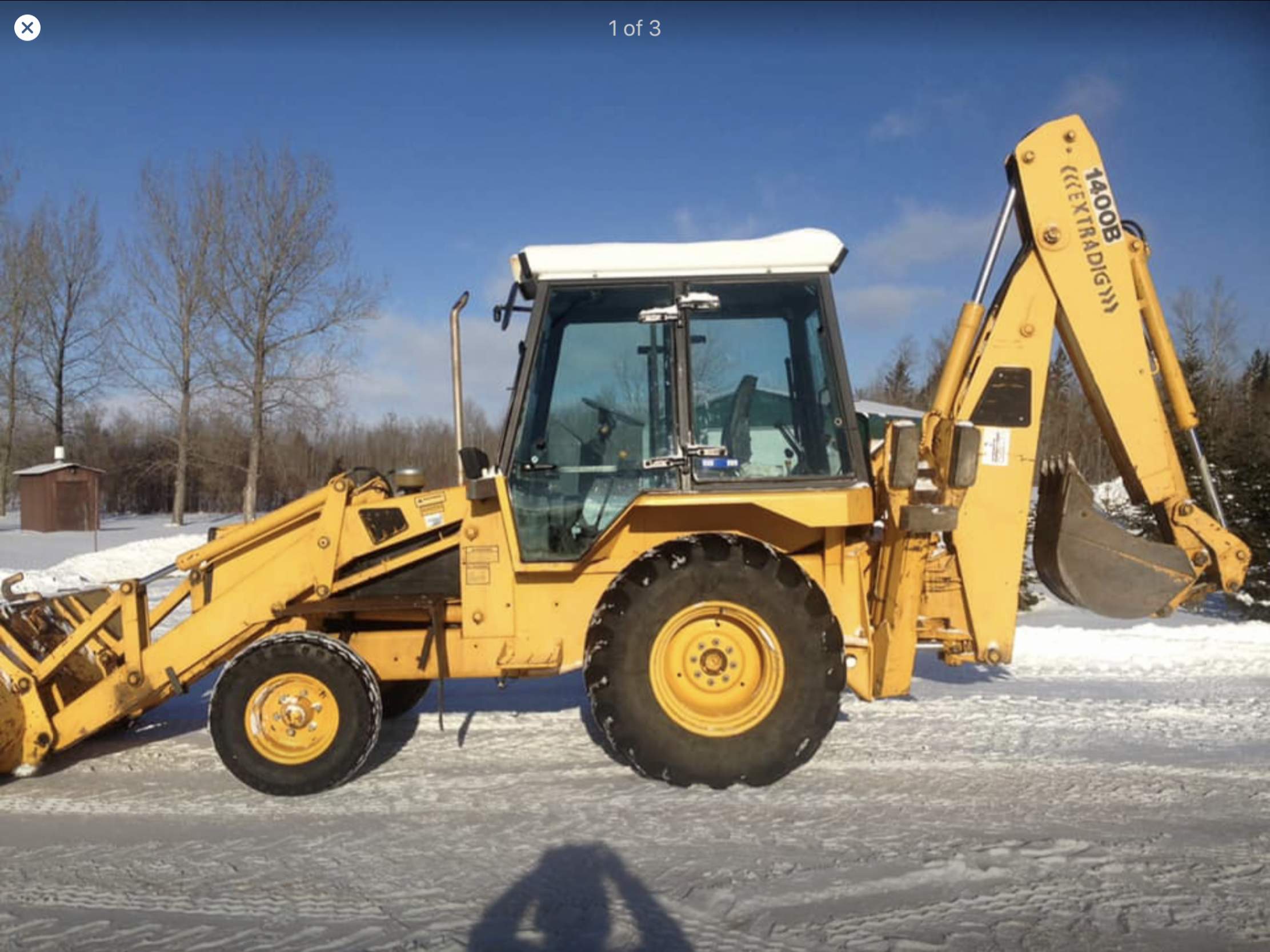

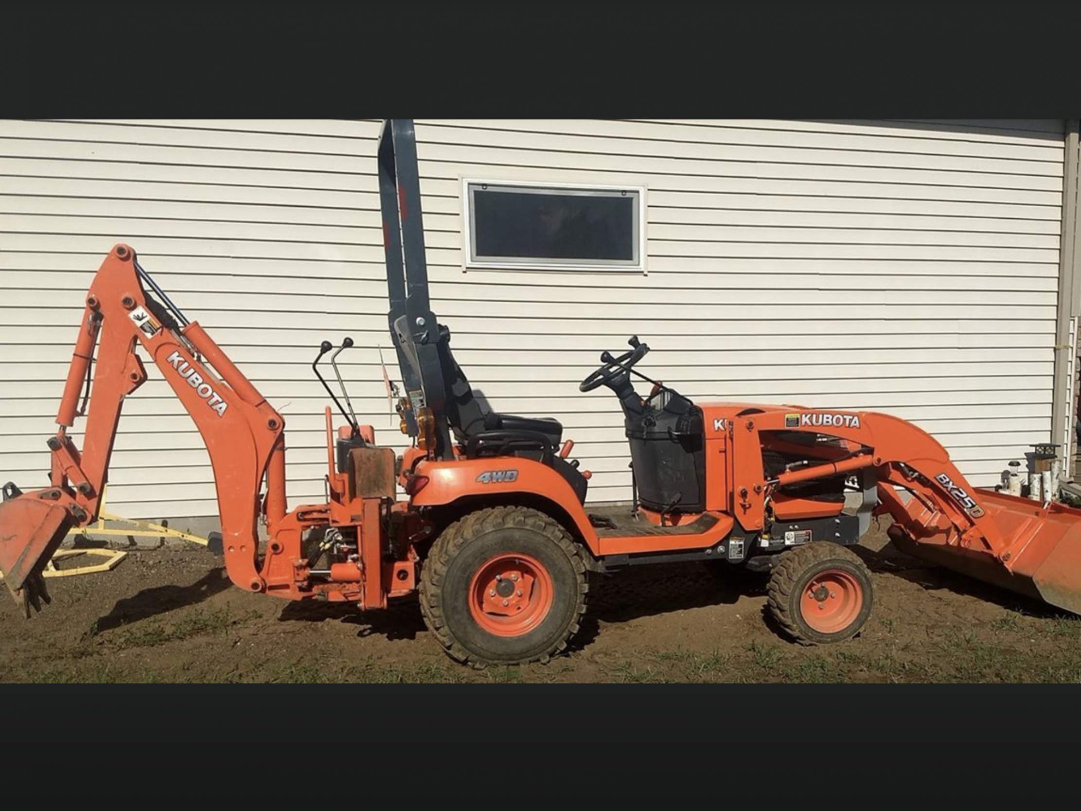

Do you buy this for 15,000 ?
Or something like this for 15,000, it has 261 hours on it.
I will leave my options open when I upgrade, maybe keep the 1705 and the HF Trencher and just buy something yellow like I have pic of.

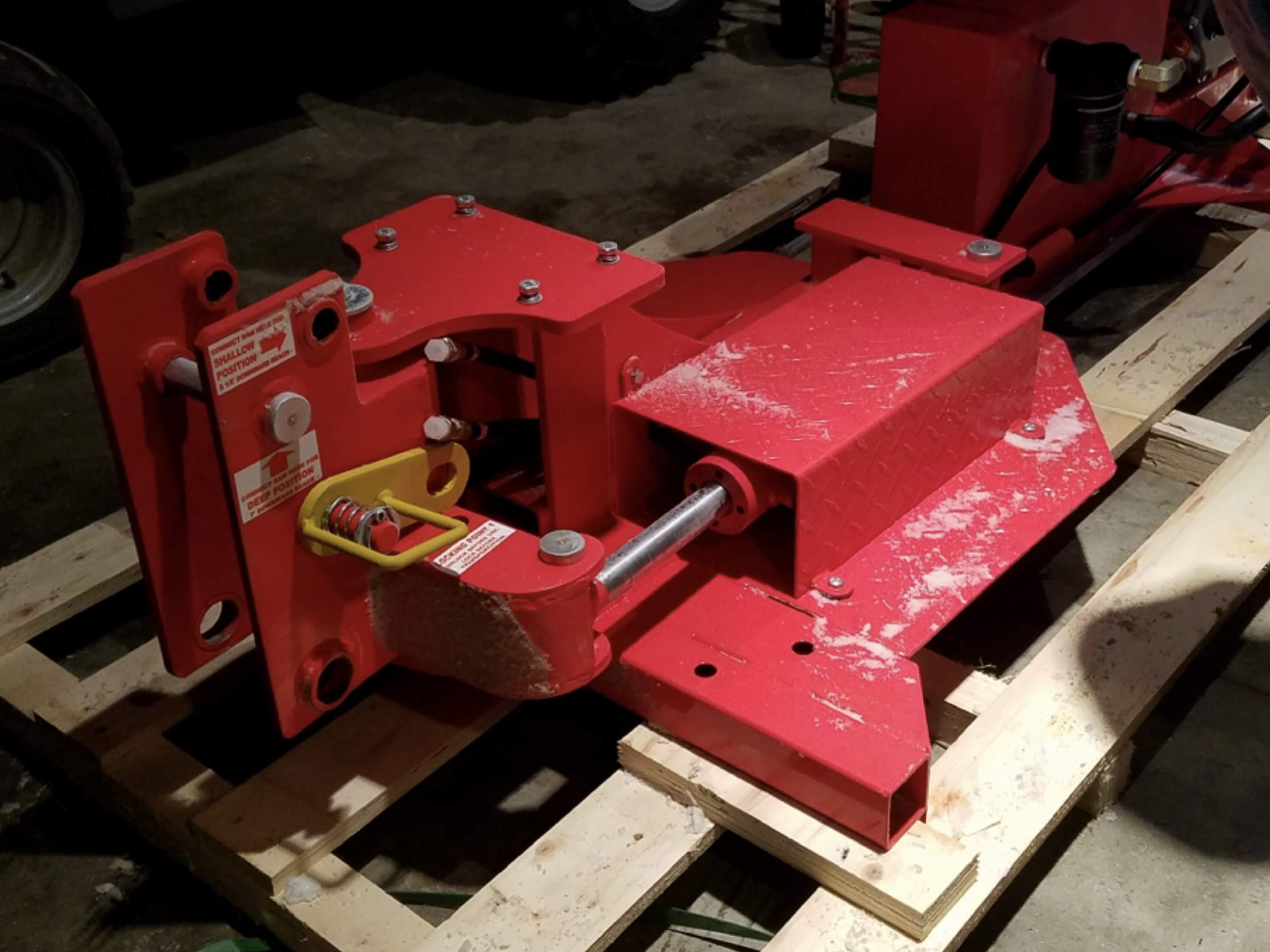

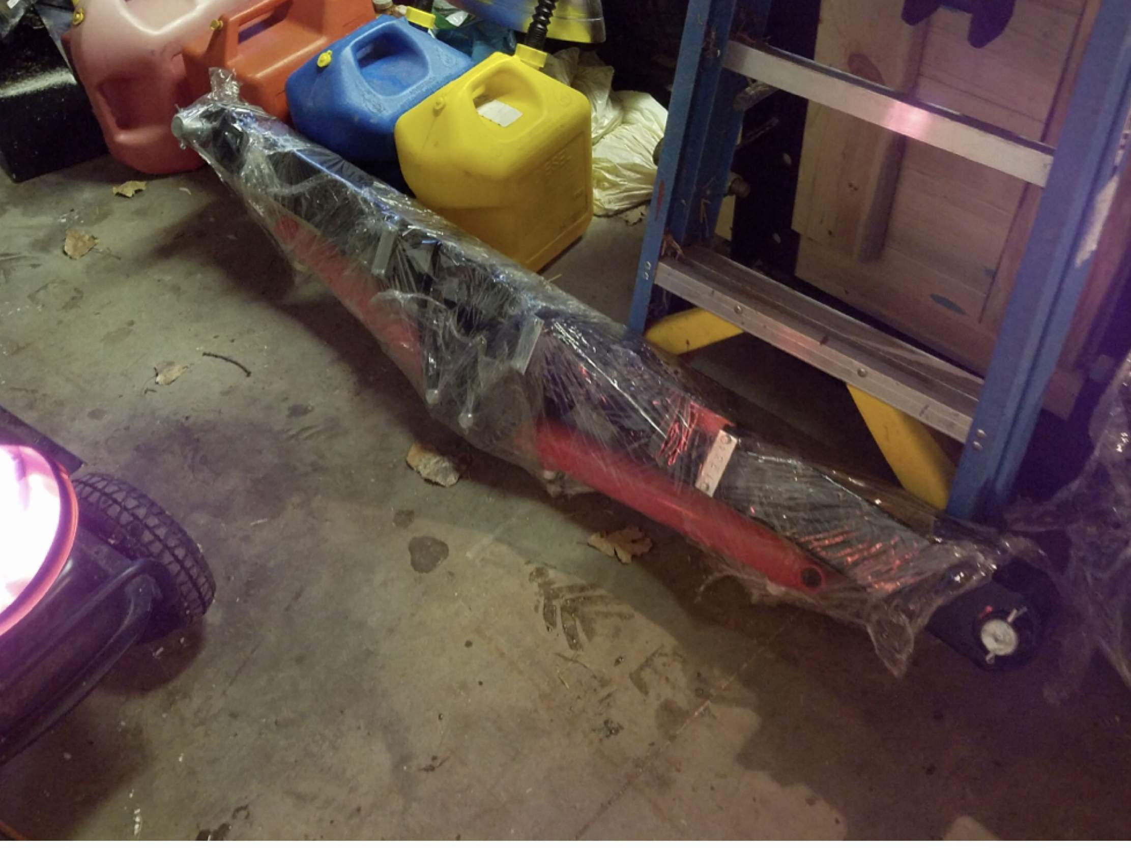

Picked up new Harbor Freight tool from LTL dock in Fargo ND.
Made it home and it is waiting on the road while I move snow to get it up to the shop/garage.
Will post more pics as I go. But here it is up to the shop/garage, now I need to start unpacking in a couple hours.

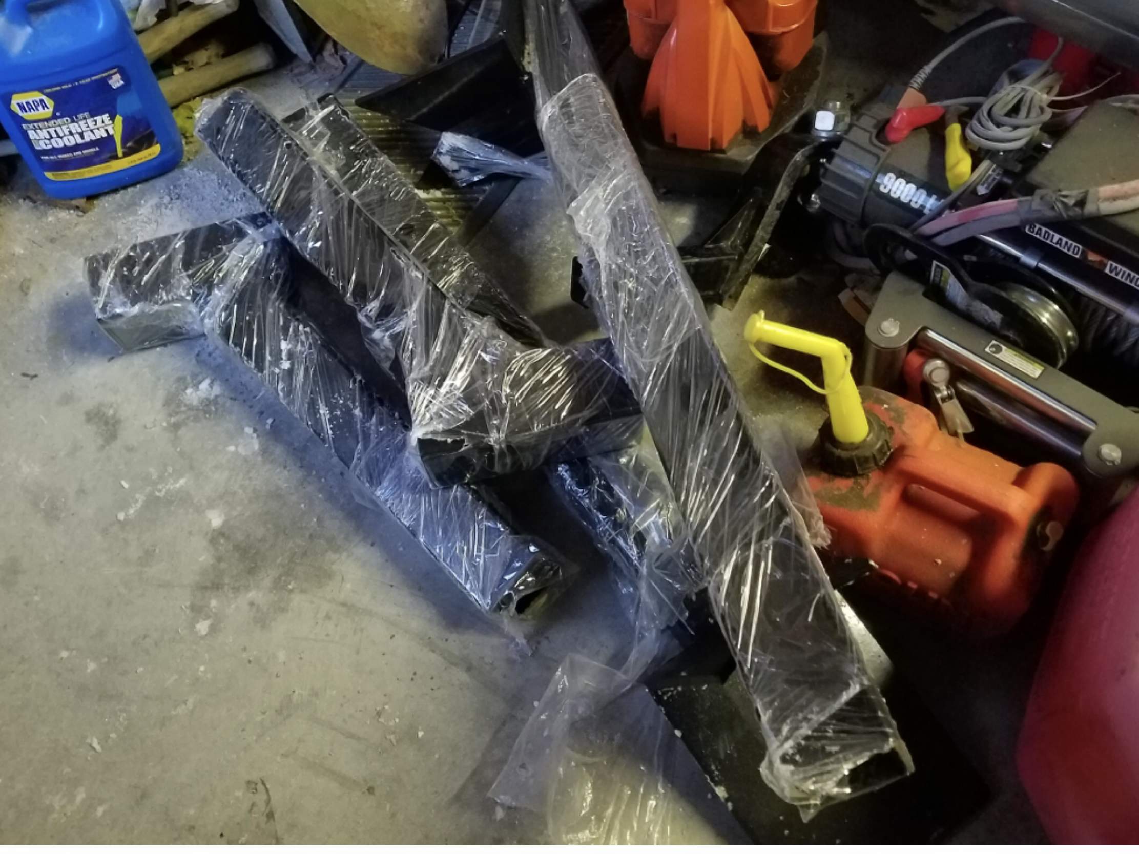

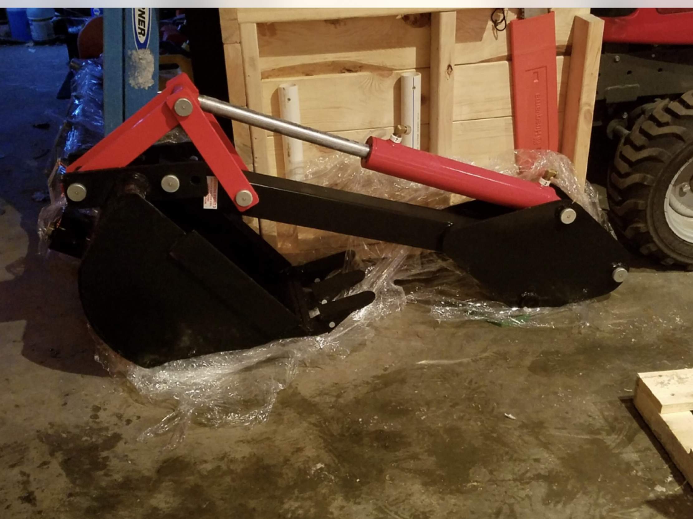

Did not find any cotter pins for spindle nuts yet.
More pics.
Stabilizers

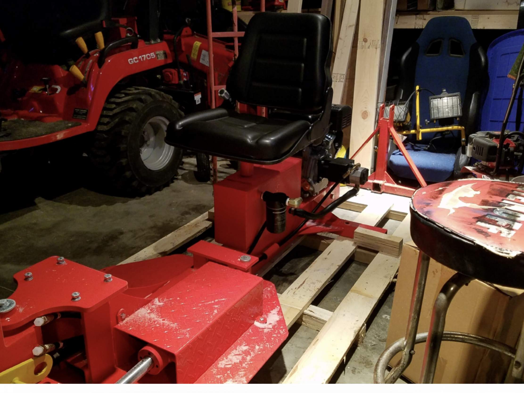

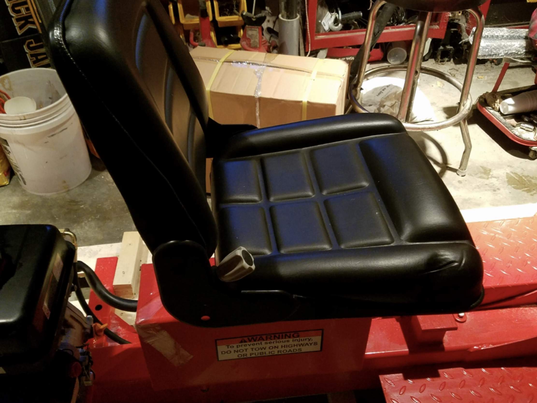

This seat is very comfortable I would like to have one like this on my GC1705.
As much as I hate 2 wheel drive, I'd go with the yellow one. Ever since my trans-case cracked with just a pto winch on I wouldn't trust BHs on small tractors.

Yeh nice, congrats. Actually, that seat looks similar to the one I put on my gc1710. Does the back fold down?

How much to make me one?
The first one is a factory one, I think kuboto still makes it, if not then get out ALL your welding fab skills you'll need em. The next two pics is the one I made, 3/8 thick and took me 8 hrs. The time consuming part was try to trace out holes, make patterns that didn't pattern, had to ream out holes, bolt the two pieces on the trans, then weld what I could, take off then finish welding>>>Now heres a vary valuable learning curve, when taken off to finish welding PUT 2 TEMP, DIAGONAL ANGLE-BARS BRACES ON before finishing welding, I'd tell you why but I dont want to speak in tongues again............

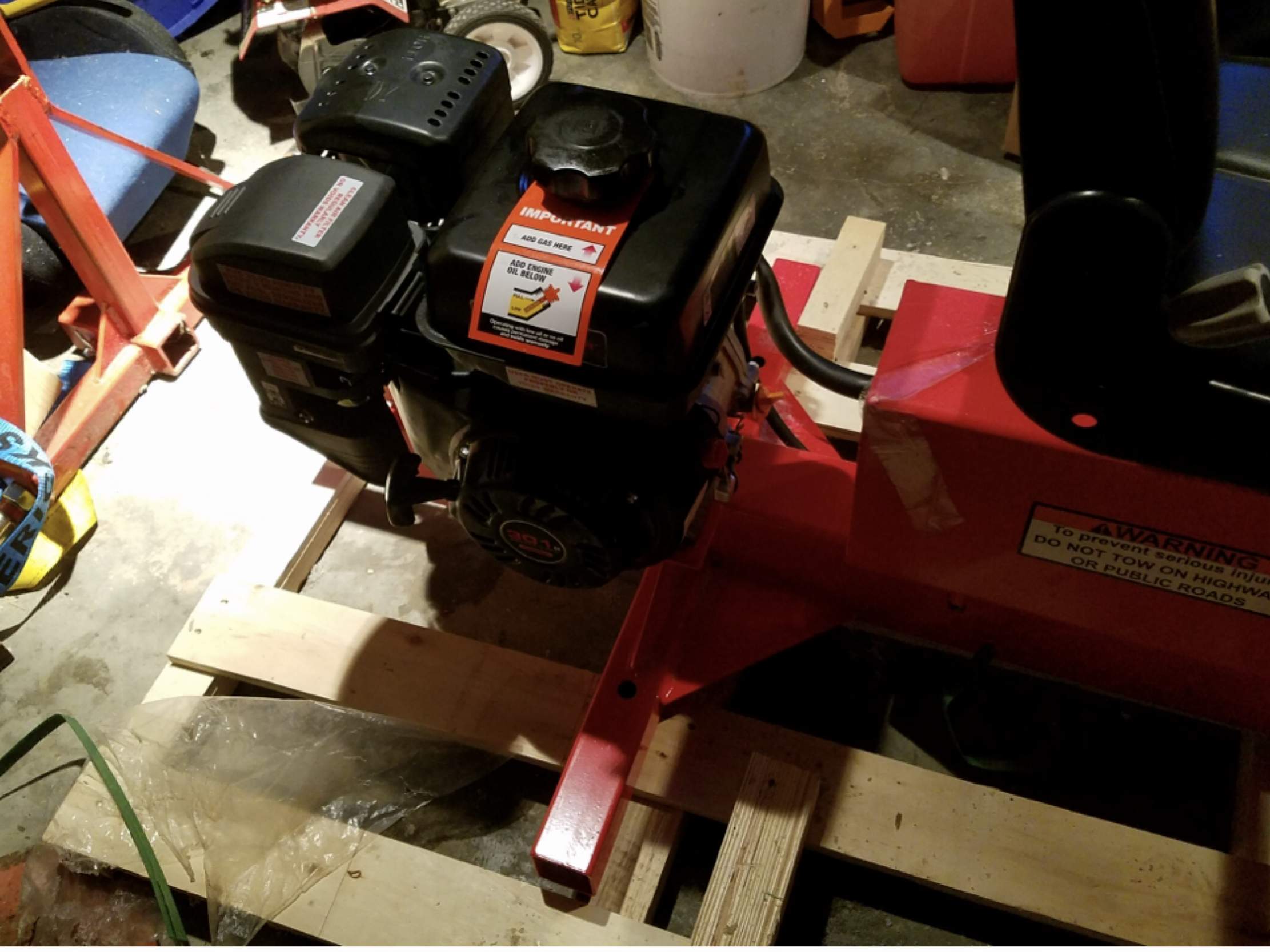

2 more pics before it is all together.
