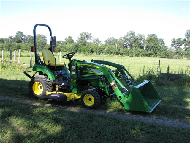

And I am a first time tractor owner and found this great site very helpful in educating myself about these fine machines. I do not understand how tractors work, how to take off implements and put them on. So I needed a lot of dealer support to get me going on a tractor. JD dealership was great and for my needs (primarily mowing) they recommended the 2305. It came with the 200 cx loader and a 62" MMM. I LOVED this tractor for the 2 hours I used it. I even filled a hole I found in the pasture with the loader. Had a blast. But it was short lived. :(
I was mowing a 4 acre pasture and after 2 hours of mowing it overheated so the tractor is currently back at the dealers. They are not sure why - some chatter about the thermostat, clogged filter but I was not mowing tall pasture and it overheated in the shop after 7 minutes with the radiator filter cleaned up. I did notice that a lot of grass would blow up depending on the wind and at times I was covered in it.
I have 2 questions; I have lost confidence in this tractor. They are willing to give me a new 2305 since my tractor has only 3.5 hours on it but I am thinking about getting a 2520 or a 2720. The use of the tractor will be primarily to mow 2 acres of pasture - the most 6 acres. Other tasks will be loading horse manure in a spreader, pulling the spreader, pushing dirt around, maybe some light logging...just some small farm related work on flat, N Indiana landscape. I am not sure if getting the 2520 or 2720 is worth the extra cost. So whatcha think?

The 2305 has a fan on the hydro drive shaft to blow air over the hydro's case. The 2320 and up have a hydro oil cooler mounted in front of the radiator. Your 2305 should not overheat idling in the shop. Everyone has mowed in 90 degree weather with some debris on the radiator pre-screen and grill mesh (the debris is
unavoidable on all makes of tractors like these) and not overheated. Your 2305 has a different cooling issue to make it overheat so easily.
The 62" MMM will mow thru anything. I mow 4 acres of field 3'-4' tall with no problem. I like the 62" size for mowing the lawn and getting close to trees, edging, etc. A RFM is not easy for getting around lawn obstacles. When mowing tall grass, I use a bungee coed to keep the safety chute raised for better dispersal.
Good luck with your dealer!!! At least he is willing to replace your 2305. Alot of dealers wouldn't do that.
I think a 2520 or a 2720 would be overkill for light pasture mowing and too hard on a finished lawn. If you liked the maneuverability of the 2305, I would seriously test drive the larger tractors before taking that large a step up the model line. Check out the 2320 with a 62D mower. It may be a better compromise with less of a price difference.
