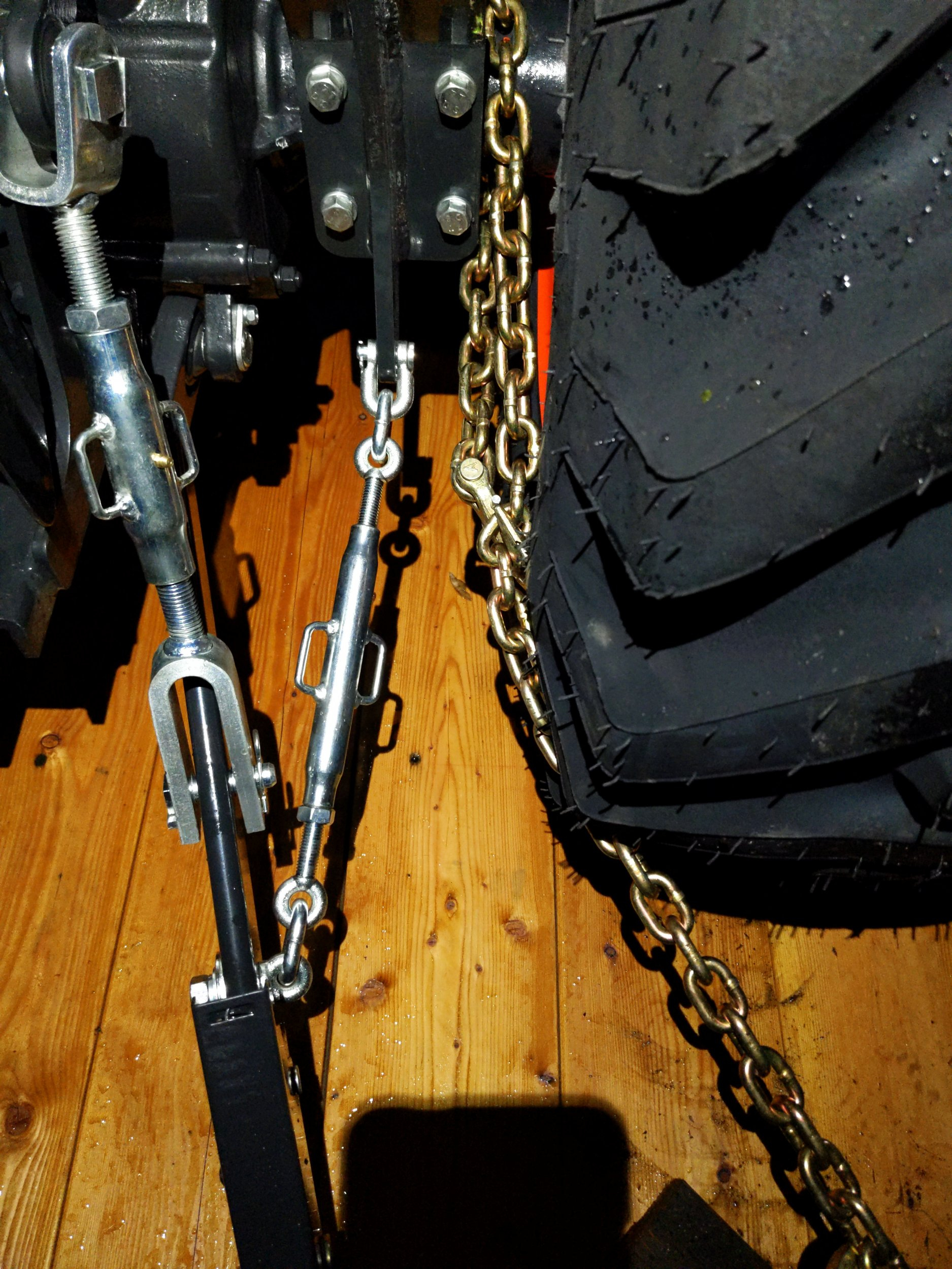

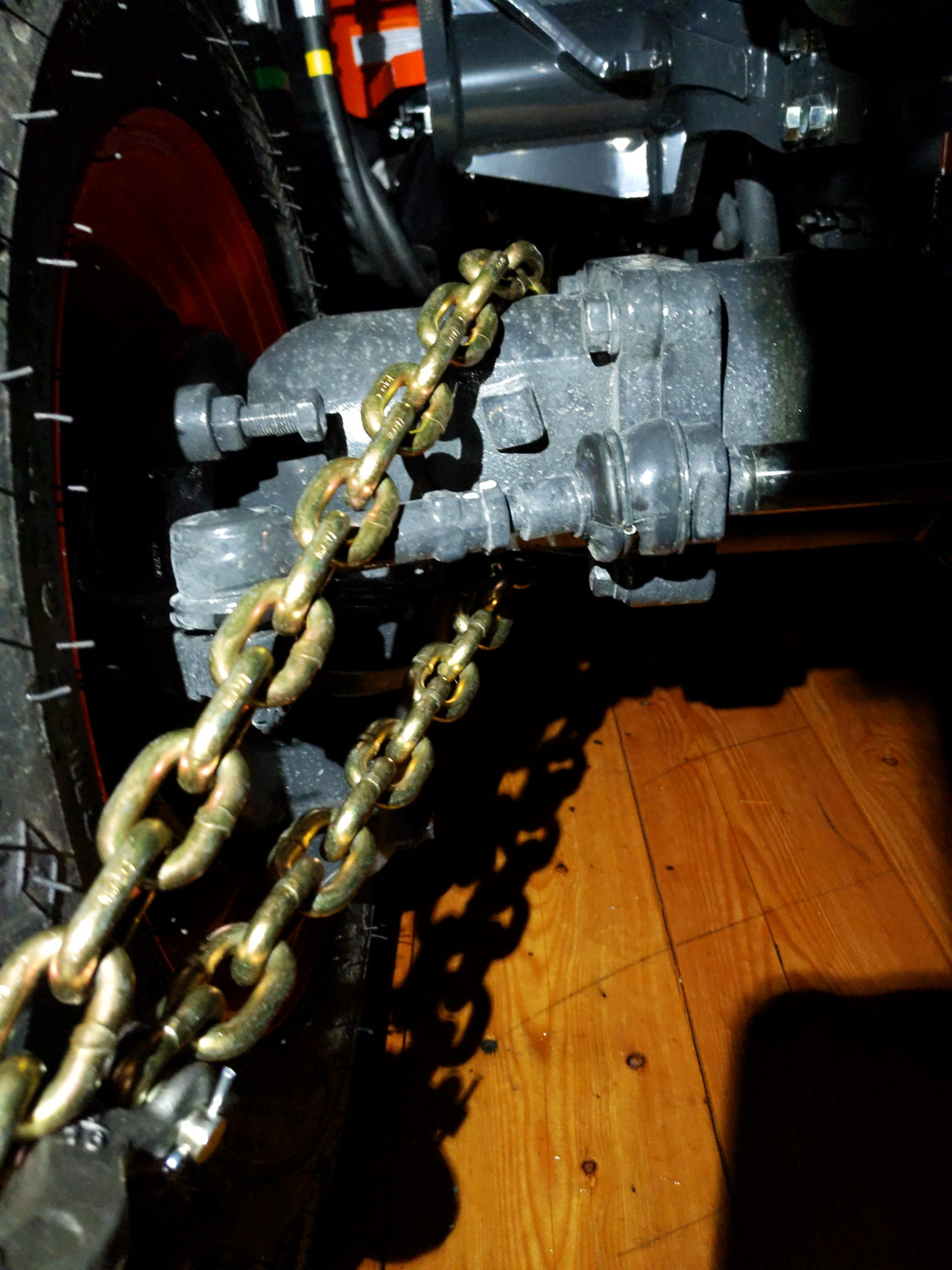

This is my first time using chains, and securing something besides a car (wheel straps) regardless. I've searched and watched the YouTube's to no avail
Are my rear chains OK here on the axle? Until a big pin shows up in the mail I can't attach to the draw bar.
My concern is that any emergency lateral load will be basically entirely on the wheel -
  • Could unseat the bead, and all chain tension lost
  • Full side-to-side load carried / torqued on the hubs, since its pulling sideways from the outer tire diameter

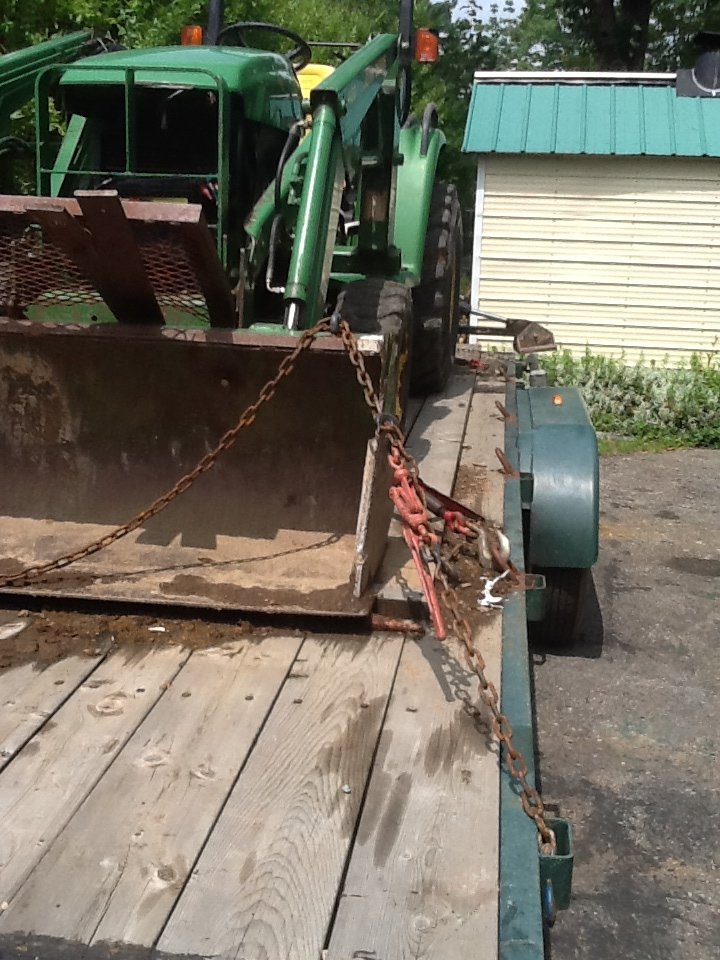

The bucket needs to be chained down to.

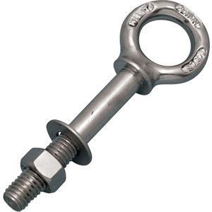

For the front put some eye bolts on the frame on both sides. Shackle on the drawbar.

Yeah, on the rear tires like that allows flex. Not ideal.
But if u drive like grampa moses, it might work....
/ nOOb to chaining down - is this sufficient? #6
I also agree that chaining to the axles and having the chains deflected by the tires isn't the best possible way, HOWEVER, it is better than some other ways. I would consider using a piece of carpet or rubber mat to keep the chains from stripping all the paint off of the axles and tie down points.
Egon,
The bucket on your backhoe pictures, while tied down nicely, doesn't appear to prevent side to side motion as well as it could. You would be better to use a chain to each side and not have the chain that goes all the way across that the chains that actually hold the bucket are attached to. The two shorter chains will allow the bucket to move side to side a lot sooner than if you had just went straight to the bucket from each side. I figure you probably did it that way due to the amount and length of the chains and binders you had available, and I understand that, however since we are trying to help with "the best way" I thought this worth mentioning.

tie it down diagonally off the axles is better than resting on the tires. It ain't going anywhere.
I'm sure this'll all get easy for me in a few trips - but it doesn't appear to be any way to get the chains diagonally without resting on part of 3-point system...

If you are using the axles, cross them and get the chains off the tires. Down and away pulls offer the best load retention amd securing.
A shackle in the drawbar works best, easy and only takes 1 chain and binder.

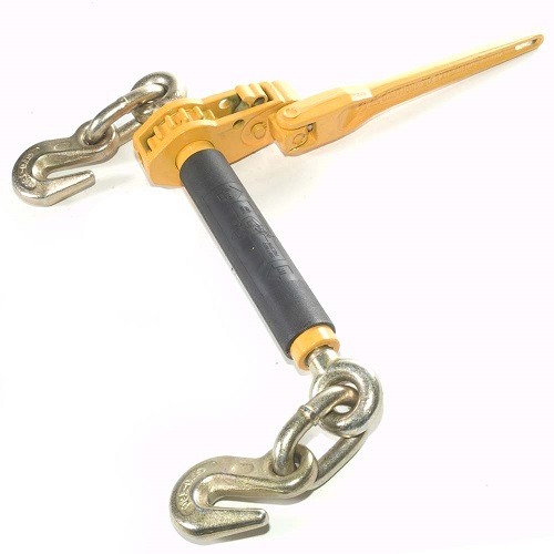

Hope that you have some ratchet binders:
Much easier, faster and safer than lever binders.

My binding plan is this - chain tractor 4 point, the 2 rear are to the clevis and draw bar - I don't like to see chain on the rear axle - don't want it all skinned up and rusting - the front two, i have attach a 2 x 6 about 8" long rectangle 1/4" heavy steel channel to the front of frame below front guard. It is bolted to the frame in existing holes. slide chain and hook thru the channel and hooked to far side - A G70 hook will fit thru to the other side. Hhe loader and bucket is secured by chain through the loader pipe hole. I ONLY USE RACHET BINDERS. They are safe and easier to work with. I sometime travel about 300 miles with the tractor. I also on occasion stop at a CAT scale to make sure the load is where I want it. Best Wishes, Larry

If I recall correctly I was working with one chain without the right hooks. The hoe tie down varies almost every time it’s chained down. With some hooks in the proper orientation welded on would be much better and may happen. ( actually it’s been happening for ten years or so )
