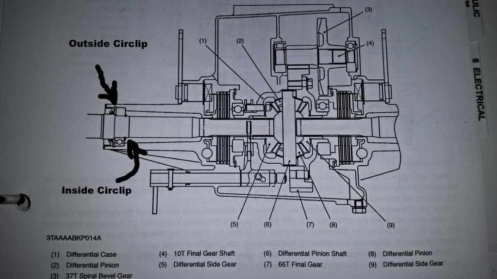

I noticed the left rear wobbling quite a bit. But I wasn't too concerned because I thought it was probably a warped wheel, but it got to eating at me, so out comes the impact wrench and off comes the wheel. I spun the right side and watched the left side and the dang left axle is bent. Measuring off the top flange of the hub, it's got a total of 0.282" of runout in it, which equates to 0.141" of warpage in the axle.

By the way, Replacing the rear axle turned out to be about an hour job, with no prior experience doing it, and that included draining the trans/hydraulic oil. Cleaned the new axle and put it in the deep freeze the night before. Next morning, warmed up the bearing in toaster oven on low temp. Took frozen axle out of the freezer and warmed-up bearing out of the toaster oven. Dropped oil seal and outside C-clip onto axle, being sure sharp edge of C-clip was facing out, towards hub. Lightly oiled axle where bearing would sit. Being sure bearing was facing proper direction, it slid into place easily, using a piece of PVC pipe as a driver, installed inside C-clip to hold bearing in place, making sure sharp edge was facing inward towards differential splines. Slid axle into place, turning slightly to engage splines in differential. Installed outside C-clip, using curved C-clip pliers. Carefully tapped oil seal into place. DONE!
