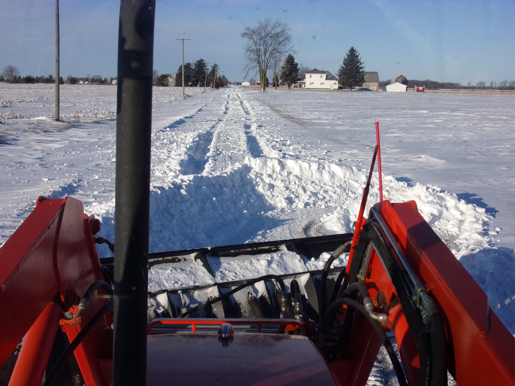

I use my split brakes all winter long for plowing snow.
Spring through fall I lock the pedals together.
Both have invaluable uses if you know how to operate your tractor.
After 30+ years I know just fine... I chain up my tires when plowing and blowing snow. No brake steer ever needed.
