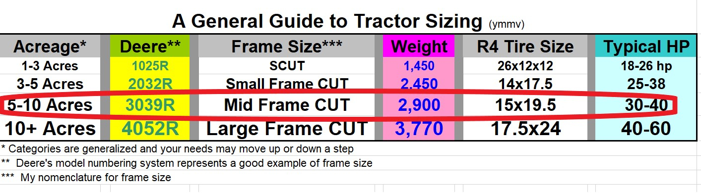

Thanks for all of the responses thus far. I have a 61" Ferris for mowing. Land is flat-to-very-small-inclines.
Usages, in no particular order, would include:

A 30 hp tractor will go just about anything a 55 hp tractor can do, just slower. I had a L3301 for 2 years and then upgraded to an MX5400. Moving dirt takes half the amount of time, I can work my gravel driveway (900 ft) with less passes, my heavy duty rotary cutter doesn't bind through thick grass or heavy brush.
Buy once, cry once if you are able. Even with me reading this forum and asking questions I still had the salesman talk me into a tractor that wasn't as suited for the work I was doing.
