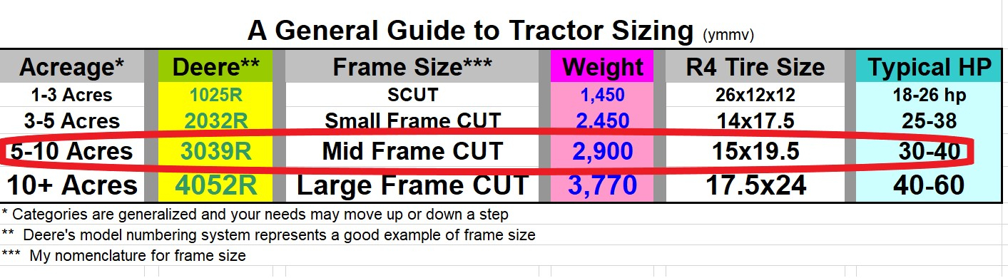

I agree with defining what you want to do with your tractor and implements you will be using first. Then determine the frame size that will do your tasks optimally. I am guessing a 35hp mid frame tractor about the size of a John Deere 3039R or 3032E (or same size Kioti, Kubota or LS) would do the trick. Go to a few dealers and do some test drives to get the feel of things - If you can find any dealers who have tractors in stock!
am I the only one thinking 30 to 40 hp is a lot of tractor for 5 to 10 acres ?
