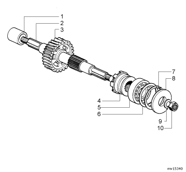

How do they turn? Are both wheels connected solidly through the axle, or is there a half-locking / free-wheeling device like on the rear hub of a bicycle?
My Czech mower is just too slow, so, I need another walk-behind, because my Goldoni doesn't have reversible handle-bars, so it can't be used for mowing or raking hay. A lot of the walk behinds with mower bars I see in Italy are like the BCS 720 without a differential, so I wonder how turning works on them.

So I'm going to avoid any that are definitely with a solid axle then. It seems one of the Goldoni's I'm looking at has some sort of unlocking device which I guess is to be used when turning. Probably best for me to just get another Goldoni, so I can easily swap rear implements. I have a bigger one with a powered trailer, and aside from not having the reversible handlebars, it is a nuisance to have to swap off handlebars and mount the steering wheel and trailer and all different bowden cables...
I need to call the seller of one to verify what system it has, because the Goldoni Mondial can have two different axles:
"AXLE WITH DIFFERENTIAL RELEASE "
"DEAD AXLE"
But this "dead axle" looks like it has a mechanism to disengage one wheel from the axle for turning...
