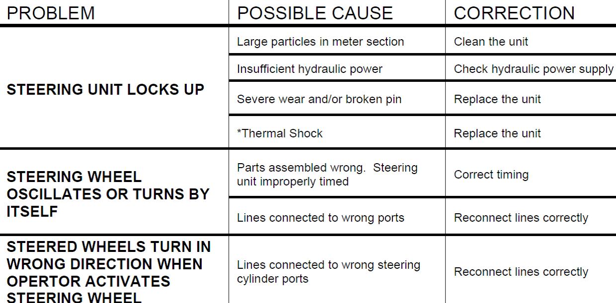

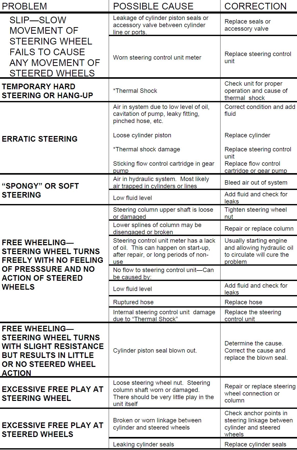

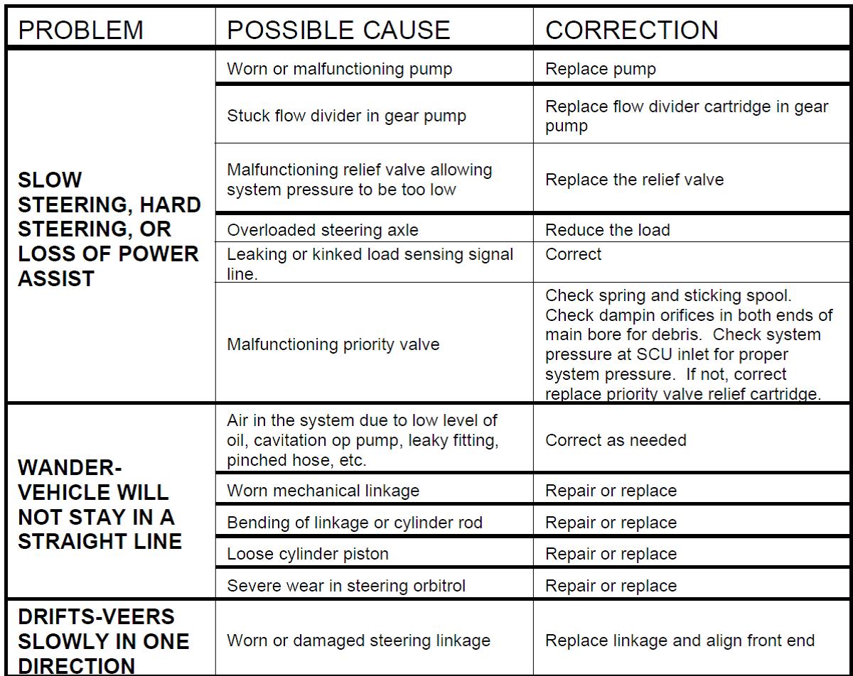

cstamm81, I questioned the hose(s) earlier but still have some doubt, esp if you've fully inspected them. (auto PS experience..) If either had ballooned/blocked there should be some pressure in one direction or the other(?) but if your cylinder moves freely unloaded I doubt it would be too high without being connected (weighted?) or at the end of stroke. It actuates by flow, of course, but some resistance may(?) help you interpret the tests.
Is there any reason S-box pressure output wouldn't be the same with the engine running or not, since the cylinder would be doing the same work either way to turn the wheels??? Whether the box is working would then only be obvious by effort/feedback at the wheel. Either you're getting 'boost' or not. If we can be sure the adapter plate is supplying adequate flow/pressure it would seem to point to the box as the problem. (Oh man, .. do I hope not ...)

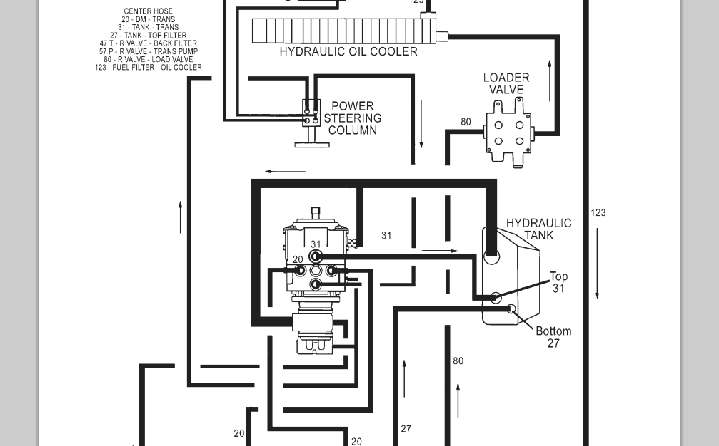

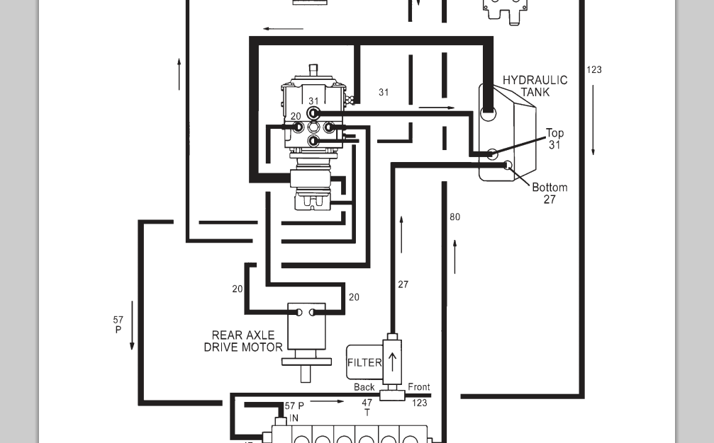

Not speaking for cstamm81, but the 'Main power circuit' flow chart is shown on p 2.12 of the man. IIRC its one that was attached earlier but T-M's site abruptly went offline within the last wk or so & I'm digging for the PDF I printed mine from, a few computers/HDs ago.:confused: This popped up recently but doesn't explain a web shutdown, tho' it may portend an update/redo of the site ....New Terramite Owner Has Plans to Revive and Grow the Small Equipment Manufacturer
There is a gear pump at the tail end of things, but the flow chart shows it powering only the loader valve and digging/outrigger spool stack. Up front there's a 'backplate assy' (w/piston pump? ... it's between the HST and that 'adapter plate') that routes to the drive's torque-motor alone. There's a dedicated line shown from the HST to the s-box. At first look it appears the HST is getting its charge pressure independent of steering flow or any shared source/connection.

Yep, looks like they are using charge pressure to power the steering

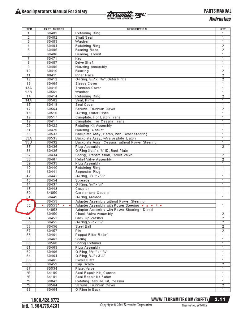

I spoke to TM today. The guy was quick to point the finger at the adapter plate, which is sandwiched between the hydrostat and the rear gear pump. He said I should have between 200 and 300 psi at the adapter plate port. It sounds like this is something that has been known to fail. It does not look too hard to remove, and I wondering if it is repairable. He did have the plate in stock at a little over $400. Pricy but if this will make the power steering work without any jury rigging it is probably worth it.
I am still surprised I have decent flow from that port, but I am going to get a short length of hose and tee in the gauge just to verify pressure. I guess the pump section of that adapter plate just got weak? I may even run a line off the loader valve to the steering box and just crack the valve to make sure the system works at that point.

Well, I believe wdchyd was right all along. I've got a whopping 20-40 psi at full throttle coming right off of the adapter plate port. SO, that is definitely the issue. I also ran a line from the front loader into the power steering just to make sure, and when I cracked the valve the steering as boosted.
So, I definitely need the adapter plate. Would anyone have a decent idea if there is something in there that is rebuildable? I am assuming there is some type of pump, impeller, rotors? TM wants 400 for the plate, and 1400 for the plate AND the hydro trans, whole assembly minus the rear pump.

I may have some used parts for that adapter plate.....I'll look 2moro at some used pumps kicking around.......you'd be into replacing the housing and geroler section if indeed the pump is worn
