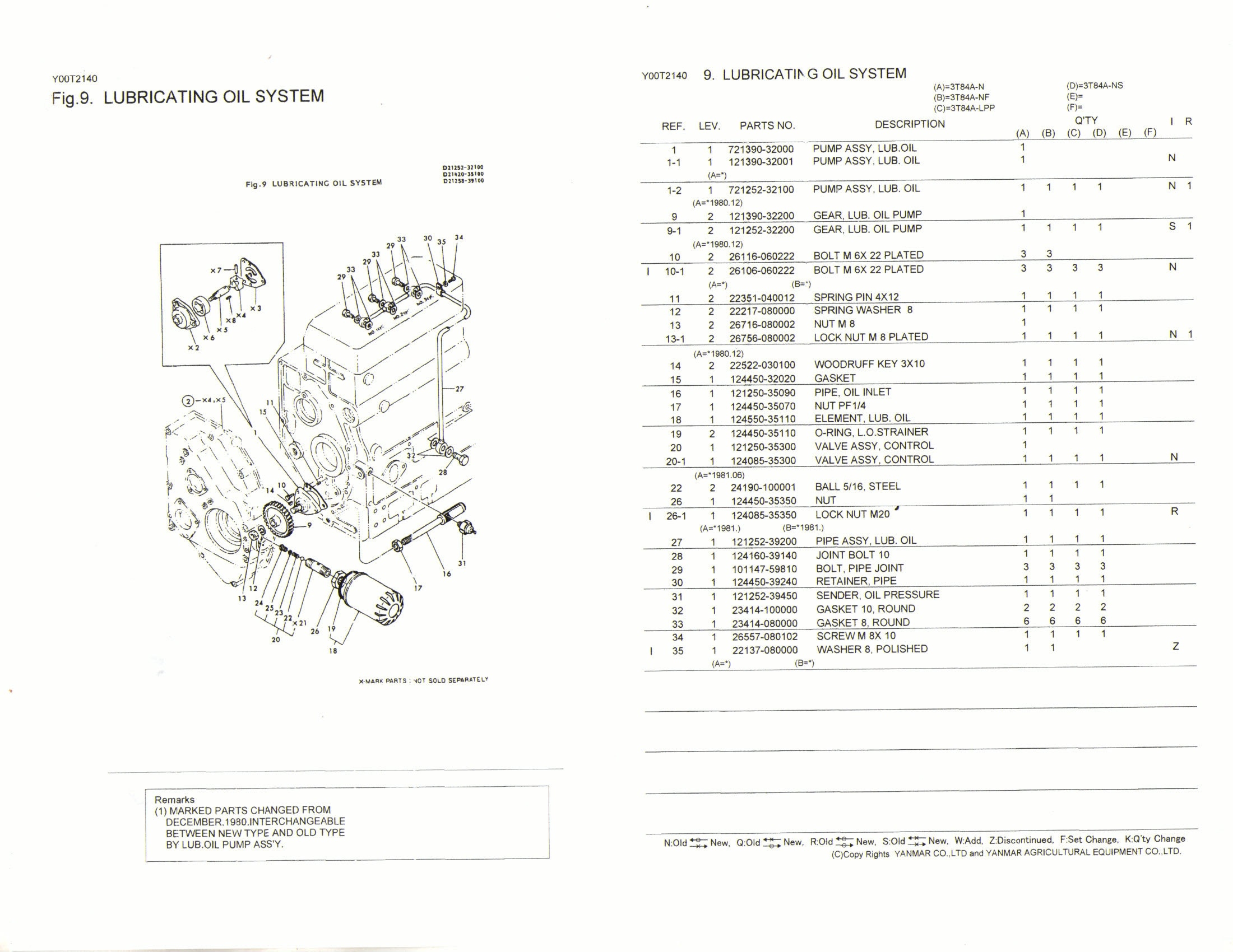

Yanmar ym3810d and 336d. I built one engine out of the two. New Rings and rod bearings new gaskets seals did valve job on head. Ive done probably a hundred different overhauls but never a 3 cylinder yanmar. My problem is no oil pressure. I'am hoping someone here may know what could cause this. After completing the overhaul I primed fuel system and it started right up and ran good. After starting I quickly looked at my oil gauge as I always do and no pressure. I checked gauge on something else and it works fine. I thought well maybe oil pump is bad since the other block had a rod through it and I was not sure which of the 2 oil pumps I put on the new motor. Took front cover off and put other oil pump on. Dropped pan and checked rod bearings just to make sure they hadn't been hurt and checked rod orientation thinking maybe I had them in backwards, grasping at straws. Only ran engine for a couple minutes. I went ahead and re lubed the bearings with engine assembly oil re torked and this is where I am now. Just don't see any reason to not have oil pressure. Any comments or suggestion is appreciated. Can the main bearings be installed wrong? Maybe block a oil passage.? I blew through oil holes on crank jornals. Everything seems open.
/ No oil pressure...Help... #2
here are the main components in your oil system. Maybe check them all out.

Thanks Winston, I have been over and over that page to no avail. Appreciate the thought...
